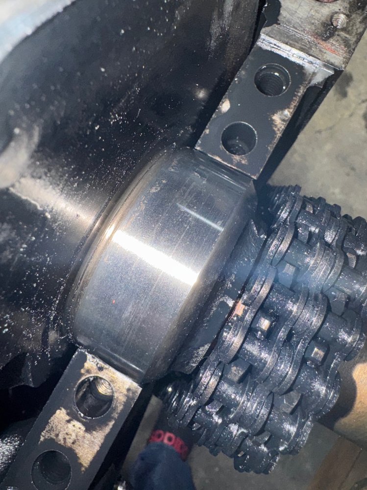

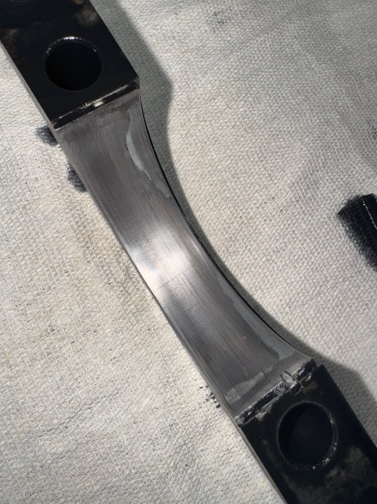

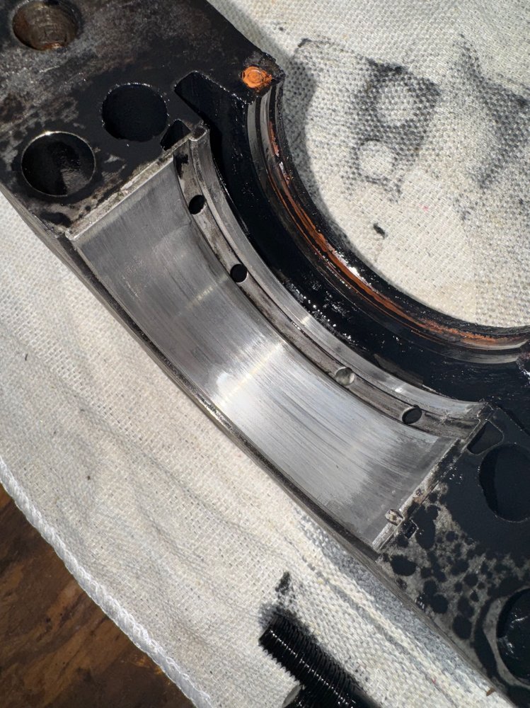

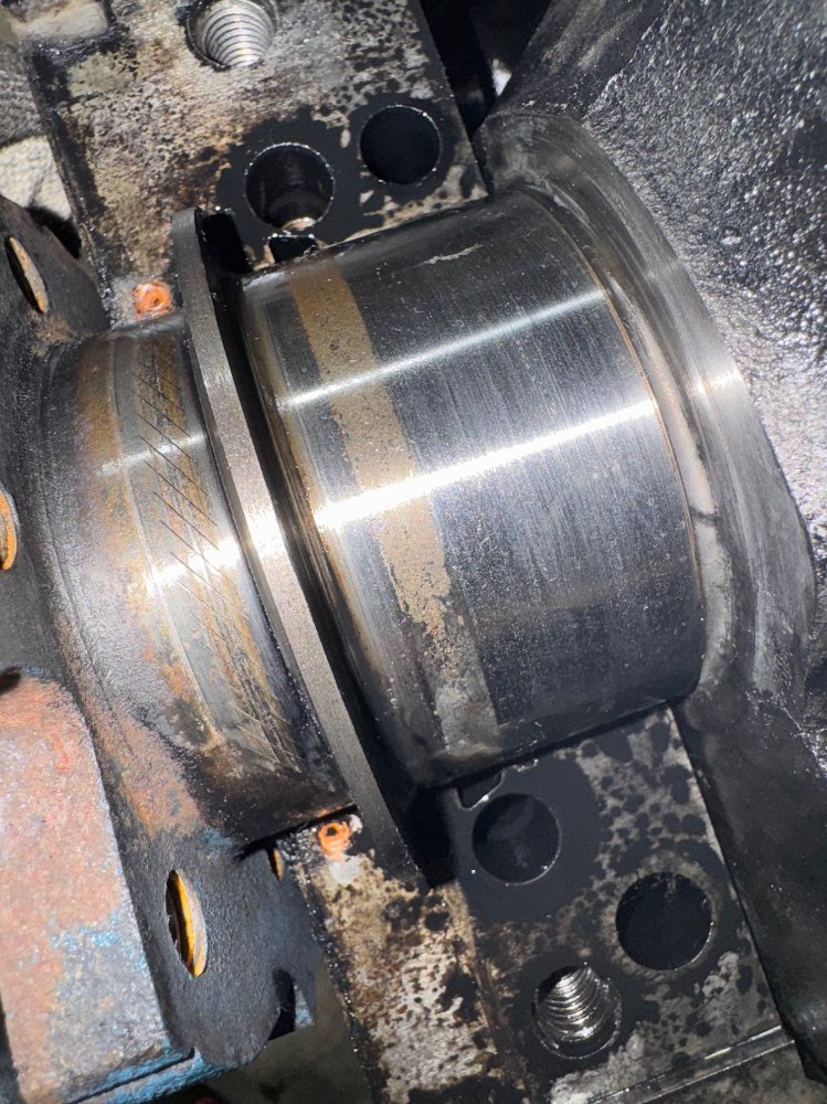

I wanted to get you guys some pics of the bearings. I have only pulled the rear main cap and the front main cap. wiped them down with a blue paper shop towel for the pics, then sprayed some wd-40 over the crank journal and caps since we have another heavy rain storm threatening to come tonight!
tell me what you think. on the rear main, it looks like there is some side wear, maybe it's just some discoloration, but it's not into the copper at all, the front cap looks good. I can see some lines in the bearing and crank journals more so on the rear, but I can't feel anything. there are also hash marks on the seal surface of the crank too.
