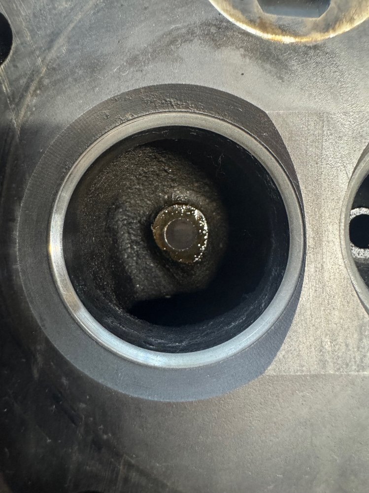

I might have to do that. I did make some progress on the one intake valve in the last photo. I used some of the jewelers rouge and a dab of oil and did a quick couple of passes. also did a leak test with the compressed air. it's only leaking on the side that's between the valves on the head. in the pic it polished up almost half way around leaving the area where I see it leaking.
I've only done maybe two sessions about 5 minutes each on this valve using the lapping compound (sessions were apply compound lap, wipe off and reapply compound. do it again)

I suspect that there not far from sealing all the way around, but I don't want to keep lapping if they are out of round or not perfectly straight. any advice on a poor man's valve job?
