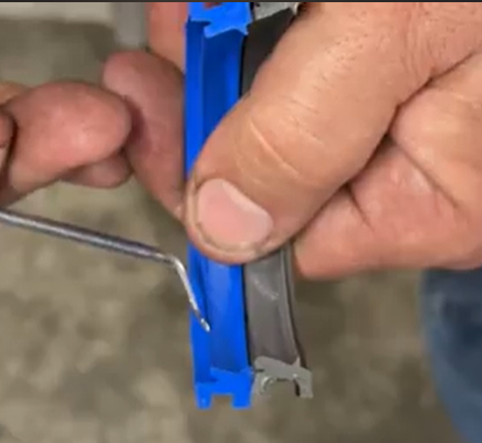

How does one offset it? not talking about the rotation of the seal, but the lip where it rides the crank. there is one that the lip is set back about 2mm for the gassers of this era. I didn't see one shown for the diesels.On the 2 piece you have to offset it yourself it's not one you buy.
Also if you have wear on the rear one check the front one it should be the worst
