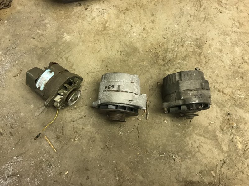

Thread starter #147

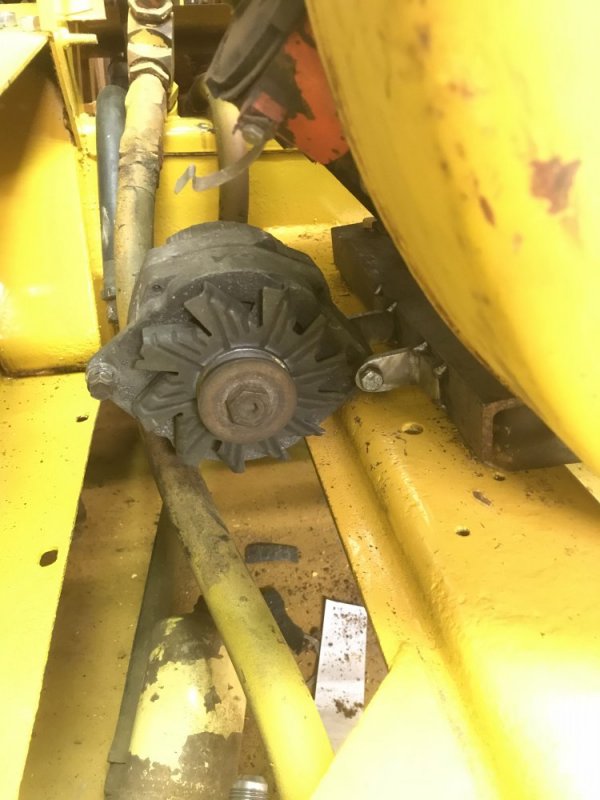

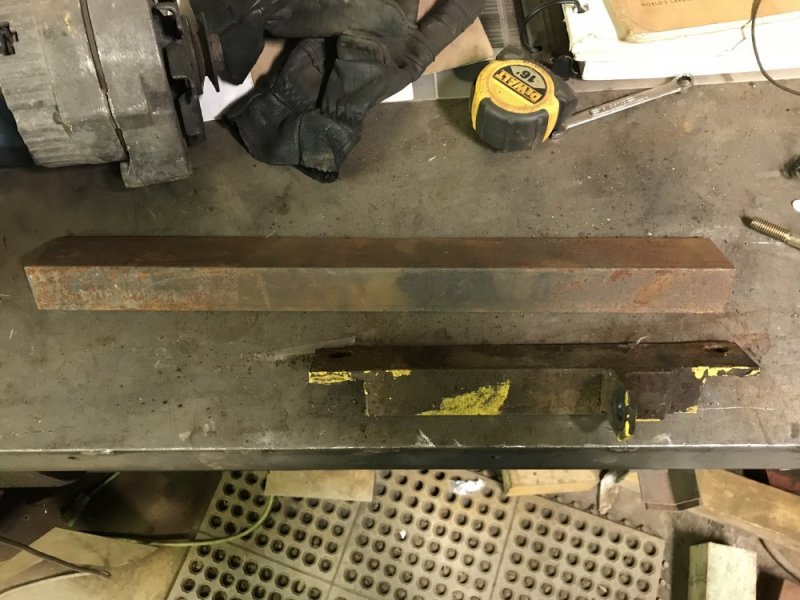

Testing, testing......one, two, three. I had three alternators tested today. First I had the L35 alternator tested at a local auto electrical shop during my lunch hour. It tested good and made 33 amps. After work, I grabbed the first 2 GM alternators I could find and went to Autozone. There, you have to go with an application so they can enter that into the testing machine:rolleyes: So I told them a 78 Chevy truck with a 63 amp alternator. Both of the alternators checked out “good”, but that tester doesn’t give an actual output. Ah well, good enough for the skid steer. So that’s the direction I’m going. I looked at the adapted alternator bracket that came with the machine and it’s going to need some work to make it fit right, so I think I’ll just start from scratch.....but not tonight - I have some kind of stomach thing going on. I guess I’ll flip through the Surplus Center catalog instead and see what nifty things I can run with all the extra power I’ll have :bookworm:..... 71F44354-DAFC-4940-9FBE-BA1CF08F38CB.jpeg 2071CD95-0A1C-46E3-9FA7-1EBE909F7C91.jpeg

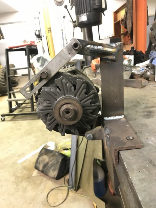

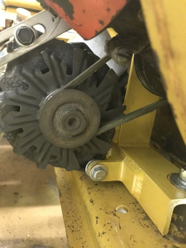

Thread starter #148

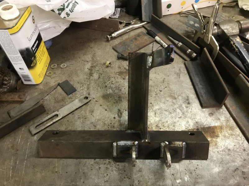

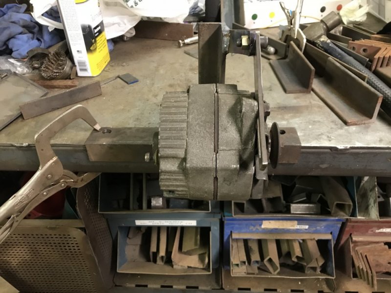

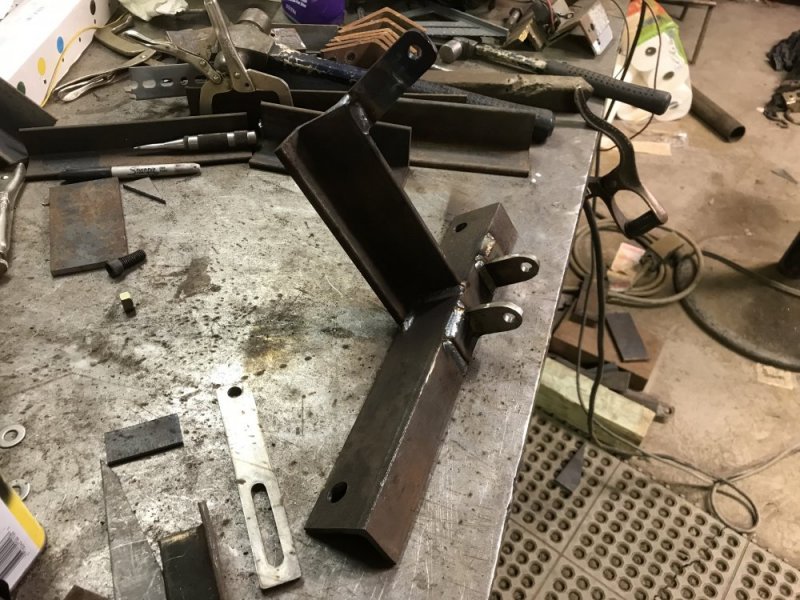

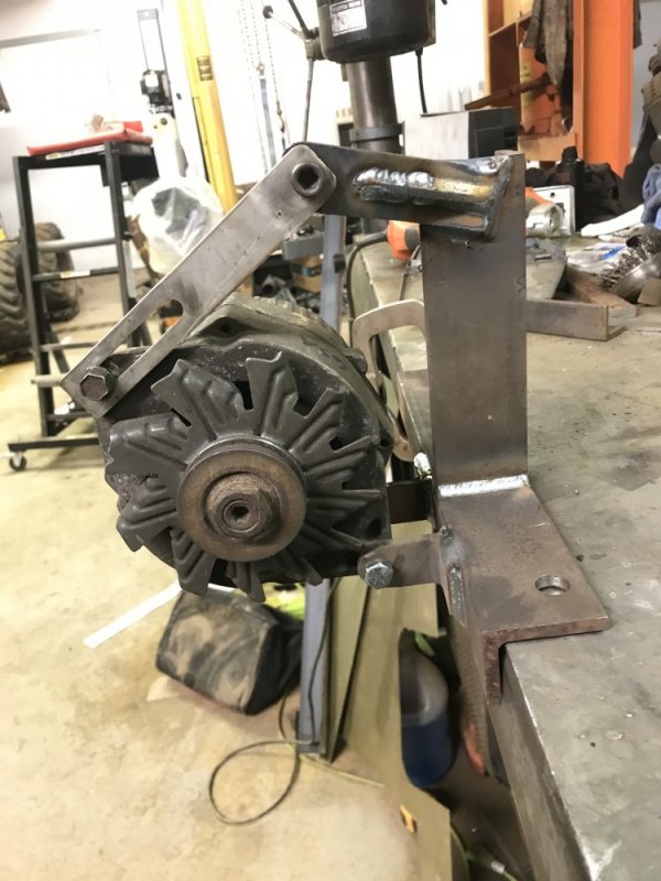

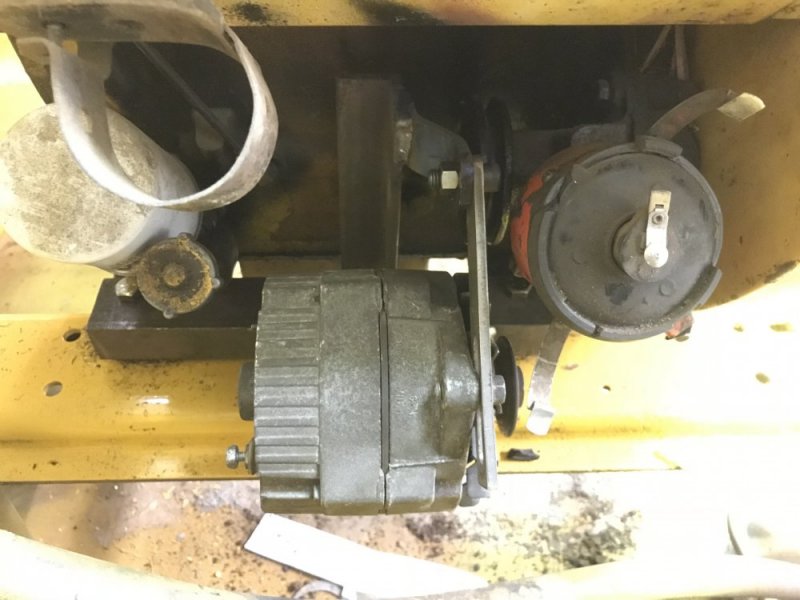

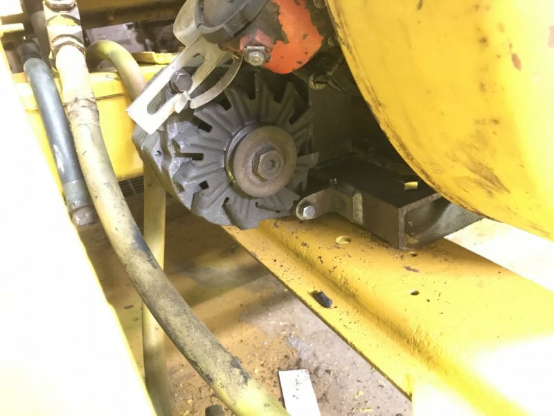

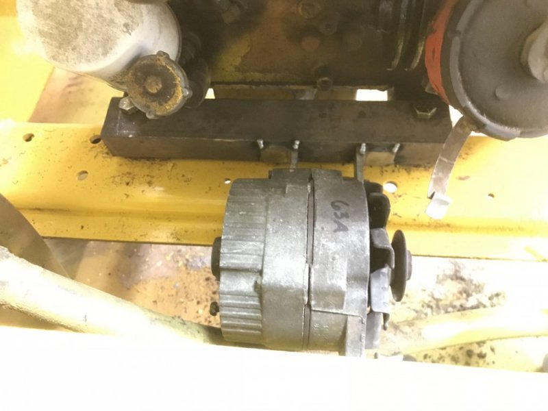

Started on the alternator bracket tonight. It’s a crude little affair made out of angle iron, but it should do the job. This is the easy part - the adjuster piece will be trickier because there aren’t any good mounting pounts above the alternator. There are a couple small bosses on the block behind the alt, but I’m not in love with that idea. I think I’m going to make a support that comes up vertically off of this brace behind the alt and then have an adjuster coming off of that. Oh yeah, before one of you eagle eyes points it out - yes there are gaps on wither side of the alternator boss......I purposely left it loose so I could dial in the pulley alignment using washers. F363BCBC-AF8E-43EB-9A0C-EED788060A55.jpeg A801D401-E688-4D94-99B3-D87F50FD0E4A.jpeg C78FA8A6-9514-4E33-9376-844C00DEAA1D.jpeg

I see the ground clamp on the table. Did you weld it up with the can of acetone sitting right beside it.
Eagle Eyes
Son of a B! I knew I was going to forget to take care of that. I really need to pick up after myself better. Will do tomorrow. Thanks for pointing that out, Jaryd.
