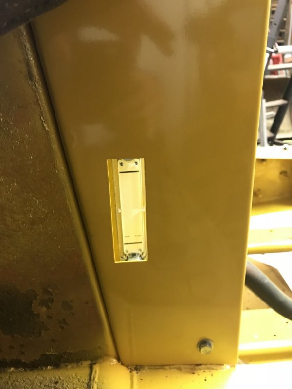

At work, the site glasses for the tanks I build have a temp gauge.
(Not saying it's better or worse, just an observation)
That would be a nice feature. I know there’s a pressure switch plumbed in the hydraulic system that turns on a light in an over-pressure situation, but I don’t remember if there was an over-temp switch. I’ll have to look. If not that would be a nice feature to add.

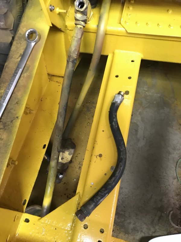

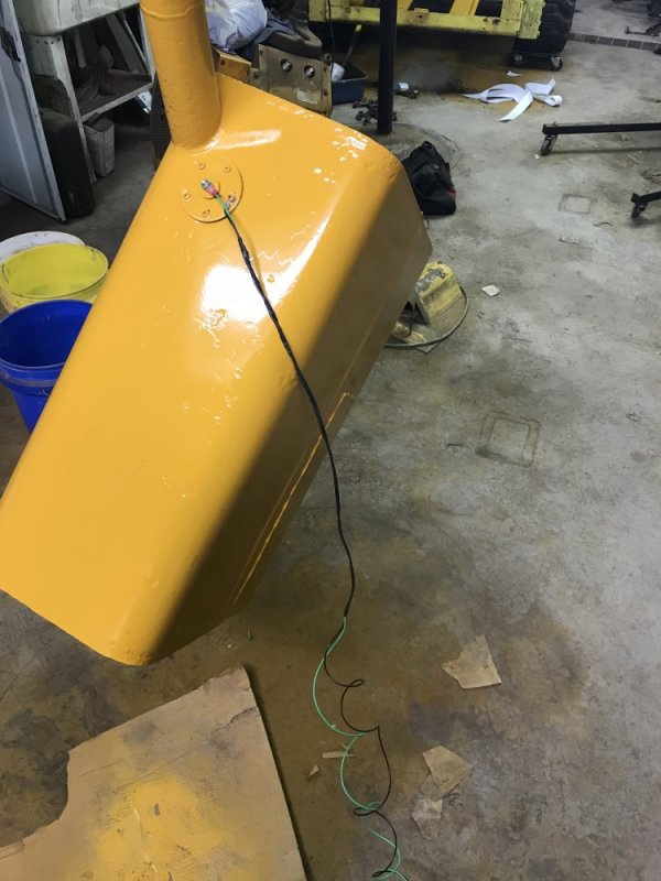

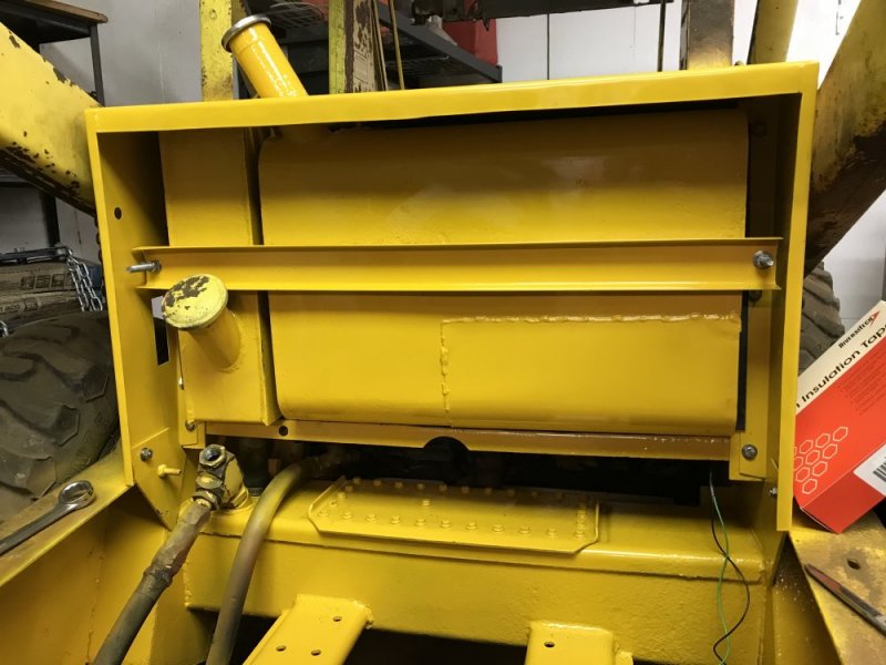

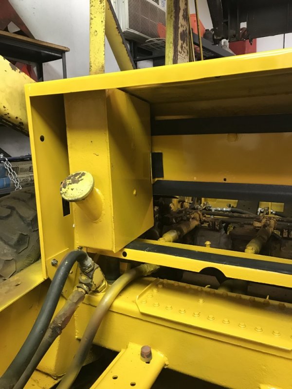

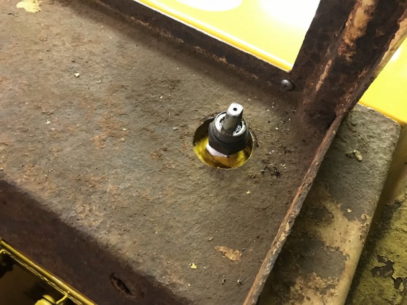

Most of tonight felt dumb, but the end result felt pretty good. To get the gas tank IN I had to take the hydraulic surge tank and bottom support OUT! And then, to get the surge tank back in, I had to remove a hydraulic hose with rusty fittings! I think I made part of this problem myself because when I took it apart originally the gas tank came out first and then the surge tank after that. So I was just reversin the order for install. It looks like I made the hole for the gas tank filler neck smaller than what it was before so that seems to be the problem. Ah well, it’s together now.
036FB7E5-A094-49C3-B99B-9677CC2A183B.jpeg 256AB789-B58E-4D9B-A296-80C3599CE113.jpeg 3E8424A6-84C0-4402-89A1-95659CA98A0B.jpeg

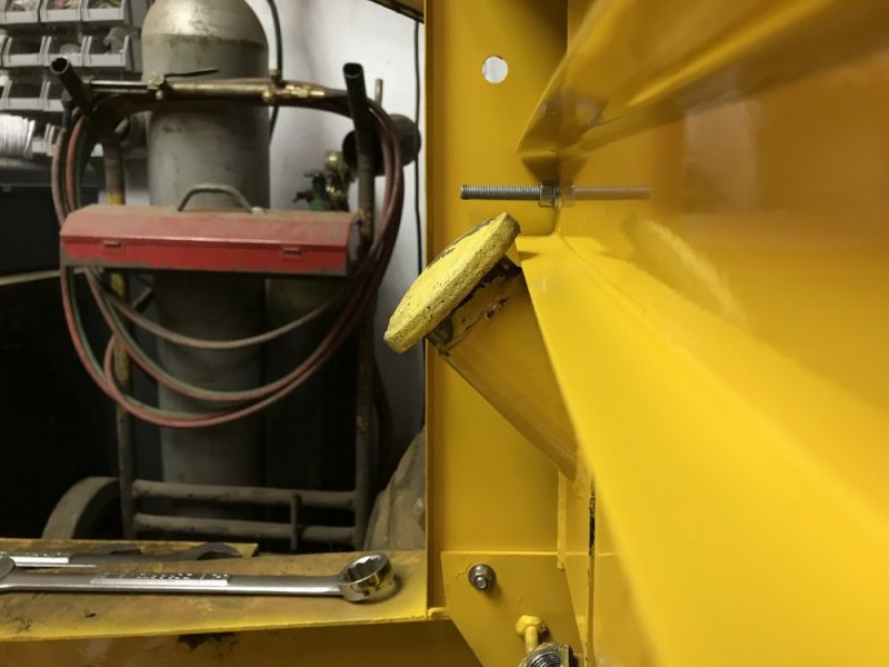

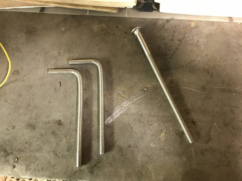

Then I made the J bolts for the retaining brace. I made them by cutting and bending some 3/8” stainless carriage bolts. Lots of anti-seize got used on these to keep the nuts from galling (I HATE when my nuts get galled!!).

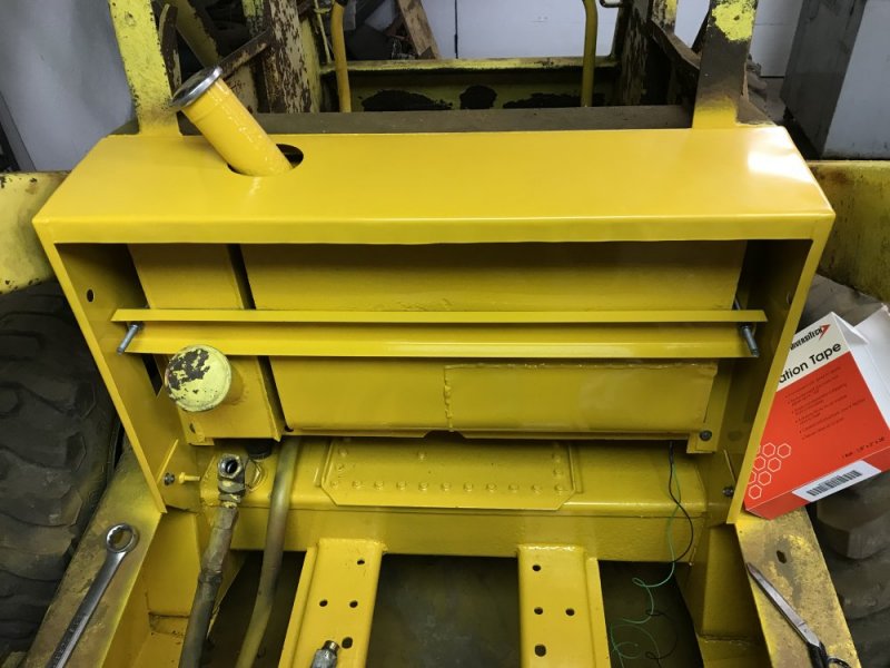

So.....it looks like I made a false statement a few posts back. Remember when I said it didn’t matter if the channel for the retainer was a little taller? Wrong. The surge tank cap is going to collide with the heat shield when I instal that. I may be able to get away with a smaller fill cap, but I’ll probably also have to put a dent in the heat shield. Oh well, it’ll do.
That is going to be one fine little machine when it is finished.
Be sure that the fuel filler neck is not rubbing on the cover, could wear a hole through it.
