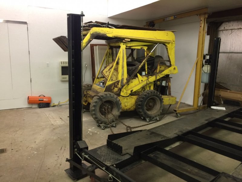

Fast forward to this winter.....I need to do a new retaining wall next to our driveway and the skid steer would obviously be super handy for that job. I also finished up some remodeling in the barn so I finally had the space to take the project on again. So I dug it out of its hole and I am now resuming progress on this project. So far I've pressure washed it and started reviewing what the project needs again. It needs some work....oh yeah, it needs work. There isn't a visible serial number anywhere (I think the tag rusted off), but based on features it has or doesn't have I was able to narrow the serial number down to somewhere between 229,000 and 465,000. They made these between 1971 and 1980, but I have no idea where that number would fall in, but needless to say it must be in the 1970s sometime.....and it looks every bit its age.

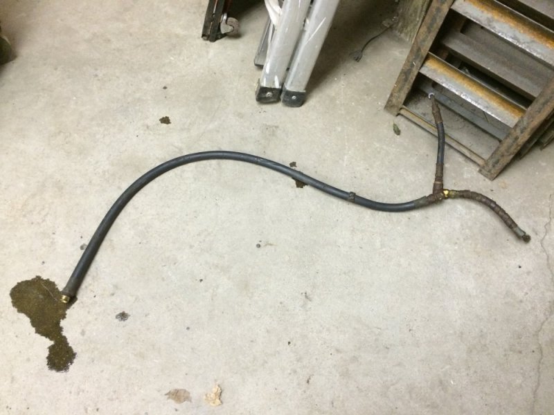

So when I looked at the unit, the guy showed me all of the hydraulics worked since it had a running engine in it at that time.....in fact, it worked so well that it blew a hydraulic hose while tilting the bucket! So yeah, it needs one hose...and now that I'm looking at it much closer and degreased I'm seeing it needs a lot more hoses and lines. So that will be a lot of the initial work that will need to be done to get it running again, but there are other general fixes and rust repairs needing to be done, so as I do those I will document them here. It could get ugly, but hey, what's the fun in a project going smoothly?? :D

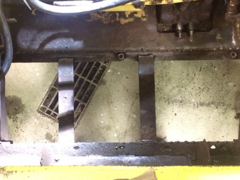

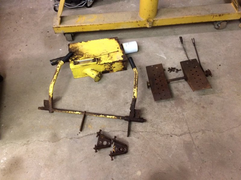

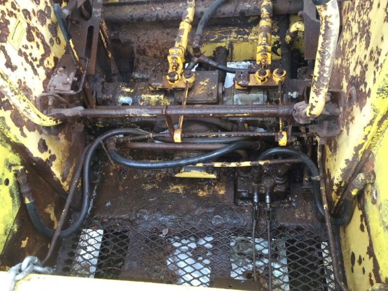

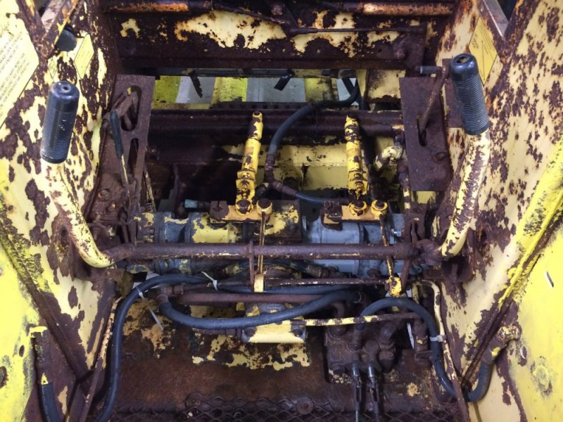

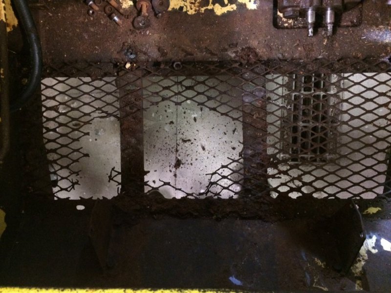

Just a little progress tonight. I removed the pedal assembly so I could fix the rotted-out expanded metal floor pan. I also removed the control handles so I can rework the rusty one and get them operating smoothly again. That other thing in the picture is the previously removed hydraulic oil reservoir. 2017-01-12 1.JPG 2017-01-12 2.jpg

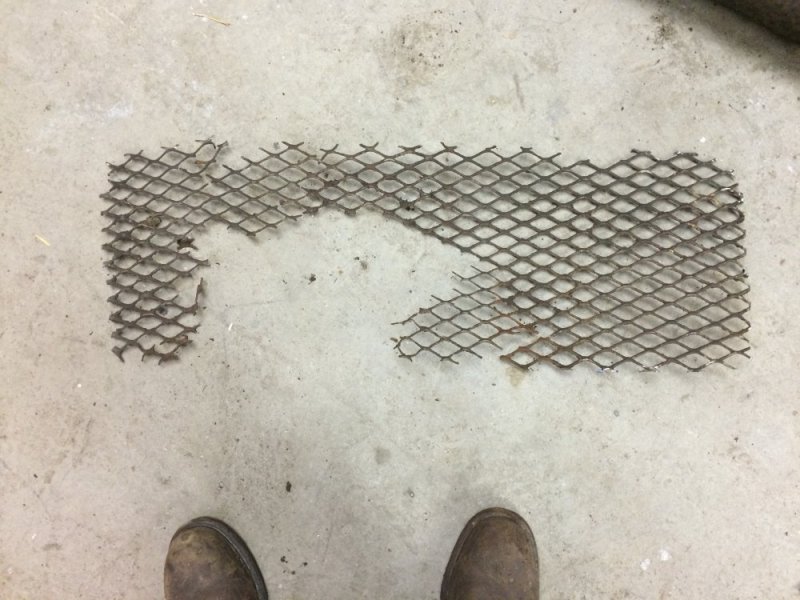

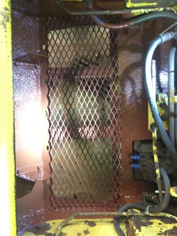

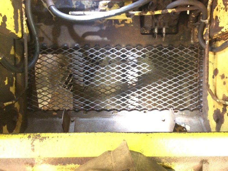

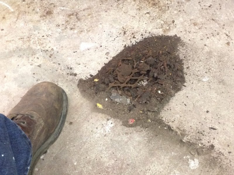

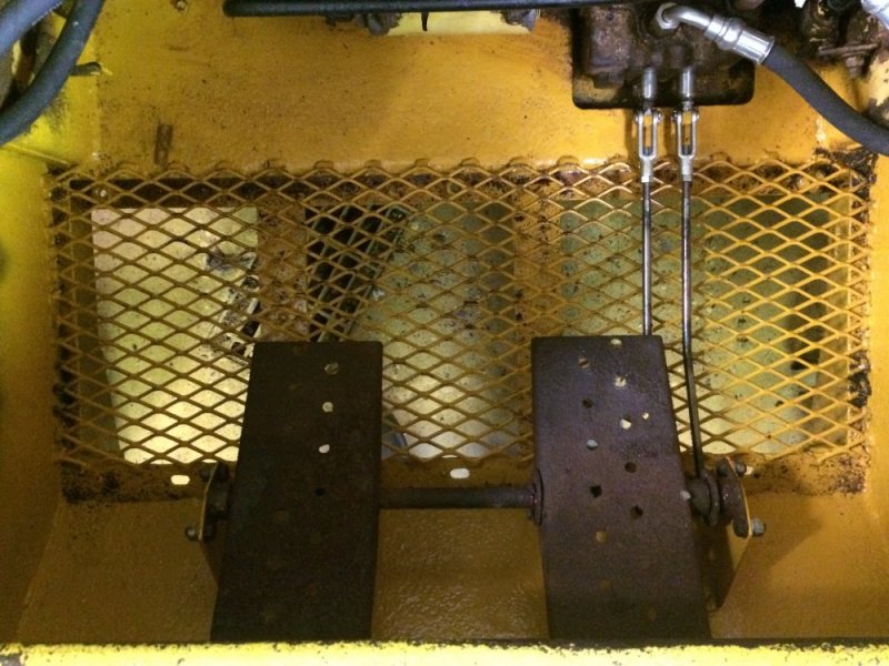

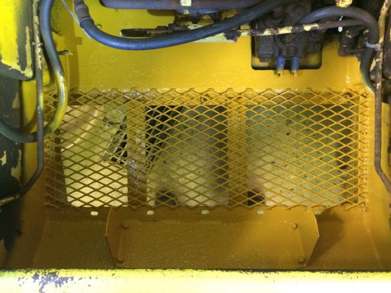

A little more progress today. I got what was left of the old expanded metal floor cut out and a new piece welded in. I also got a coat of primer on it. I was hoping to do some more today but with all the heater, degreaser, cleaner, welder and paint fumes I had to call it a day. It's funny, even after multiple cleaning sessions I still manage to get tons of dirt and grime off the thing when I get to working on it. I had another pile on the floor after I cut the floor out. It's the gift that keeps on giving!

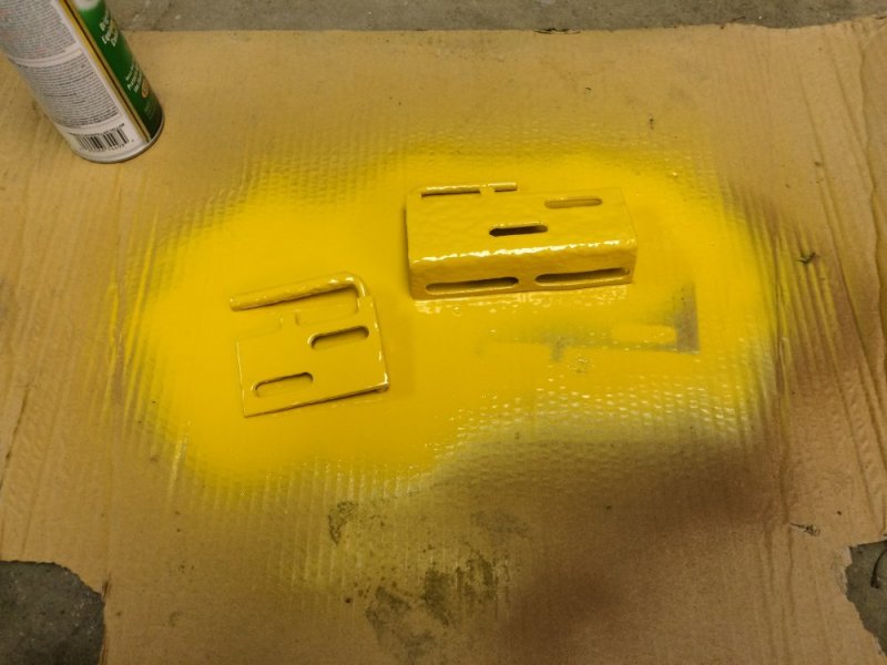

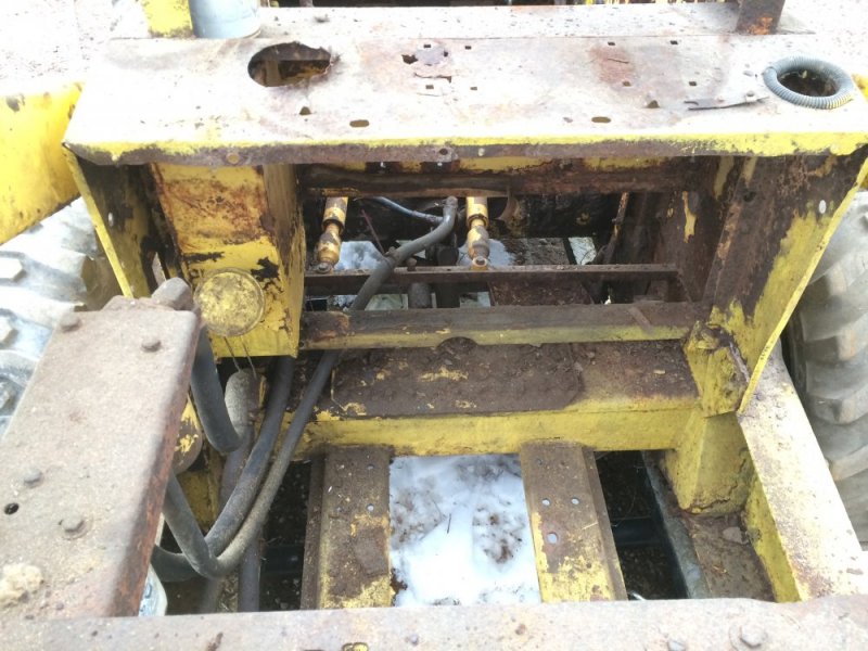

Today I got the new floor painted, the hydraulic reservoir wire wheeled and painted, the Hi/Lo speed detent bracket wire wheeled and painted and started fixing a botched patch job on one of the drive levers. I also started taking a couple hoses off so I can start having new ones made. It's starting to feel a little bit like progress, but I still have a long way to go.
IMG_7424.JPG IMG_7422.JPG IMG_7423.JPG IMG_7425.JPG IMG_7426.JPG IMG_7427.JPG

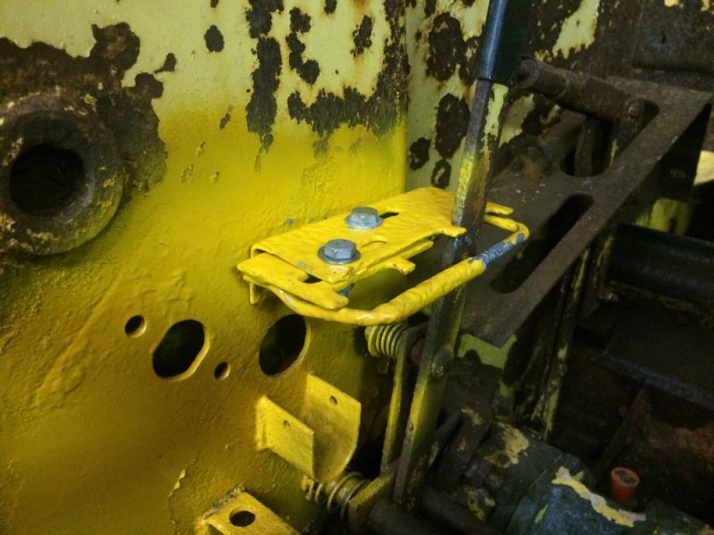

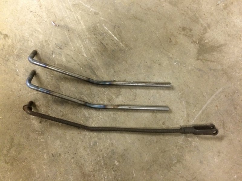

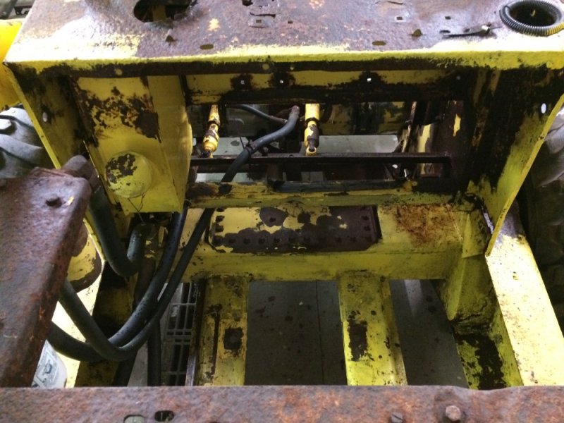

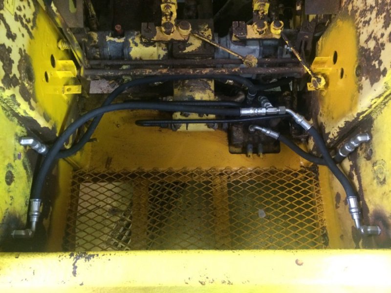

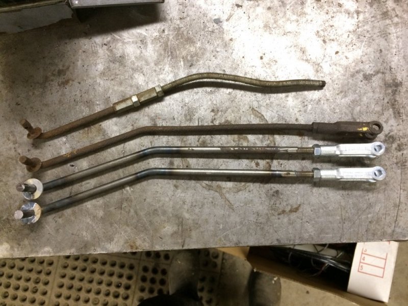

Between prepping the Tahoe for the dyno and getting a nice stomach bug, I haven't had a chance to make any progress on the NH over the last couple weeks. I had an hour to spare today so I did a couple things. I finally installed the new hoses I had made. You can also see in the pic how I painted a couple steel lines with Rust Encapsulator. I also reinstalled the speed selector detent bracket after it had been cleaned and painted. The final thing I did was start to make new control pedal linkages. It feels good to make some progress once again. IMG_7524.JPGIMG_7525.JPGIMG_7528.JPG

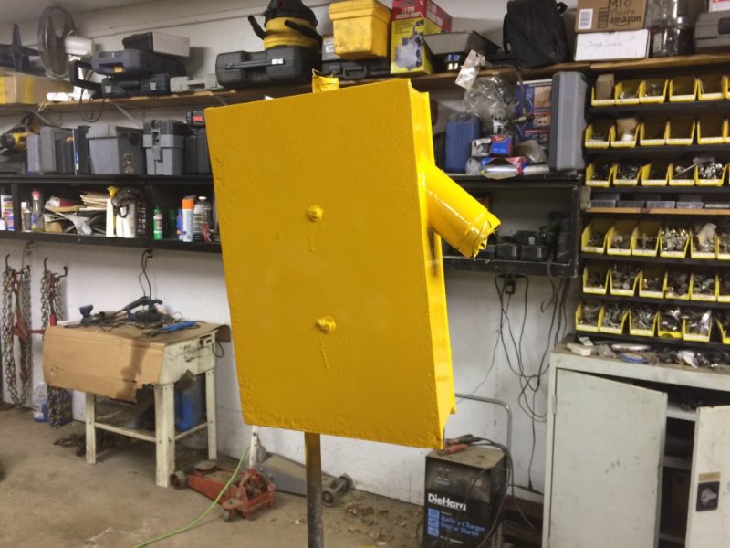

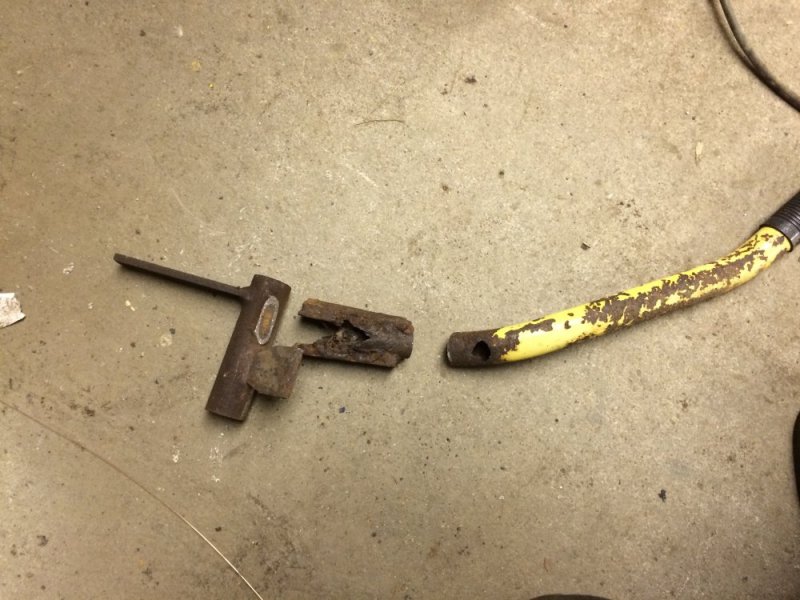

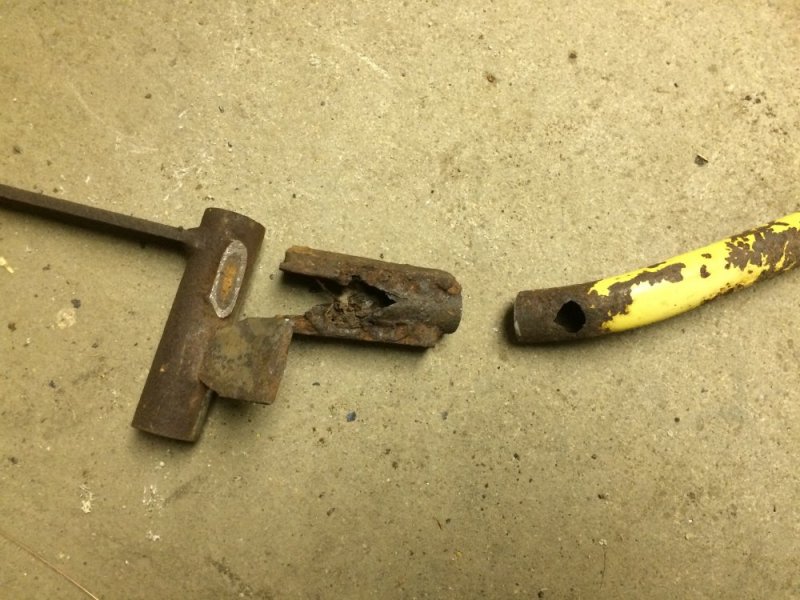

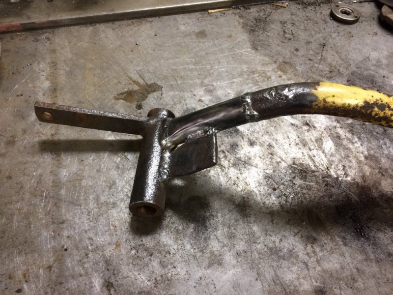

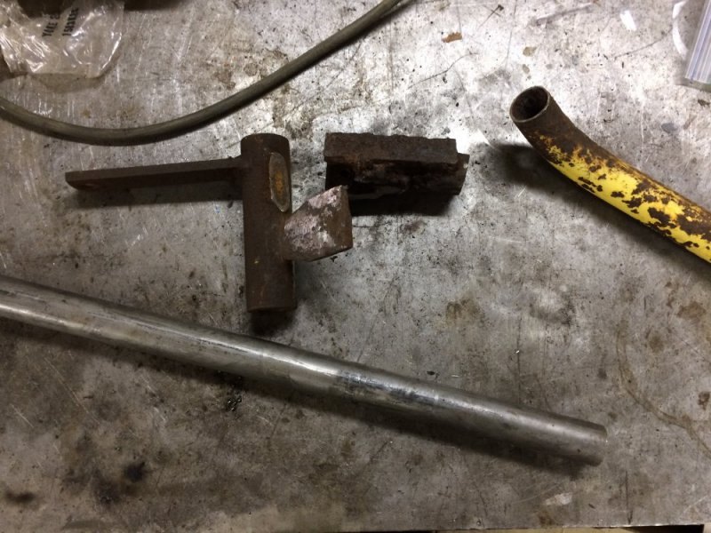

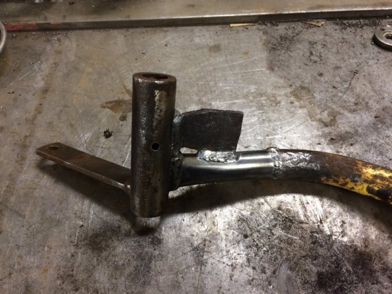

Another hackjob repair tonight. Stock one of the drive control handles had a horn button in it. So at the bottom there was a hole for the wires to feed through. Lots of crud must have collected in that hole over time and caused the handle to rust. Someone did a nasty fix so I had to address that. It took some trial and error, but the end result turned out pretty well. A little wire wheel work on the other handle and then some paint. Oh and yes there's some porosity in one of the welds because I didn't clean it before welding.....but there wasn't a weld there from the factory so it's still better than it was new.
