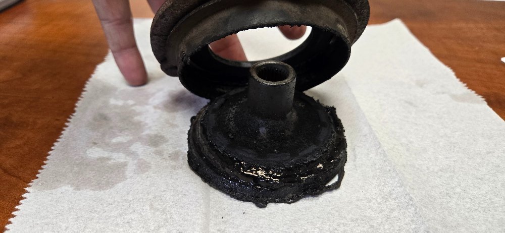

Decided to drive the Yukon to work again, not issues arise from the burning brake smell. When I get to work I notice a little different sound under the hood. Pop the hood to find the culprit of the stank and I believe noise:
I am assuming a clutch failure happened last night on the AC compressor, the smell seems to be burning rubber. I was using the AC last night as it was in the 80s with high humidity. I did not use the AC this morning on my way to work. So this compressor was replaced when I first bought the vehicle to get the AC working again, not sure what brand it is.
I guess the plan for now is to pull the belt and clutch and inspect the bearings and compressor to make sure it didnt sieze up. Trying to YouTube educate myself. I hope its just a clutch replacement. Anyone had this happen?
That looks indictive of the compressor locking up and melting the clutch. you might need to put a new belt on the parts list with that!

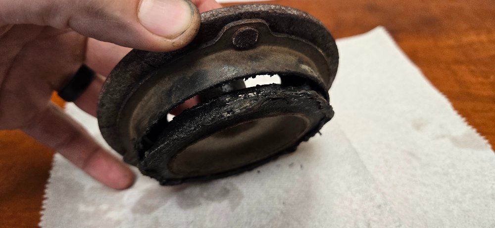

So the compressor is not siezed. I got the clutch off, threaded the bolt back in and the shaft spins with minimal effort. Nothing feels out of the ordinary. The pulley bearing feels "ok". Not as smooth as I would like, but not something I would say is bad right now. Not sure if any of the schmeg from the failure may have got in there, needs further disassembly to determine. But the freewheeling of the pulley (not connected to the clutch plate or pump drive) seems to work.
What I see is a rubber isolator failure. My thought is the rubber deteriorated, and lost is ability to remain in connection with the outer clutch plate and while engaged sliped between the two and burnt up the rubber.
I guess I am trying to comprehend what would happen if the compressor siezed? If it did this outer plate would be locked in with it and nothing would spin. The outer pulley would free wheel. The minute it engaged by solenoid the clutch and pulley assembly would now be stationary, and burn the serpentine belt up. My serpentine belt is in perfect condition. No marks whatsoever. I guess if the pump did sieze last night, and unsieze by the time I did my test today, would this isolator fail before burning up the serpentine? I personally dont think so.
