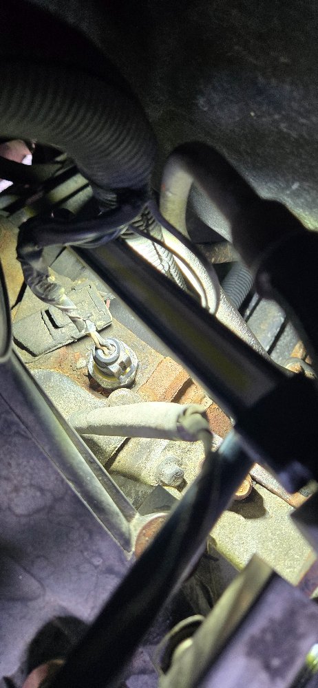

Im at 5k on my synthetic 5w-30, so I am going to change it tomorrow. I am also going to swap out the pressure sensor with the one from the 1/2-parts truck to see if that changes anything.

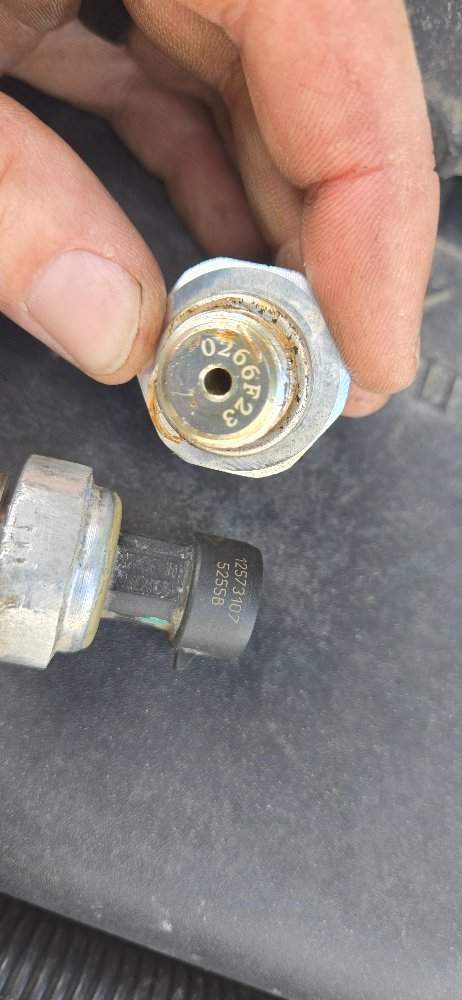

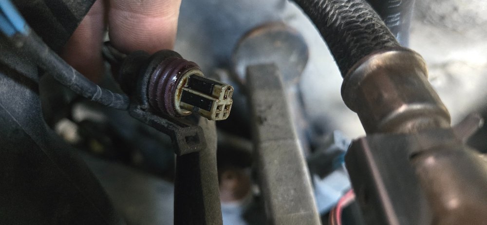

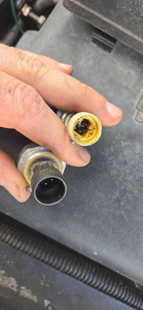

The plug is wet, so oil is passing through the sensor.
Also found out its not OEM (white connector and engraved jungle store part number)! The one on my parts truck looks to be OEM (black connector)
