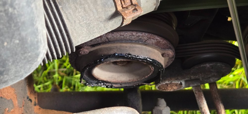

Decided to drive the Yukon to work again, not issues arise from the burning brake smell. When I get to work I notice a little different sound under the hood. Pop the hood to find the culprit of the stank and I believe noise:
I am assuming a clutch failure happened last night on the AC compressor, the smell seems to be burning rubber. I was using the AC last night as it was in the 80s with high humidity. I did not use the AC this morning on my way to work. So this compressor was replaced when I first bought the vehicle to get the AC working again, not sure what brand it is.
I guess the plan for now is to pull the belt and clutch and inspect the bearings and compressor to make sure it didnt sieze up. Trying to YouTube educate myself. I hope its just a clutch replacement. Anyone had this happen?
