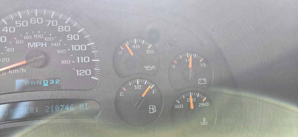

I re-connected the ground on my e-fan override system (normally just use in the winter with the plow, but it triggers a CEL) and it performed much better in terms of coolant temp and trans temp, but the power just isnt there on the hill. 2nd gear, 4k rpms and about 45 MPH on the hill. Just north of 210.4K miles today.
Been noticing my oil pressure going down again over the last few months. Normal hot idle used to be 30 to 40-PSI. Today we were below 20 at hot idle.
Im at 5k on my synthetic 5w-30, so I am going to change it tomorrow. I am also going to swap out the pressure sensor with the one from the 1/2-parts truck to see if that changes anything.
Per my understanding, 10-PSI per 1k-revs is sufficient. So technically I am still fine, but noticing the change has me wondering.
