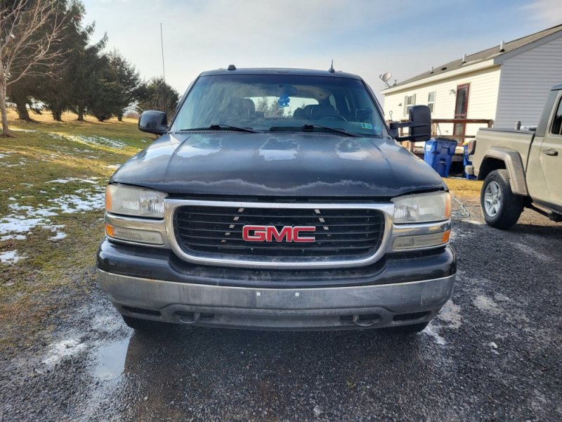

Welp I ended up stumbling on this 2005 Yukon XL in SLT trim for peanuts off a young kid who used it for his transport business. With the rising duel costs he was selling to purchase a smaller van. I jumped quickly into action to get this thing ready for my trip to TN.
The day I picked it up and brought it home:

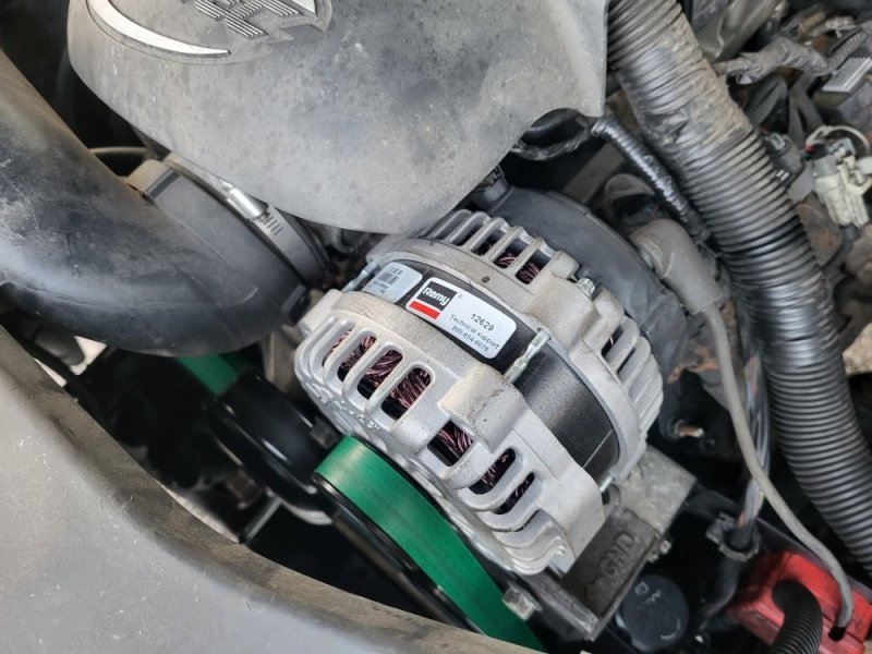

Started replacing a whole slew of parts for piece of mind and preference:

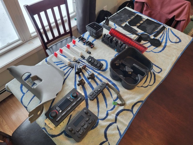

A little junkyard run for some backup pieces.

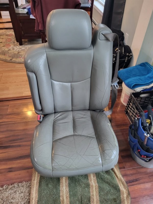

A seat that's in better shape than mine for $30!
Remy 160 amp alternator.

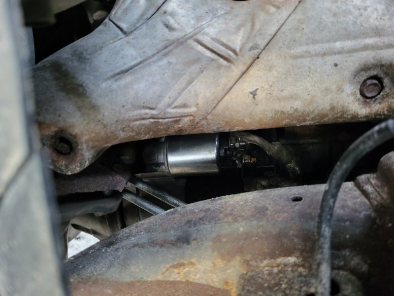

New starter.

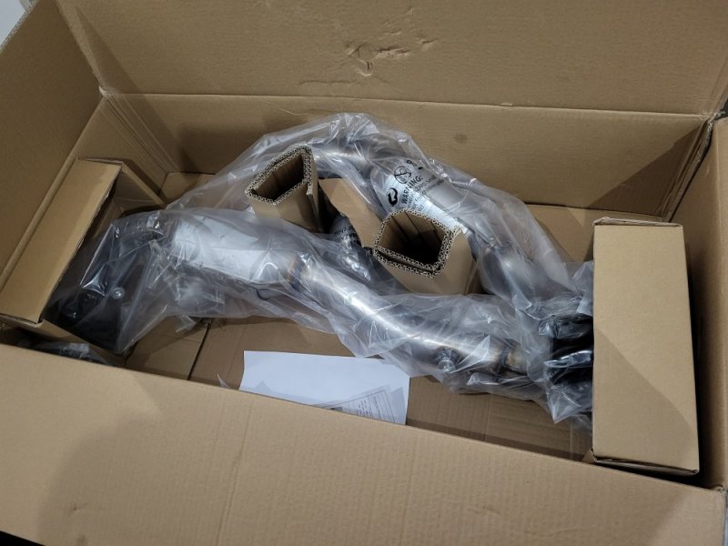

3rd round of parts included new converters due to PO420 recurring.

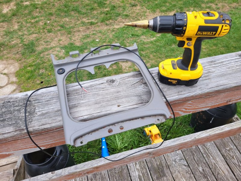

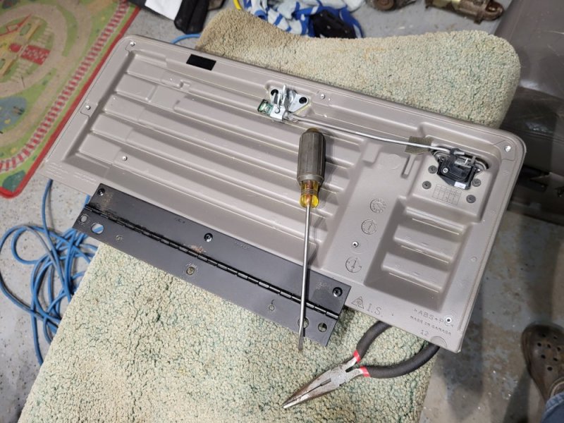

Fixing of the annoying rattling glove box handle (drilled out the rivets and replaced the basket with my correct vin matched build sheet!

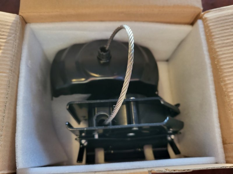

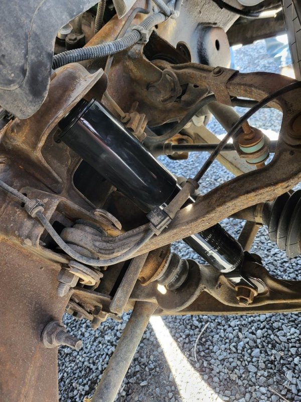

New front shocks and lower bushings

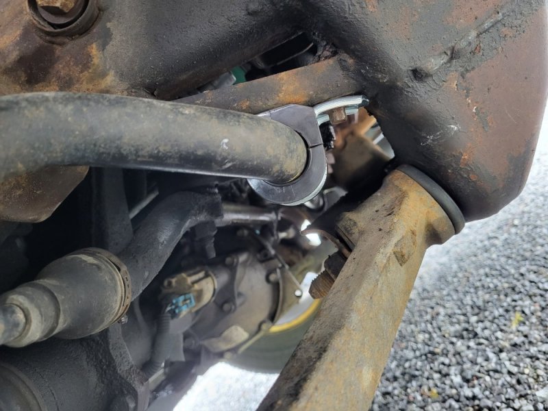

To date I have put almost 6K miles on it, working on some small clunks that I still haven't fully solved. It is now fully aligned with lifetime alignment as well as new rear sway bar end links and all new sway bar bushings. Next big focus is A-Arm bushings.

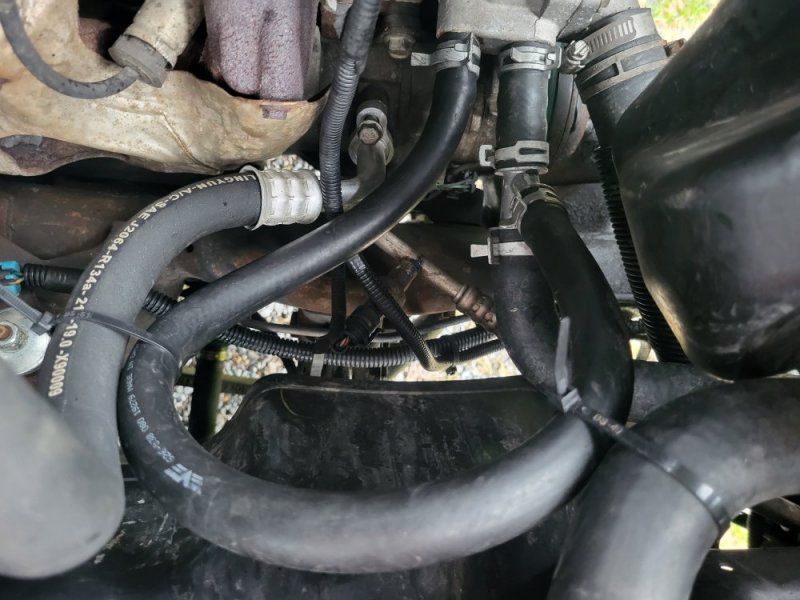

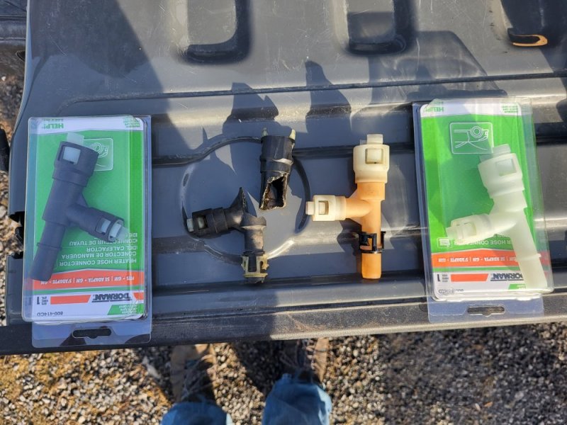

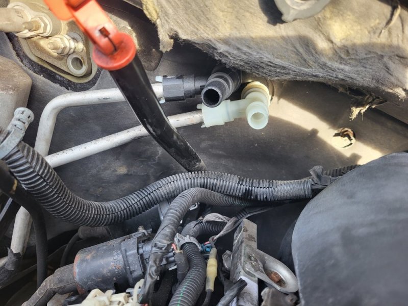

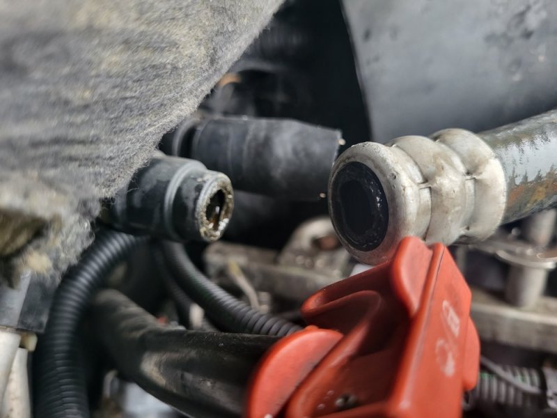

Had my first failure stranding me (only for 15 minutes). Blown heater hose at the crimp.
As you can see in the background above I cut the other heater hose off (it was being a PITA) and looped it back to the water pump. Been driving it like this for the last few days haha. All new quick connects and hoses are ordered and should be here tomorrow.

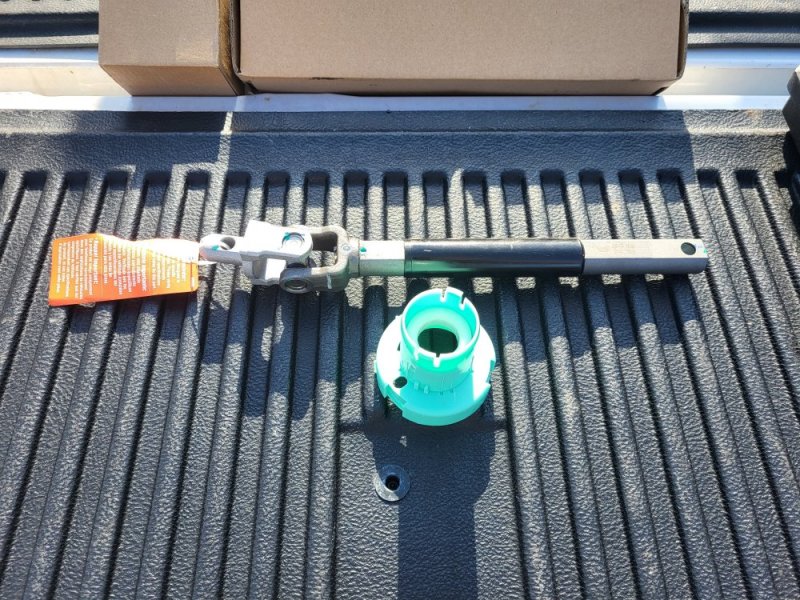

No more steering rattle.
Can you give us more info on this part/fix? Aftermarket was the fix in the past for GM's sloppy clunky feeling part.

I went all in and replaced the intermediate shaft as well as the plastic bearing since I was getting this involved. The shaft I purchased was a Dorman unit from Amazon. I also purchased a plastic bearing bearing that was purchased new as it felt like garbage (notchy as hell) and Dorman part numbered, however not actually a Dorman made! I ended up returning and getting the new AC Delco from RA. Once both old parts were removed the slop was definitely coming from the plastic bearing, I think the intermediate shaft was fine. The new one is a chore to get in......

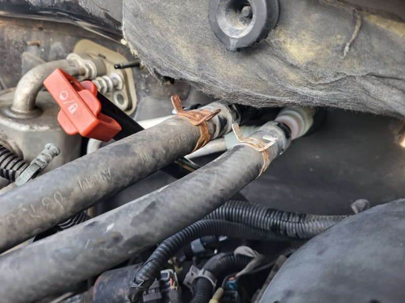

Man I hated those T fittings on mine.
I got some brass T fittings and used them. The factory ones are ok, but just plan out changing them at 15 year/150, 000 mile intervals.
Also change your a/c compressor BEFORE it goes. A couple hundred when you plan it out or over a grand if you wait. I learned those are best every 100,000 miles.
I let mine soak overnight with acetone/ATF mix and they came right out where at first they wouldn't budge

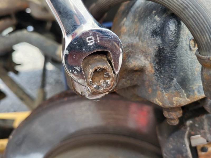

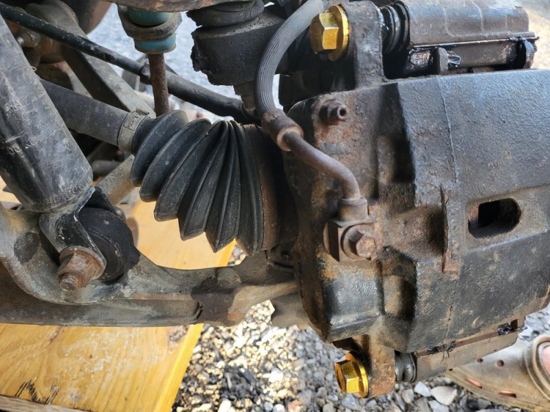

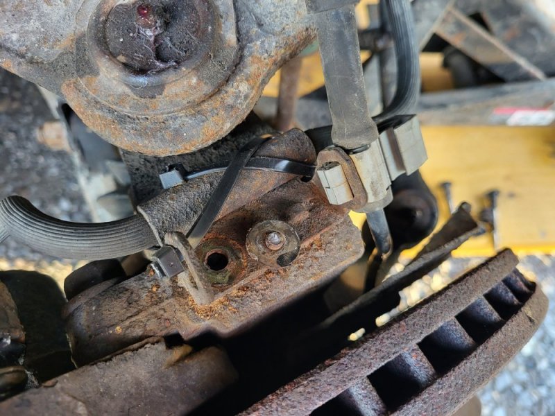

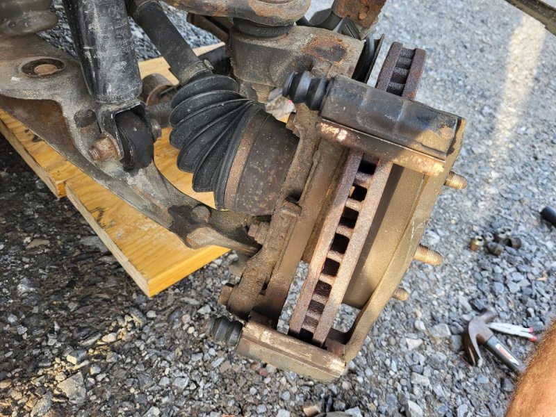

I actually took this apart a couple weeks ago and realized I didn't have the correct 55 torx bit (my kit stopped at 50). I also realized that the one in the pic was bunged real good so I knew a battle was foreseeable. I just rotated tires, changed the oil and put it back together. Last night was take 2. Knowing the stripped nature I didn't want to take a chance with penetrant on the torx portion to make it slip more. The torx bit did end up slipping right out, I am gonna guess the last person who worked on it took it apart just as I originally did so they didn't have to mess with that ugly bolt. The pads were darn near new.
Gonna need to come up with a game plan for the broken knuckle bolt now. I cobbled 2-sip ties in an x fashion for now but it will need drilling, a helicoil or tapping to the next size bigger. Crap....
