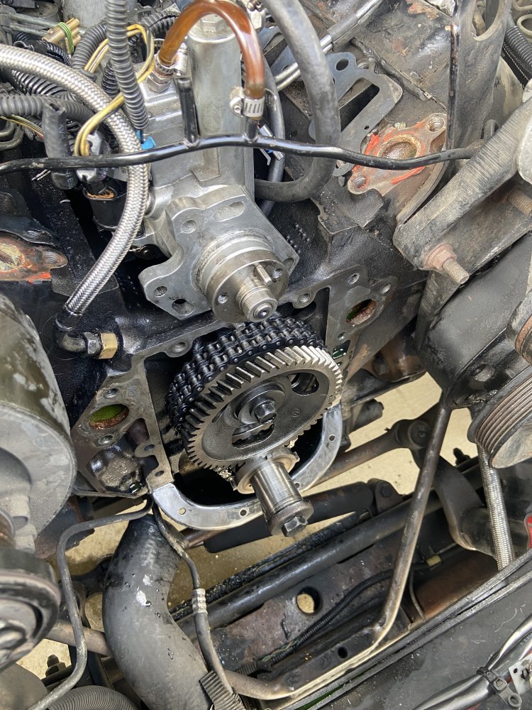

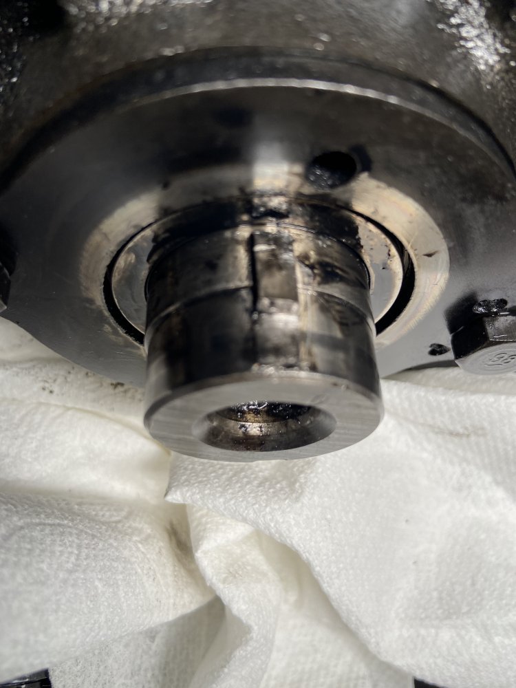

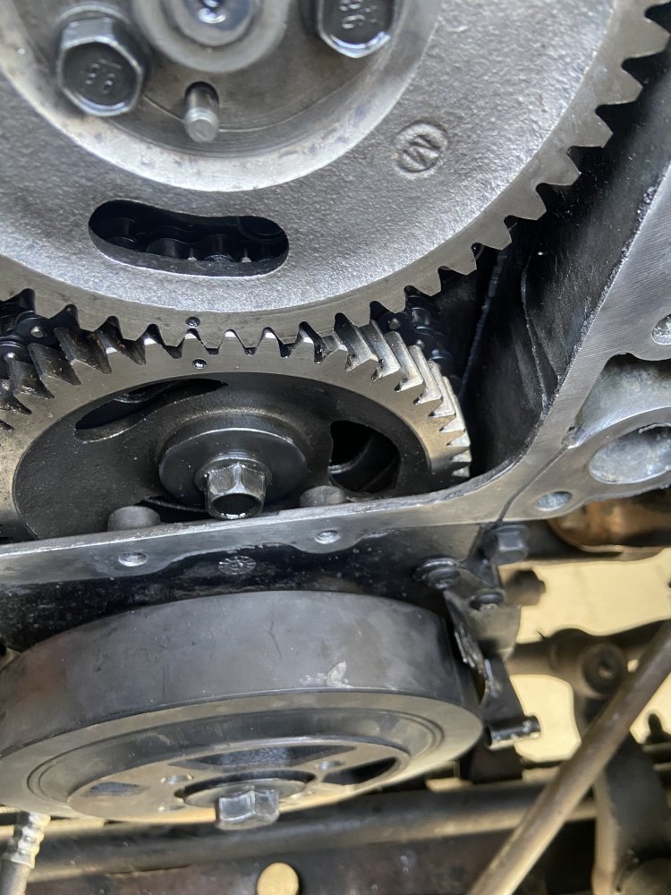

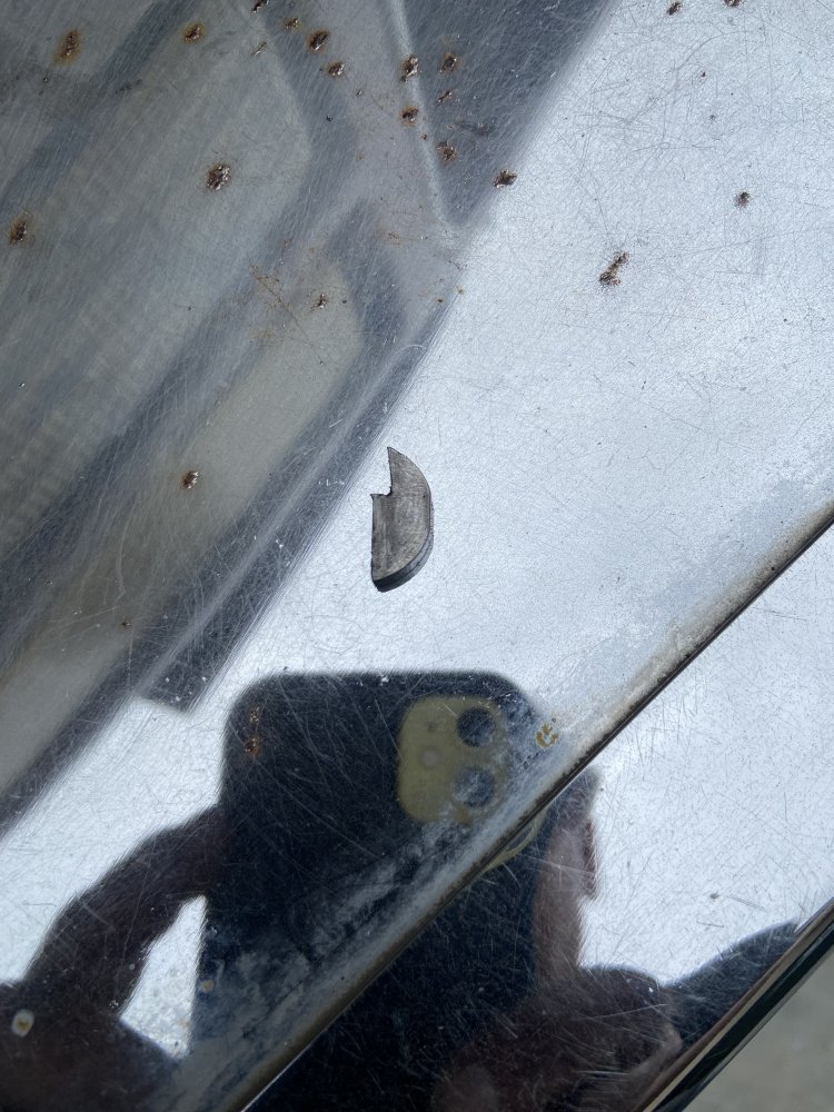

The truck, not so much. Still my driveway gnome. Latest theory is maybe the camshaft IP drive gear wasn’t properly torqued, if at all, during the build and the Camshaft Injector Pump Drive Gear Key is sheared. Why the sudden shift from “ok-ish” performance with initial IP and injectors installed to undrivability with new IP (s) and injectors is no longer a point of concern. Bill wants time to investigate and I don’t care to disassemble. My brother wants to test run his new trailer and Bill really wants a crack at it where he has space time and his tools so, this Friday (7 Oct 22) the truck gets schlepped to WA so the motor may meet its maker and both can find closure.
Boy, it’s been a while huh. I’m alive and getting over contract losses, forced retirement, shingles and a bad attitude which is why I’ve “logged out” of many things. Pro tip: grandkids.

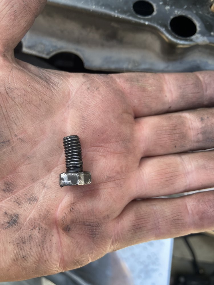

My recent experience with a sheared timing gear key:
51CF5DD0-851C-42DE-B51D-1C2672BA9C8D.jpegC42C2444-0730-47A8-B9B1-854E93E7F9AA.jpeg0E2D3D87-00A6-4B5B-8FDF-580AF10ED6D5.jpegD33CAFDD-C2AA-42FA-B665-D4238DCB8276.jpegEB7F31C9-EF4A-4820-8885-9749E1110A34.jpeg

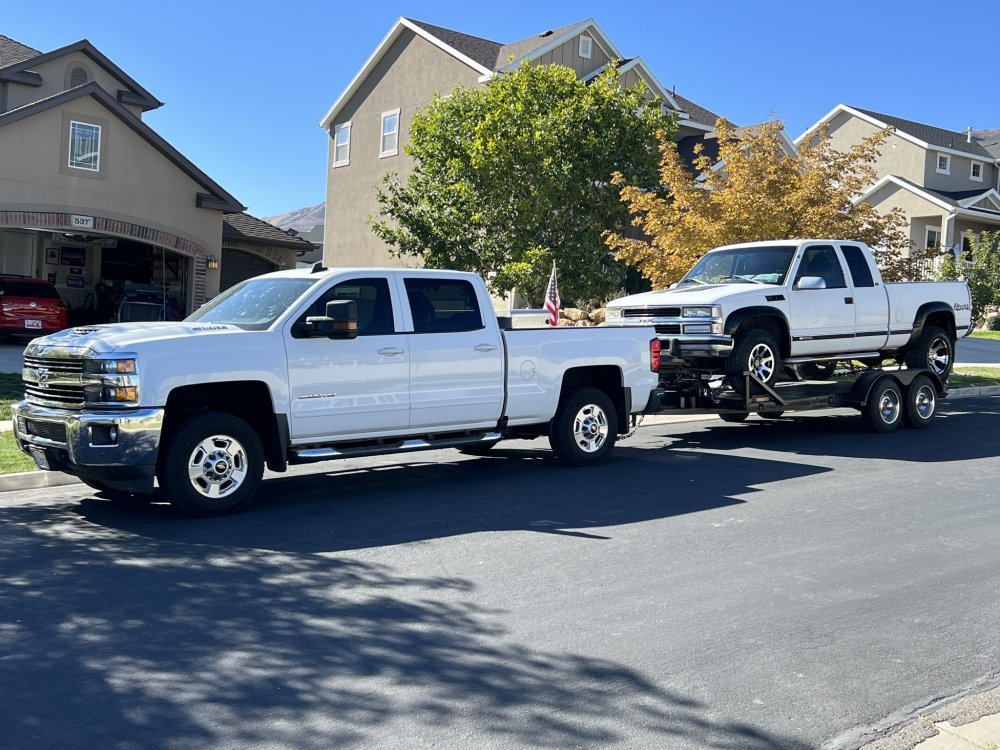

Finished the drive up to WA to drop off my truck at Bill's so he can dive into the issue that I'm not getting near (wrenches associated with that job don't fit my hands).

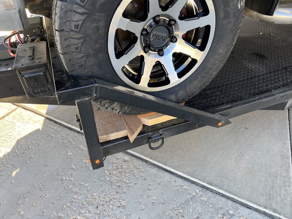

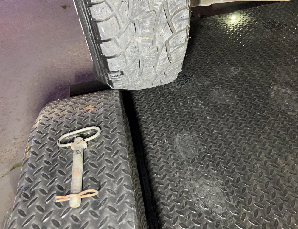

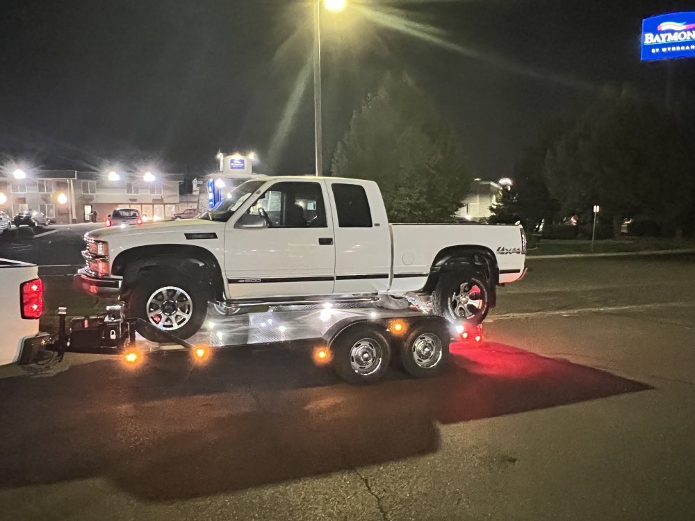

Thursday (7 OCT) my brother Jack drove up from Ventura CA with an almost quick stop in Quartzite AZ to pick up his newly modified trailer from our brother Ted (former 6.5 owner and member '635'). Friday morning we loaded up the truck after buying a new wheel and tire because my the offsets on my current wheels and big tires were too wide to fit the trailer. Truck has an 80" wide track and the trailer is 77" wide at the fenders, spare tire mount and front rails. Used spare on the other side. New wheel looks good so.... Other issue was the now shorter front tires made the truck too long for the trailer as the cross member hit the front rail before the tires did and the rears were barely on the bed. A couple of 2x6s screwed together for the tires to rest on and we could pull it all the way up and had the room for the rear tires. Just barely as they about hit the fenders as well.
Short history on the Truck and Trailer: Trailer was originally 16' but got bobbed because of rust. Guy that rebuilt it added lights all around it cause Ted is a former flat bed, AKA 'Skate Board' long haul professional driver, and likes lights to include 'runway lights' on the bed. Still, at 13" 9" it would be fine as the truck's wheel base is 12' on center. Jack's truck is a 2017 with the LT5 DuraMax (BtFarm approved I'm sure) so it didn't feel the trailer or the truck at all. Fuel mileage was 23 with trailer alone and 13-18 depending on the grades.
$400 worth of new 3/8" chains and ratchet binders later and 6 hours behind schedule we were off on a 'hot shot load' non-stop 800 miles to Washington, darn near Canada. Next morning, after off loading we drove over the Cascades to visit with his mom, brother and sister-in-law in Sedro-Woolley. We then made a 'short' run to Pendelton OR where we spent the night and got an early start and spent the evening here on the deck enjoying steak and the full moon rising. Jack rolled out early this morning and after another 11.5 hrs he is safely home. Total driving distance since Thursday morning: 3727.1 miles.

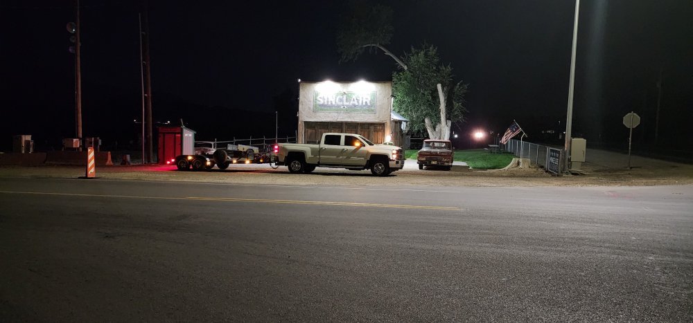

Elberta UT, 27 miles south of my home.

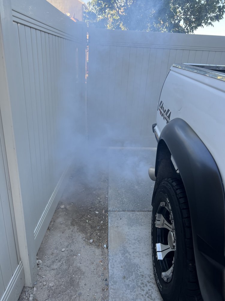

SSDD, Same Smoke... Chugged and lugged but made it up.
"Fat bottom girls" may make the world go round but, fat tires don't fit between the fenders etc.
Short OEM tires don't allow the truck to get all the way forward either. A little lift needed.
Ready to roll.

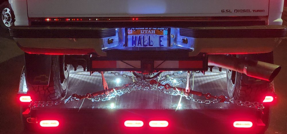

Tight fit but the chains also acted as chocks.
Looks good under the lights, even with the paint scuffed with 220 for possible paint job in the future.

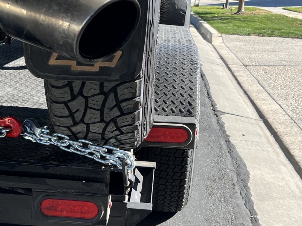

New Chains and Binders show off well too. Need a new tail gait light strip though.

I would have to be there to trouble shoot it. Not going to speculate or pontificate.
Me neither. Phone con today and after 24hrs of deliberation, the motor is coming out. Prior to removing the front timing set cover he'd noted that after running and smoking for 90 min with no improvement in smoke reduction or smoothing of idle the low coolant light came on. Every six to 12 months I have to top off the fluid and I'm not sure if I'd done it prior to hauling up there but, I did include a couple of DexCool gal. jugs in the stuff I sent with up with the truck so I'm betting it needed a top off and I just had my 'screwit' mode engaged and decided to let him deal with it.

Broken clock reading the same- but you dont need any supporting parts to try a db2 other than pump and injection lines. Don’t even hook up a throttle cable. Just remove the intake, 8 lines from the injectors and lift the ip like a spider. Drop on db2 with lines and learn without pulling the motor out and apart.
Still runs bad - smoking and all that- then yeah you probably washed a cylinder or something.
I don’t remember- did y’all do compression test?
Clear ip return line?
Ever put the soda bottles on all 8 injector lines to see fuel coming out equal on all 8?
