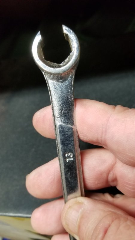

I've always been able to use a 19mm flare nut wrench with an offset handle.
Not familiar with a flare nut wrench.
Anyway, after pulling the IP I cleaned up and showered to go watch the grandson's season opener for T-ball. I got there as they were clearing the field acting as if I saw the whole thing. My wife spent the game talking with in-laws.
I got the crow's foot wrenches after the game. I could have tried to install the pump from the '95, but my foot was screaming from standing on a step stool and leaning over the engine. 80 days out from surgery which included achilles bone spur debridement where the achilles was partially detached from the heel. That type of movement and work really aggravates it. I'll install the IP from the '95 engine next weekend.
A flare nut wrench looks like a six-point box wrench, but with an opening in the box on one of the "flats" so that it can be passed over the line the flare nut is on, then slid down over the flare nut. It engages all six corners and five flats and part of the flat on each side of the opening. It is designed to not round off the corners, nor distort the the nut itself, when loosening or tightening flare nuts, which are usually made of brass. Works perfectly for the steel injector line flare nuts on IPs and on the injectors - exactly what it's made for.
The added advantage is that they're much more compact (like the box end of a regular combination wrench) than any Crow's Foot wrench and don't need and extension and ratchet, either. I've always been able the lossen/remove the upper four IP nuts/lines, then rotate the wrench 90° so that the head is parallel to the injection lines, slip it down between the upper lines, then rotate it back 90° so that I can slip the next line down into the box, then slip the box over the flare nut and crack it loose. Then, just like a box wrench, slide it off, reposition back over the next set of flats/points, rotate and repeat until the nut is free of the IP/injector. I repeat the process around the bottom half of the IP head. Takes about five minutes max to remove all eight nuts that way. Installation is the reverse, start with the lowest line and work your way back and forth up the IP head to the uppermost position. About ten minutes max.
I always use the 6 point flare nut wrench to loosen the lines then, if they is difficult to get to, use a 12 point FN wrench to finish taking them off. Saves a lot of switching the wrench around to get to the next flat. Sometimes after getting the nuts cracked loose, an open end can be used to get into some weird angles.

Which all use some form of. . . .Flare Nut!
Agree 100% and flare nut wrench is the appropriate term imo. Just sharing incase others haven’t herd the term.
@BigT if the added cost isn’t worth the other tools- I get that! Them suckers get spendy! And don’t waste money on cheap ones, that the kinda tool to buyince and cry once.
But it’s good to know what's out there for times you spend 5 hours doing a half hour job, or times you get tired of tearing up your hands, back, and shoulders.

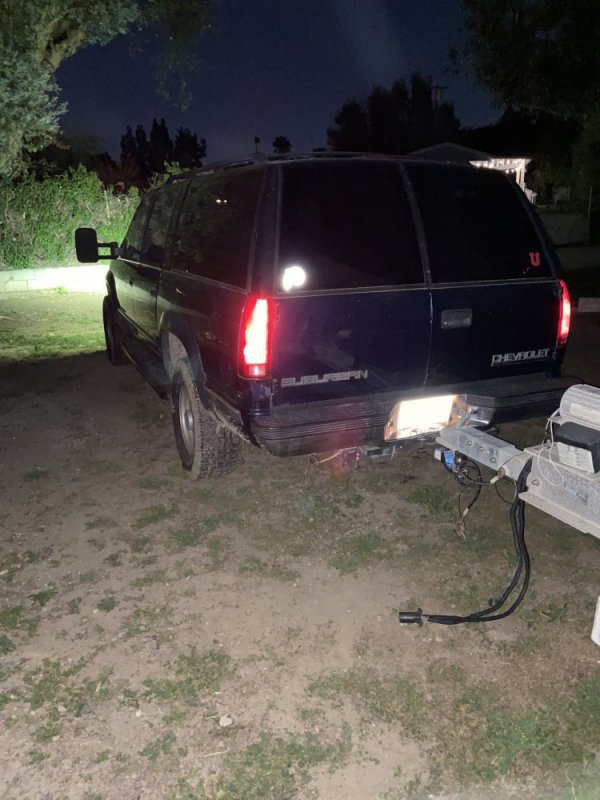

This was over in the electrical forum, but it qualifies here. Thanks to Nanook of the North, aka Les, I fixed my lost running lights by replacing the headlight switch. Very quick and easy job, also due to quick tips by Les.
