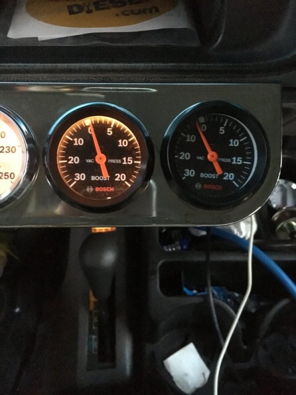

Looks like I need a lift pump.
The boost Guage on the right is for fuel pressure. When I left my house tonight it was reading 7lbs. On the way home I noticed it was in a slight vacuum so I took it easy.

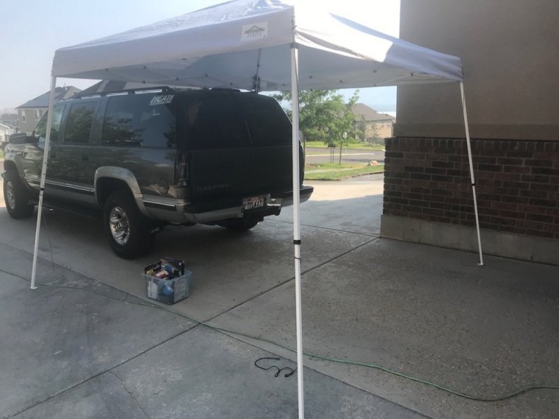

Saturday, took the Burb out and about in the hills with a friend visiting from Calif. Slight decent...

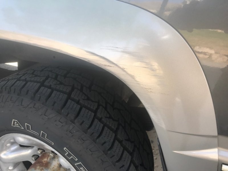

Yesterday, I was backing the Burb into the garage to work on the barn doors (one needs alignment as it needs to be lifted to close) and got about 1/8" too close to one side and scraped the driver's side fender flare.
I got the door to close much better but, the bushings from LMC are a tad too large so, it will have to wait for an alternative solution.
Today I got the scratches sanded out of the flare, primed, painted and clear coated.
Currently sitting in the sun to, I duno, cure or harden or something.

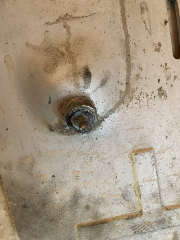

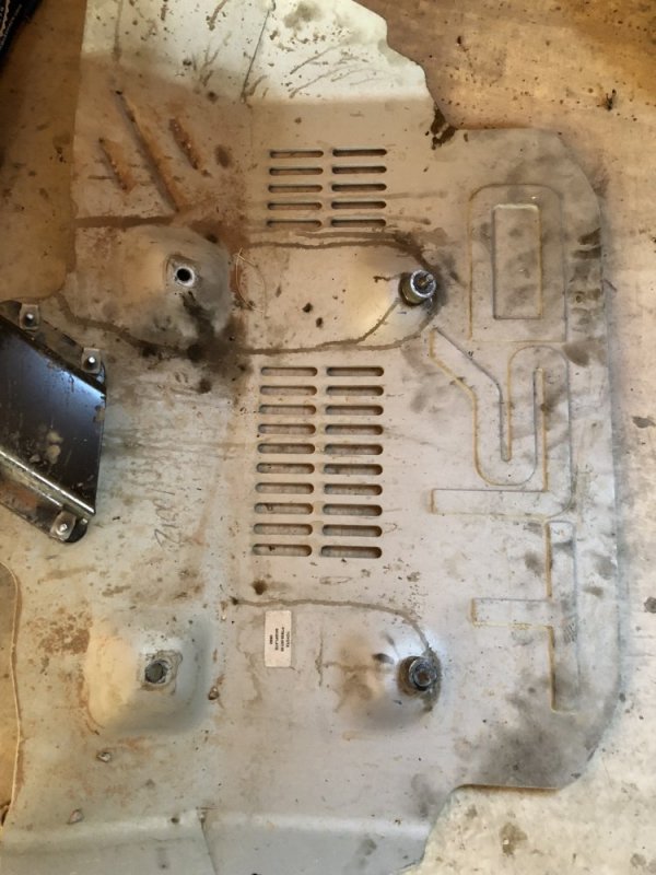

These pictures provide answers to two questions; one personal, one much more macro. While on vacation, we dropped the 4Runner off at Walmart in Missoula for an oil change. They said it would be an hour, so we walked over to Sportsman’s Warehouse to get our Montana fishing licenses, a fly line, fly box and some flies. Came back to Walmart an hour later and the 4Runner is still in the bay with the hood up and no one working on it. So we continue shopping in Walmart, come back and the 4Runner is still there with the hood up and no one working on it. Sit down in the waiting area and unbeknownst to us, they move the 4Runner out of the bay and into the parking lot. I inquire about its status and the guy at the register could not find any paperwork. He finally talks to the tech who says that he could not remove a bolt from the skid plate and suggests that it’s stripped. Hmmm, I installed that skid plate which is a Toyota TRD version. I check the bolts on the skid plate and they’re all tight, so the issue is not a stripped bolt or the frame threads.
I gave up and went back in the store and bought oil and filter. Then I went to Harbor Freight and bought a ratchet set and filter wrench. After much more shopping at HD and Costco (we’re outfitting a 3rd home) we get home and I tear into the oil change job. Here’s the pics of the inside of the skid plate. The front two bolts have spacers and they are held to the spacers by washers. So when the bolts are fully backed out of the frame threads, they just spin and never fully come out of the skid plate, by design to keep the spacers in place. Had the idiot removed the rear bolts, the whole skid plate drops down. Duh!
Answer to the personal question of why I do this work myself: I just wasted 2 hours waiting for this idiot to fail. I then did the oil change myself in 30 minutes. My time is valuable, especially while on vacation.
Now the the macro question as to why there is income inequality in America: You just can’t fix stupid!

He might have started with a front one and once it started spinning assumed it was stripped. He probably doesn't know how that particular skid plate comes off.
This is precisely what happened. But how could spinning on removal indicate that it was stripped? Even worse, when I checked all the bolts were torqued back into place, so it was impossible that the one bolt was stripped. Had he attempted to remove the rear bolts after the fronts were spinning and not coming out, the whole skid plate drops.
