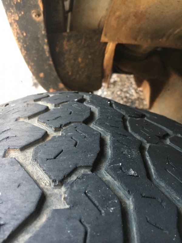

Yes they had minor sun rot cracks. Ironically, the one with the most amount of tread went. The other is down to the wear bars and I was planning to go another 100 miles on it. Then I had another to replace it and bring down the tread of better one to near the wear bars. Pobably about 5K to 7K miles. Then I had two old ones from Paveltolz to run through.....probably about 15K miles. But the best laid plans are pointing to new tires tomorrow as this truck will soon be living in Montana.

The other old tire.......I ride these BFG AT KOs to the bitter end because I hate them. They don’t last worth a damn. I take great pride when I can wear one down to the bars.

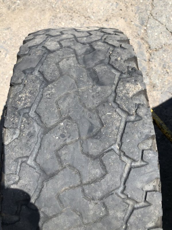

I was driving down the road today and I felt the front end start to shake a little. I’ve been trying to get all the life I could out of these before I replaced them but looks like I’m just going to go ahead and buy a new set 3ED7B708-99F6-47D8-AA86-DC8DD8C20A20.jpeg

I was driving down the road today and I felt the front end start to shake a little. I’ve been trying to get all the life I could out of these before I replaced them but looks like I’m just going to go ahead and buy a new set View attachment 53445
What brand/style?
That's me! You got pretty close on the wear, but your belt separation radar is slooooooooooooow.

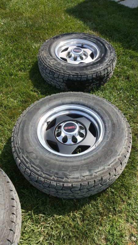

I put new Cooper AT3s on the rear. Should be good for awhile, but I will sneak the old BFGs on during the cooler months.

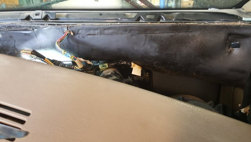

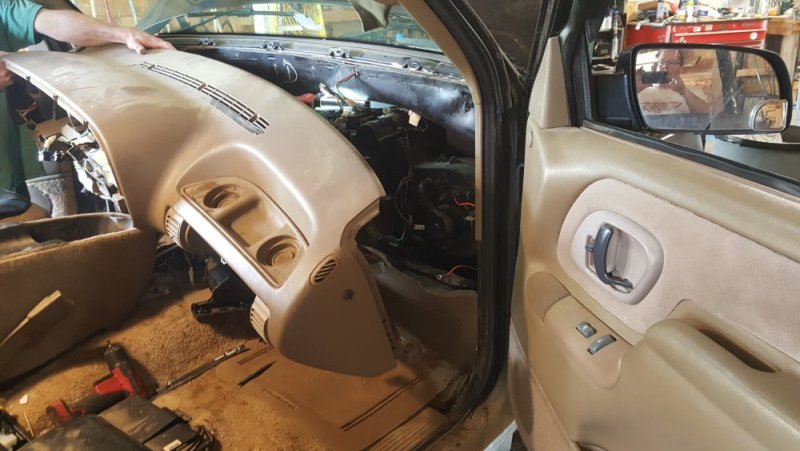

a month back I did the dreaded Evap core behind the dash, yep had 80% of that thing out. tilted and lifted to schooch by to get them darn case bolts out. But the reward was a cabin I can hang meat in again. 95F a few weeks back and had 52f at the dash vent. on high idle in driveway. Once out on the open road, it's about 15 mins before the kids are begging me to put it on rear control so they can warm back up some.
