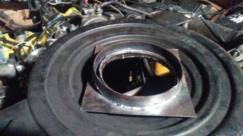

Could not find a 6.2 air filter housing so I am modifying a gasser housing to fit. Got an adapter plate welded up, then will cut out the center of the old filter housing and weld the adapter plate in. The center hole on the housing is about 1/2 in larger for the 6.2. I will trim the adapter flange into a circle of course.... its dark outside and my camera does not like the low light but it should give you the idea of what it will look like.
