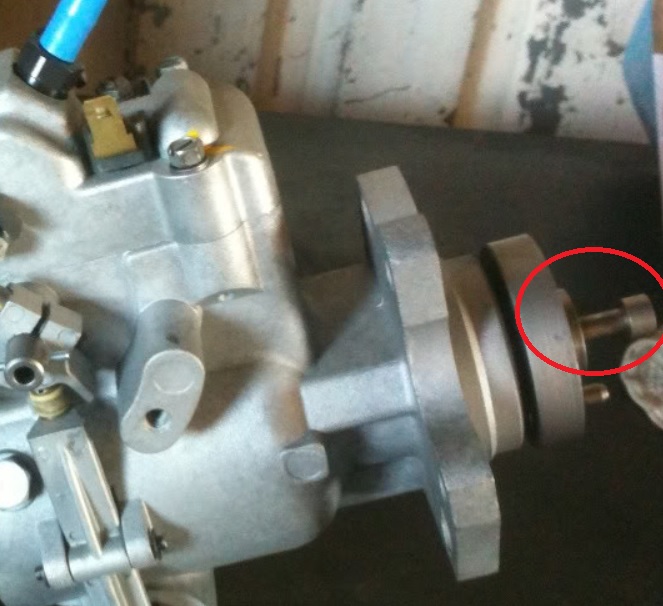

that sounds just like mine when i forgot to install the pin/spring on the front of the IP.
hmmm.... does it fall out really easily? I remember reading about yours so I was kinda thinking about it so I think there was a spring there, but that was a number of months ago. I had to buy this IP as the engine did not have one with it and if the parts were missing, I would never have known what it looked like, but I do remember seeing the plate that the spring rides on, and I think there was something on the front of the IP. Thanks for the heads up and I will double check.
the spring and pin are together and mine never separated. i had left them both out. it's a pain as the injector lines, three mounting bolts, three IP to gear bolts, and oil fill all need to be removed. try to wait for another answer. might be an easier solution.
@deejaaa is talking about the thrust pin and spring here. You can pull the oil fill and look for it easy enough. It rides just on the bottom of the oil fill area.
