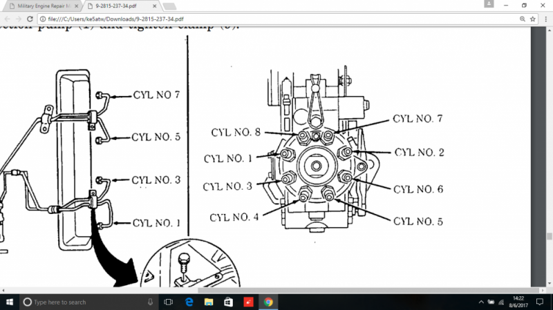

Got a couple hours on it again today.............. I have looked around but have not found a diagram of which fuel injection lines go where. Anybody know? I have taken them off and put them on multiple times on my truck, but they were always clamped together and I did not bend them out of shape. The lines that came with this engine are kinda scrambled. I think I figured out which line goes to which injector, but I am not sure which port on the back of the pump they fit to.
