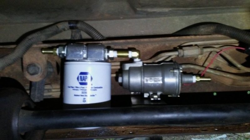

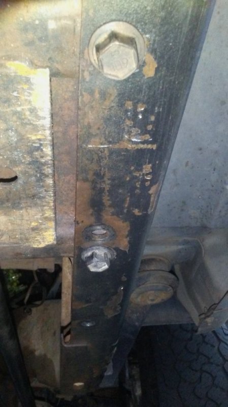

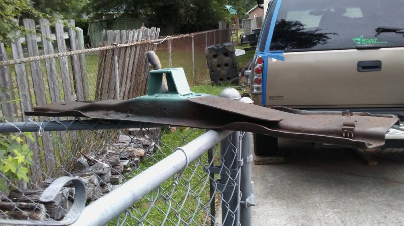

Progress tonight was getting Leroy's filter and LP installed, and finishing up moving the modified trans cross member. Had modify the cross member to give the drive shaft clearance on the torsion bar cross member.20170620_182147.jpg 20170622_202553.jpg

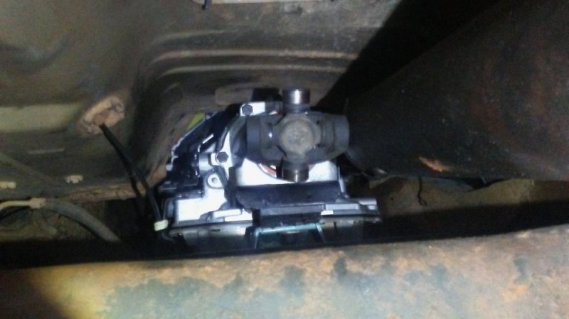

Once the drive shaft is trimmed down in length it should fit nicely (it is originally out of my excab long bed parts truck)20170622_200924.jpg

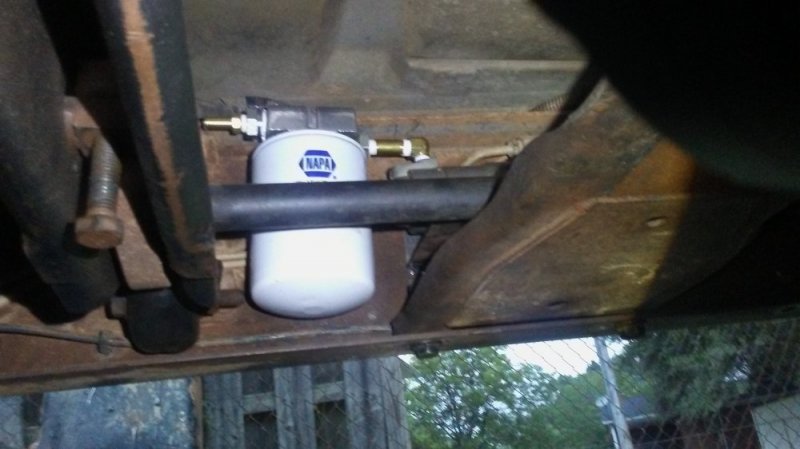

Just enough room to slide it out! so I should not have to remove anything to change the filter20170622_201101.jpg 20170622_202629.jpg
moved the transmission support cross member back about 6-8 inches for the 4L80e transmission.
That's an awful lot of filter weight to support with just a pipe on the Walbro. Diesel vibration IMO will make this a problem in the future. Either *SNAP!* *cough* *Stall* or leaks. Have you removed the screen from the Walbro bowel as the spin on is doing the job now?
The Walbro is sitting on a plate bolted to the frame, and the filter base is also bolted to the frame. Should not be any weight hanging on the pipe. Leroy's filter setup has 3 mounting bolt holes in the filter base (I trimmed the top one off because of the tight fit) so the filter has two bolts through the frame.

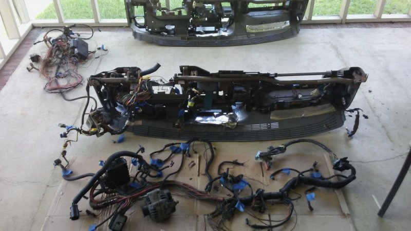

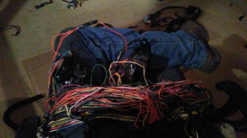

Got some more work done on this Saturday. I decided that it will be easier to swap the entire harness from the truck rather than patch the original gas harness. This will allow the computer to control the glow plugs, the low coolant light will work with no wire patching.... basically all of the instrument cluster will plug in and work with no cut and splice. Also the 4x4 wiring for the tahoe was making me unsure how well/easy it would be to splice in for the speedometer. And I get to move the computer out of the engine compartment (opening up some free space for something) to under the dash. I am not sure why it took me so long to decide to do it this way.....guess it was not wanting to pull all the wires out of the truck, but the job went much quicker this time (since I learned how to pull the dash on the tahoe) It will not all be easy cause now the cruise control will need more work, and anywhere the tahoe chassis wiring does not line up with the trucks I will have to modify, but I think it should not be to bad.20170702_154043.jpg
The dashes are different colors so I will have to transfer the wires over...............

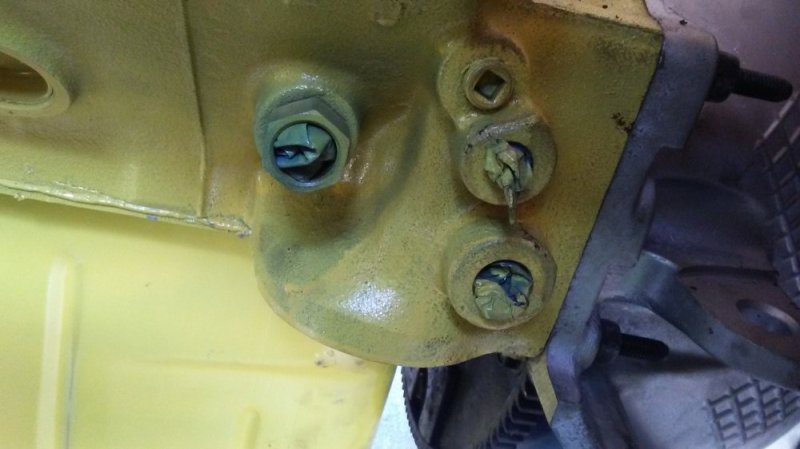

Which oil port would you hook the turbo up to? There are the two oil cooler lines, then there is one hole that did not have anything in it when I got the engine (not sure what was hooked up there, if anything) then the plugged hole.20170702_161519.jpg
