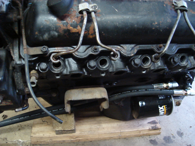

Which oil port would you hook the turbo up to? There are the two oil cooler lines, then there is one hole that did not have anything in it when I got the engine (not sure what was hooked up there, if anything) then the plugged hole.
GM used the one on the right front of block just ahead of the cylinder head. Then some newer blocks had a port in the 'valley' of the block. If your 6.2 is an oldie like mine it had neither so I just T'd into the oil pressure switch port on the top left rear of the block.

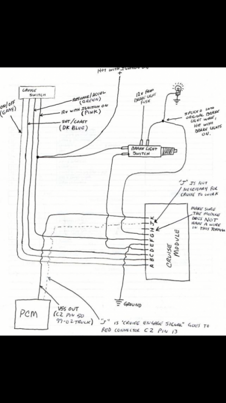

Got the cruise control harness pulled out. Looks like all will be easy to connect into the new harness except for one wire........... It goes to the computer, and is called "VCM signal" it is light blue with black stripe. Any of you guys running a mechanical swap and have a gasser cruise control know what you hooked that wire to?
@n8in8or It looks like I will be using a similar cruise set up to what you have. Do you remember where that wire went? I read through your post but it was either not mentioned or I missed it.
So Bobbie Martins guide says that pin J (the blue black wire) is not used, and that pin H which currently is empty should be connected to ground........ I am a little hesitant because his guide was written for OBDI trucks as far as I know. I don't think there would be a difference in this area, but...................any thoughts?
This is a diagram I downloaded off the interwebs when I was trying to figure mine out. See if this helps. Note that this one says that H is empty. I'm sure I left mine empty as well.

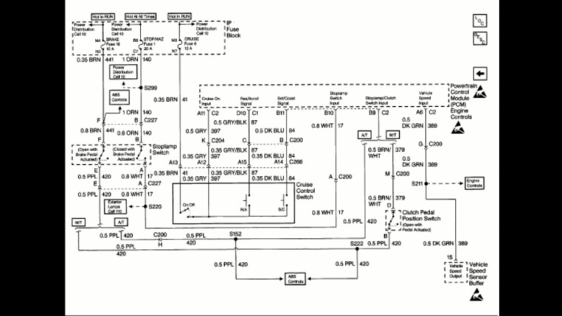

Thanks! I think between that and another wiring diagram I can get it to work........ So I guess that wire (pin J) sets the cruise control light in the panel? Guess I would not have to have it if I have a hard time finding that pin. I noticed it said "99-02 trucks" next to the speed sensor wire and some of the wire colors are different.
The speed sensor wire was originally spliced into a group of wires, one went to the buffer, one to the comp, and one to the radio. The truck harness has the same wire running to the radio so I can splice in there.

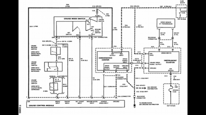

You're welcome. Yes that sounds familiar- that it's a feedback signal wire. Here are 2 other diagrams I have saved on my phone. So between the 3 I figured mine out I guess. I'm not sure they're very readable.
Yea those old wiring diagrams are tough to read... I have a set that lines up better with my tahoe but they are not easier to read............
It is an oldie............ So do I just plug the other two holes by the oil cooler lines?
Yes. I suppose one could use one for turbo oil, just would be a long hose and closer to hot things. I can't remember what ports are pressure and return.. it's been a while since messing with these. I do know you DO NOT want the GM CLIP STYLE oil cooler lines or fittings. Many engines have died because of them.
I used basic tractor hydro stuff for oil cooler lines. Still works.
