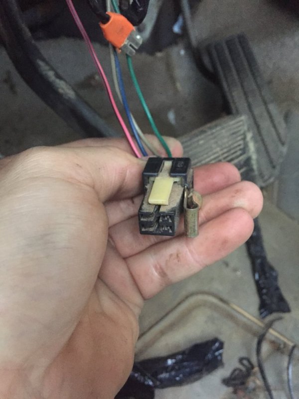

Do you know what this plug goes to?
I recall this is part of the multifunction lever aka "turn signal/cruise/wipers" I believe the orange plug also goes to it. Should be some wires hanging out of the column to go to the stalk switch as I just described. Not at all related to "cranking".
