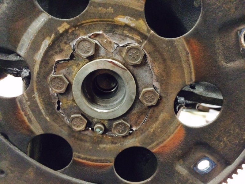

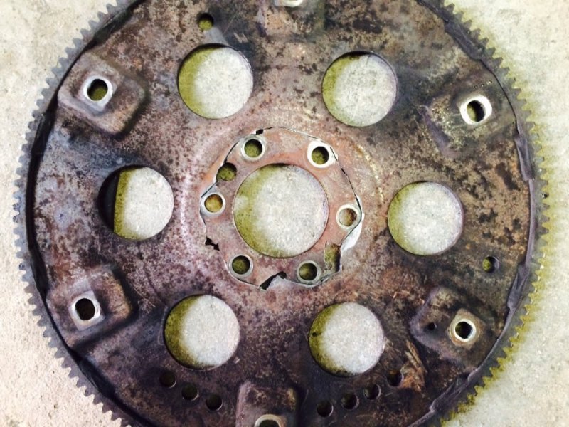

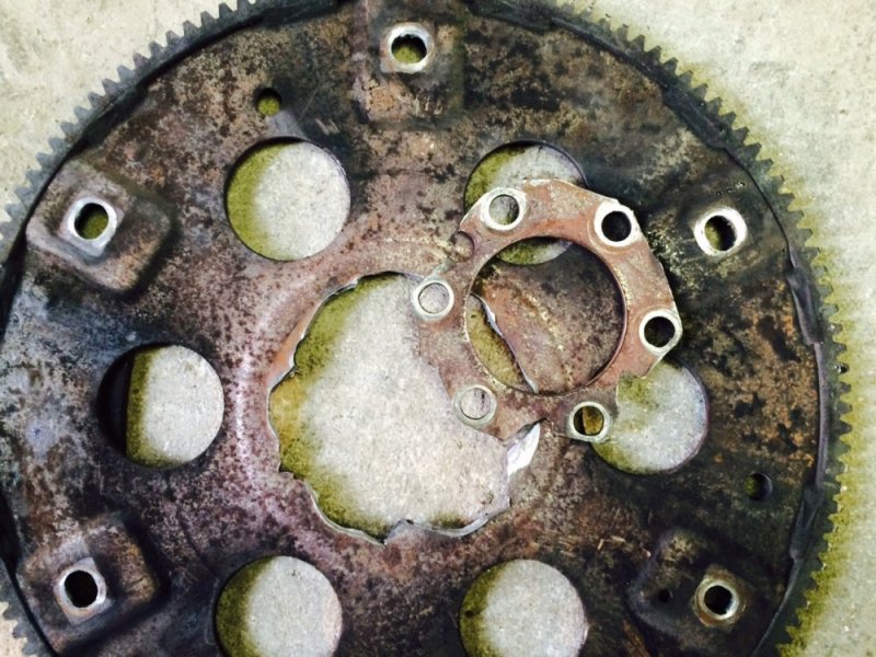

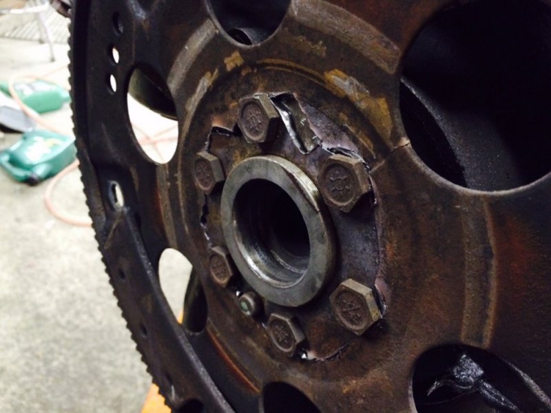

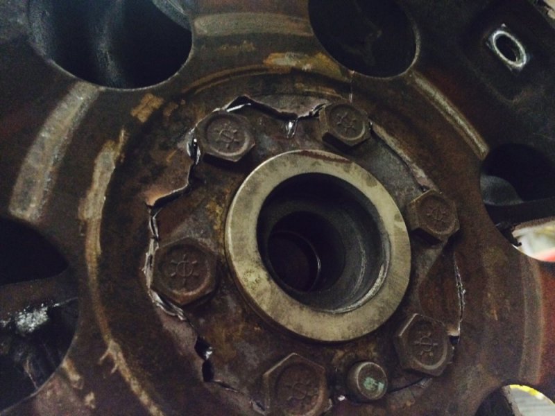

Oh crap. I'll be sure to check that out. Maybe that is why I've had an imbalance since I built it too.Looks like you have yours on backwards. The bumps should go toward TC side.
Will do. ThanksPossible i guess.
I would look real good at your front pump and bushing as best you can for damage. Also check for wear on TC notches.
Oh yeah it's going on the wall for sure. I'm just going to get a stock replacement from Autozone. Since it failed due to me installing it incorrectly I am no longer worried about a stock replacement failing anytime in the near future.JB weld, good to go.
That would go on my trophy wall. What you get for a new one?

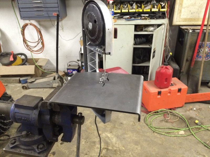

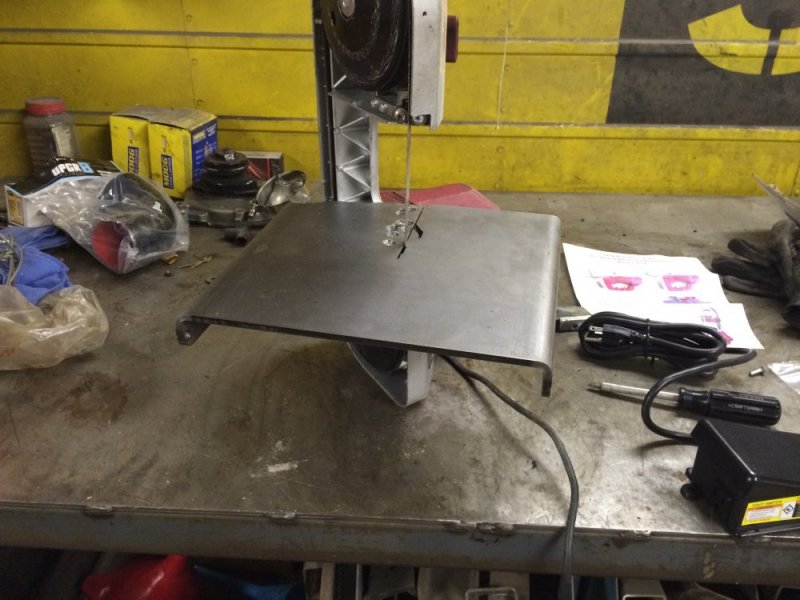

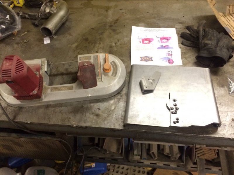

Thanks Matt! Yeah it's super handy....I highly recommend picking one up.Nice work as always Nate! I may have to look into that band saw, as it would make a very handy addition to my shop. I look forward to seeing the finished product.
Matt
No way, Jose.When your done with this mod want to sell me your table for $9.99?
It's $58......yes it could be fabbed at home for less than that, but all of the design work is done already and it's nice and flat. From the time I opened the box to the time I was cutting steel was 5 minutes as opposed to the time I would have into designing the table, getting the material and fabbing it up. Personally it was worth it to me. Individual results may vary.....It was worth a shot. How much are they?
