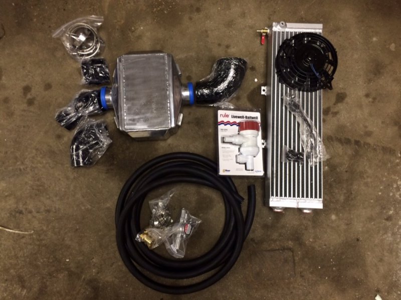

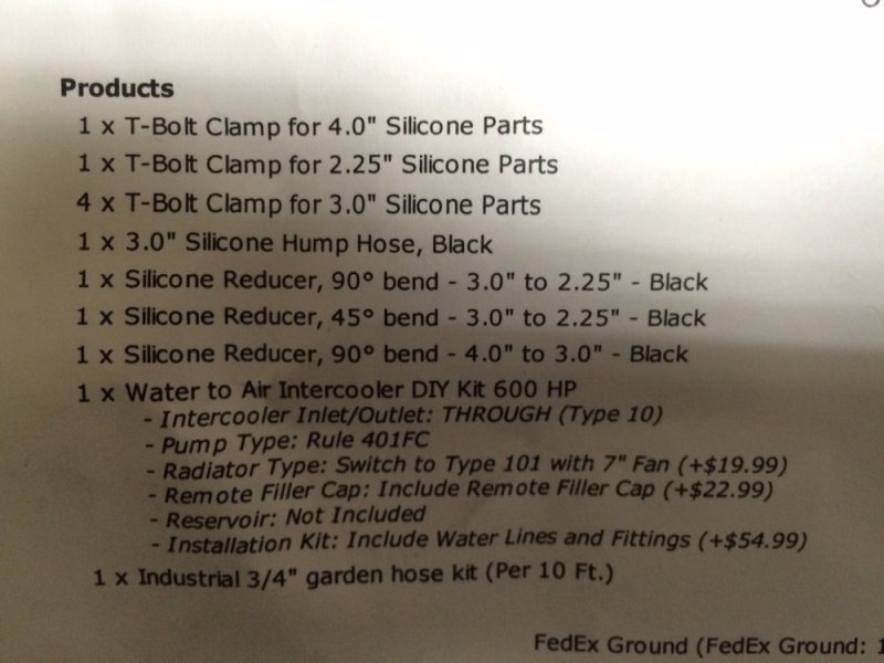

I went with a kit from Frozen Boost. I went for a kit rated to around 700 cfm, so it should have more than enough cooling capacity. The options I selected are:
Type 10 intercooler which is 3" In/Out straight through
Type 101 radiator with 7" fan. This is their highest rated radiator and I liked the size of it (long and skinny), which I figured would work well where I intend to mount it
Remote filler cap
Water lines and fittings (I also ordered an additional 10' of hose since I'm mounting the radiator so far away)
4" to 3" 90* reducer
3" to 2.25" 90* reducer
3" to 2.25" 45* reducer
3" hump hose connector
T-bolt clamps to go with the silicone connectors
I ordered more silicone couplers than I need, but I wanted to have options for when I actually started installing so I didn't get stuck later.
Later I ordered a second fan once I saw how little of the total surface area the 1 included 7" fan covered. I could eventually use 3 fans if I really wanted, but I'm going to start with 2 and see how it does.
Here's what the kit looked like when I received it.

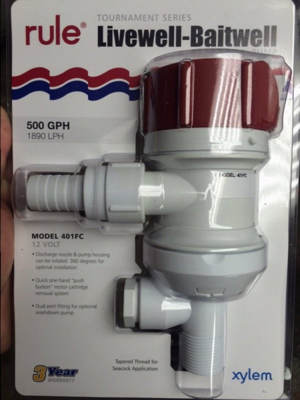

This is the pump they provide with the kit
I'm really impressed with how heavy the intercooler and radiator are. They seem really well made.

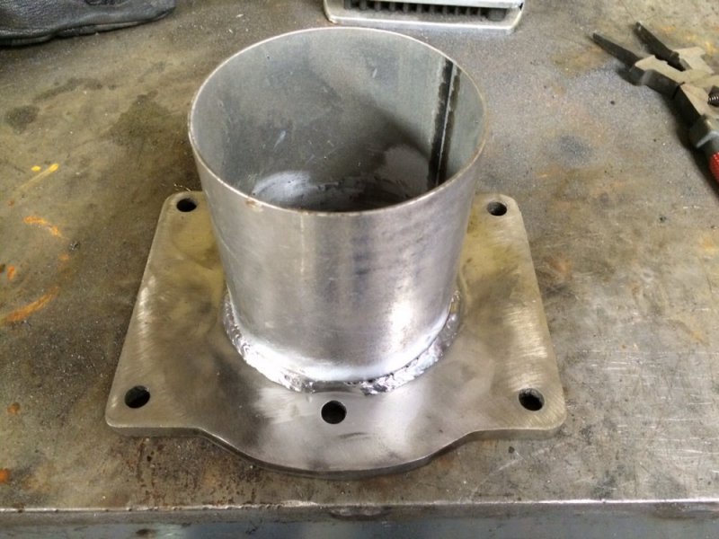

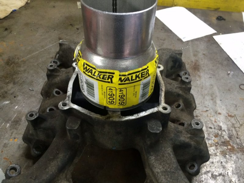

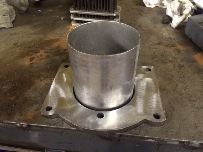

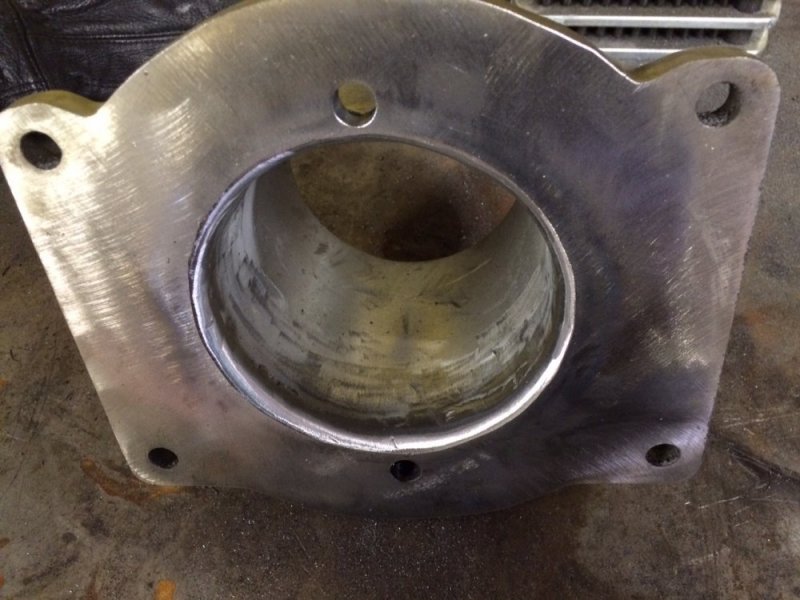

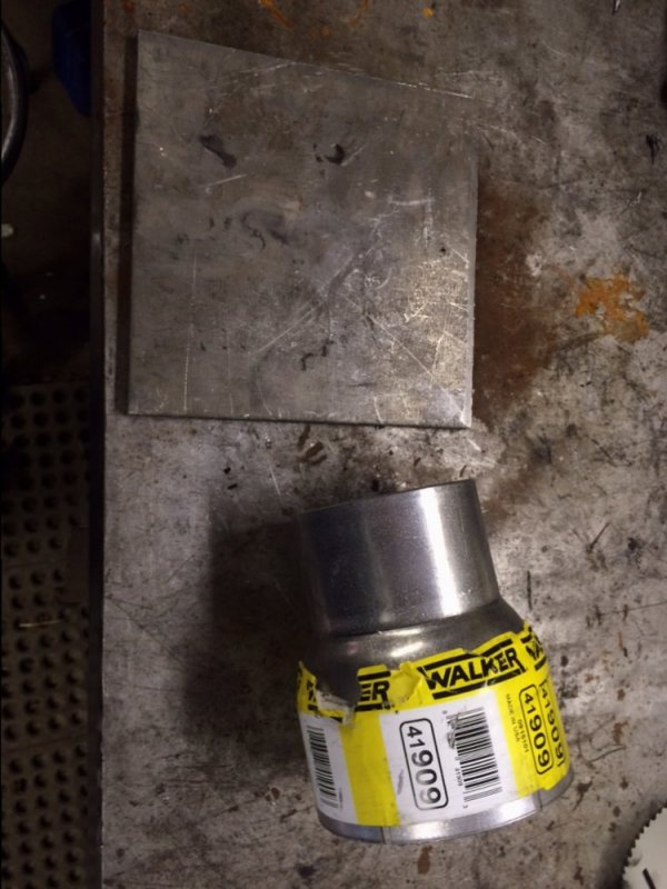

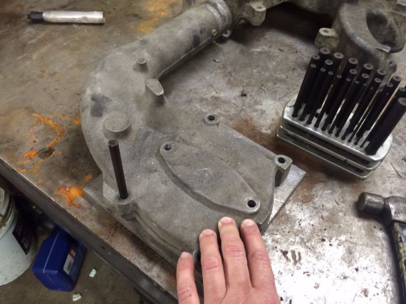

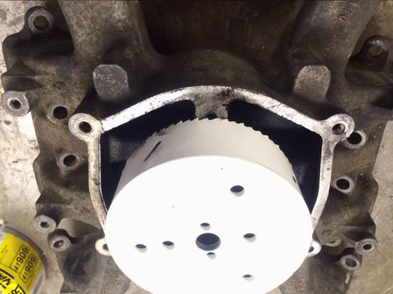

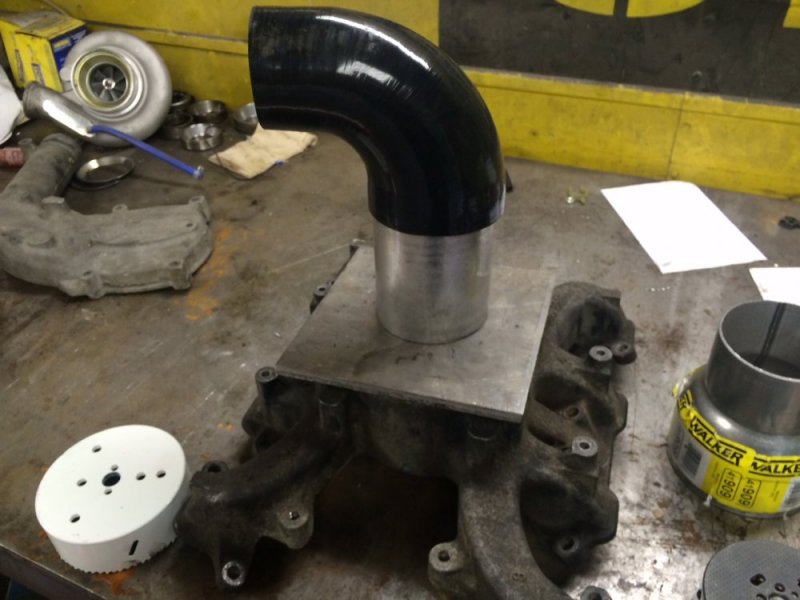

I have started making the new upper intake that will help with the installation of the intercooler. I used a piece of 3/8" thick steel plate and a leftover piece of 4" exhaust pipe. My initial plan was to use a 5" to 4" exhaust reducer so I could open up as much of the intake as possible, but it was going to crash into the 2 middle mounting bolts. I don't have the ability to weld aluminum at home so I don't want to try to move those mounting lugs to the outside of the lower intake....it could be done, I just don't think the extra effort is worth it. The 4" opening should be more than sufficient.
I can't get this picture to not load upside down, sorry, but you get the idea.
plate and reducer.jpg plate 4 pipe on intake.jpg plate 4 pipe and elbow on intake.jpg

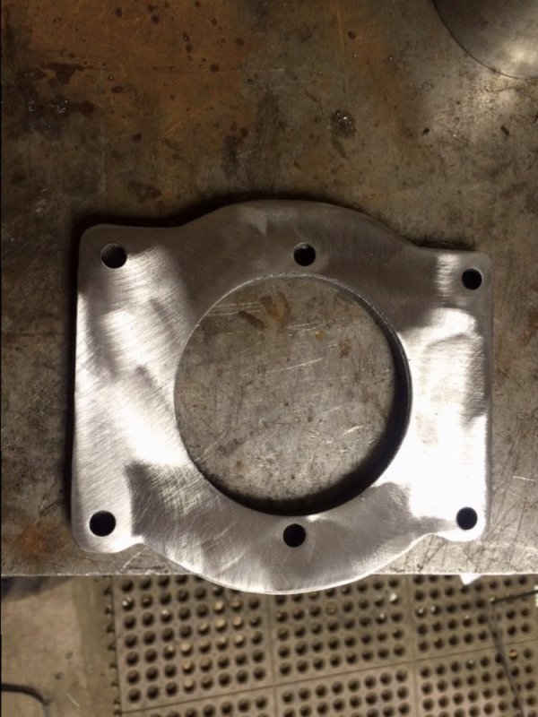

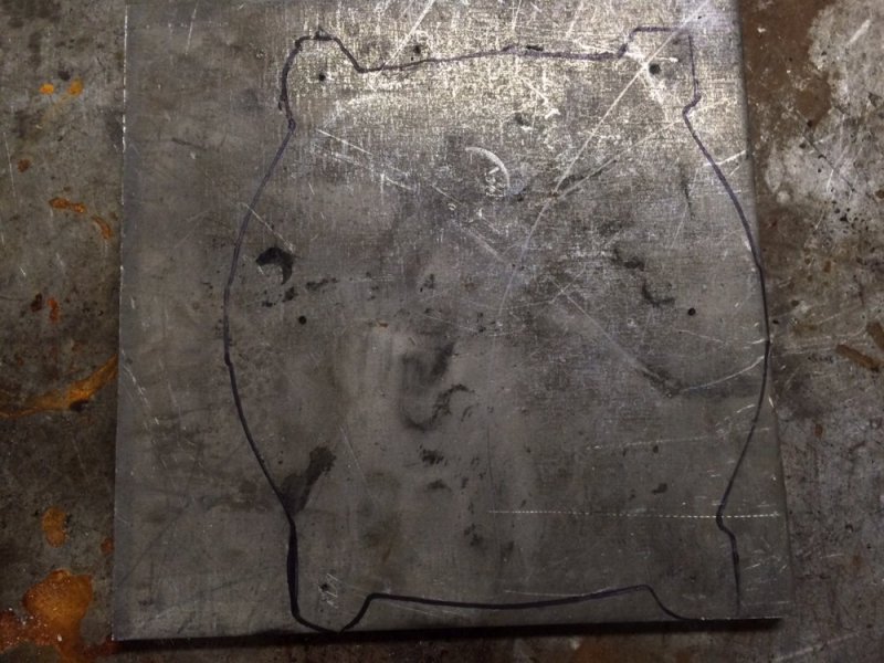

I used an extra upper intake to layout the mounting holes on the plate and then cut the 4" hole with a hole saw.
upper intake on plate.jpg upper intake layout on plate.jpg drilled plate.jpg

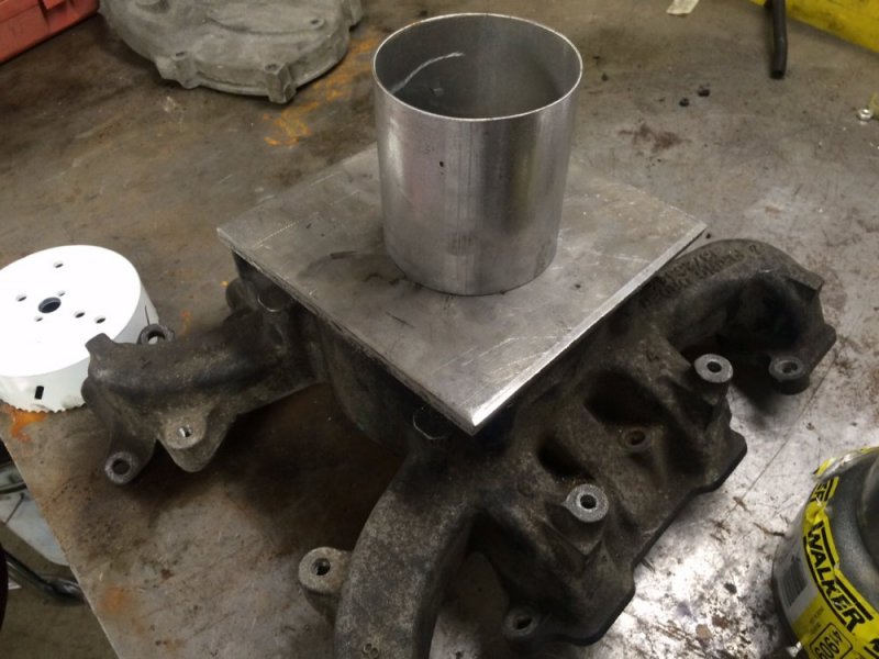

Before welding here is what the mockup looks like

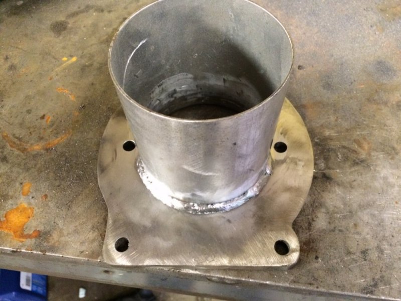

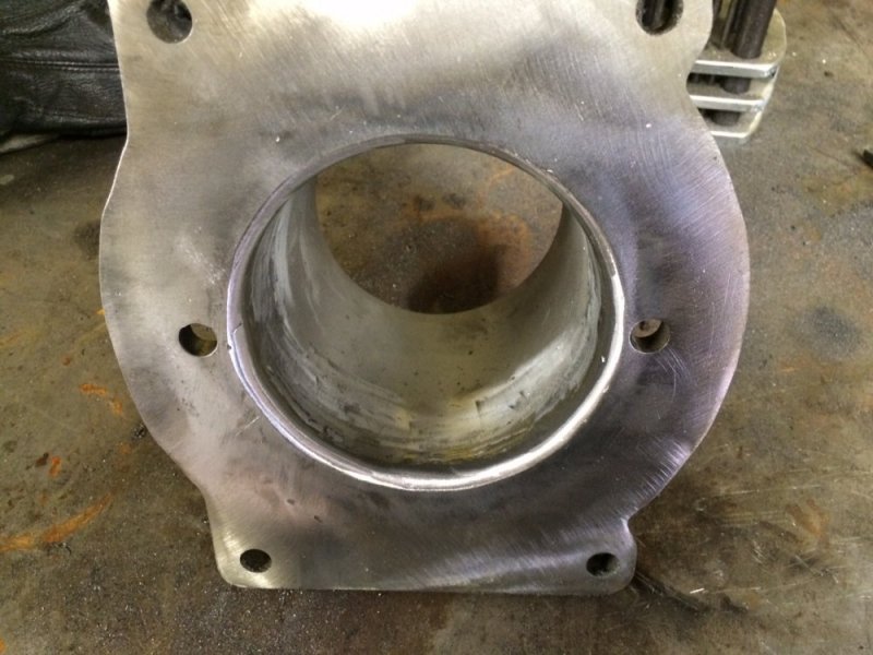

Here is the upper intake after welding. It's pretty much complete in this state, but I still need to drill and tap ports for the IAT sensor, MAP sensor and boost gauge. I will also trim the height of the 4" tube once I get everything in place and figure out what the final height should be in order to fit the best.
upper intake welded 1.jpg upper intake welded 2.jpg upper intake welded 3.jpg upper intake welded 4.jpg

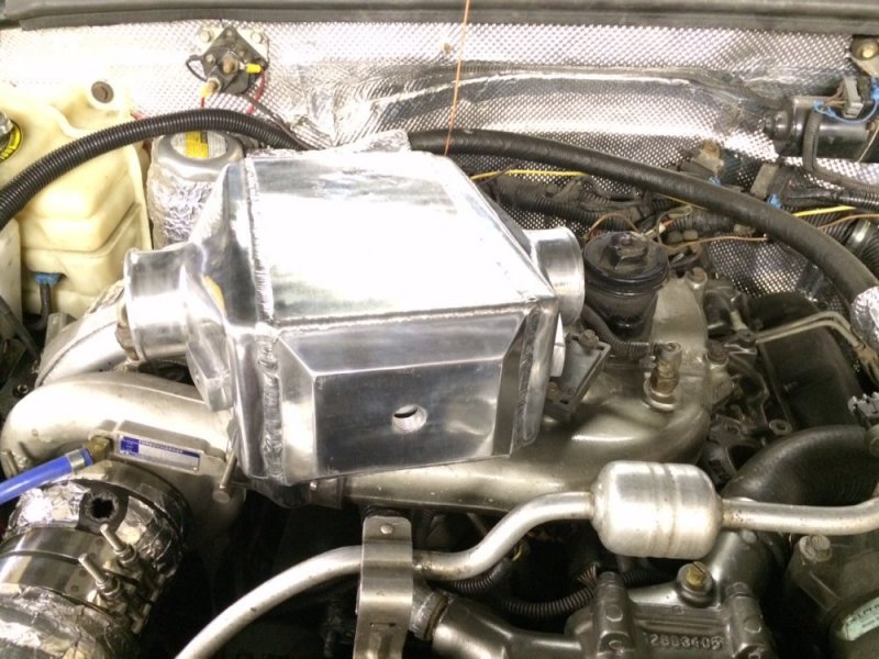

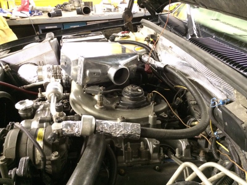

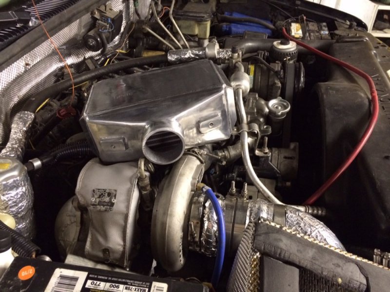

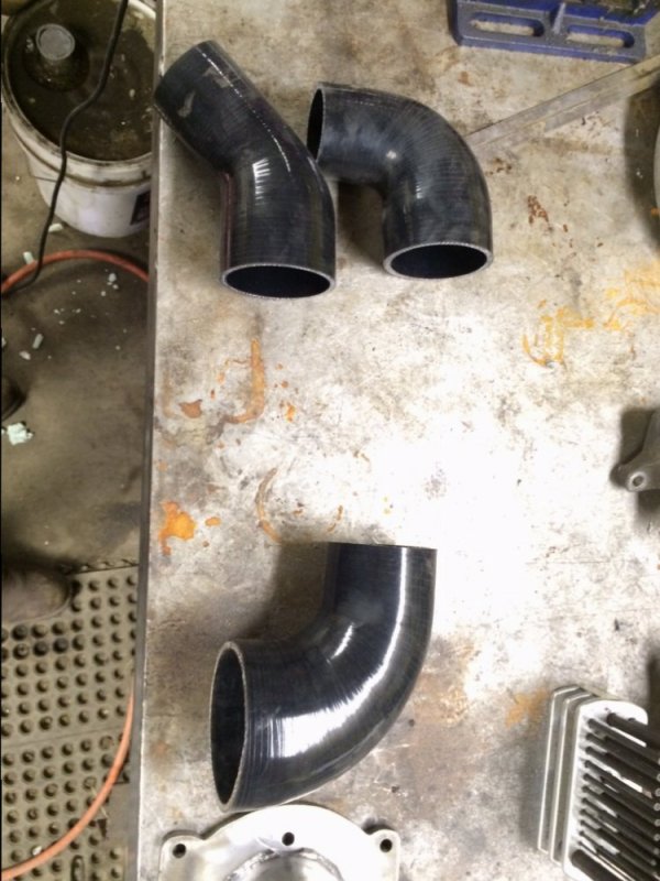

I laid the intercooler on top of the engine so I could start to see how it will fit. I think it's going to fit well with the couplers I have - they'll need a little trimming to get the fit perfect, but that is to be expected. I won't be able to work on it for a couple days due to house projects, but when I do I will post more updates.
