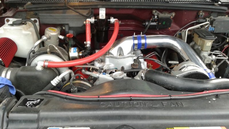

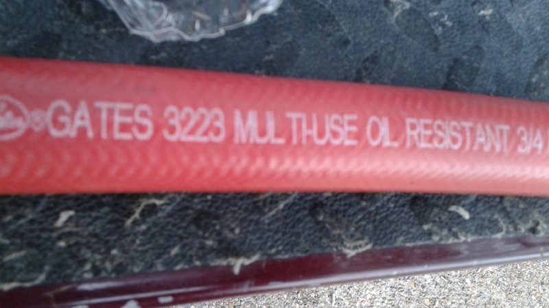

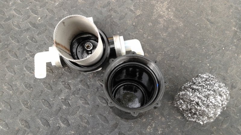

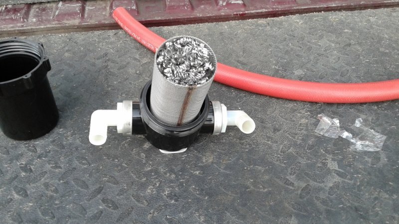

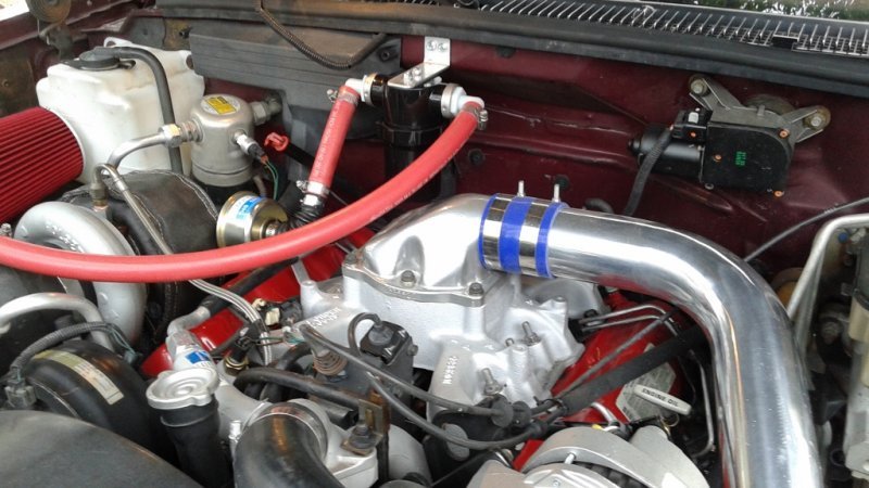

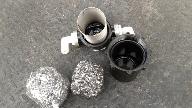

Quick update. My stainless steel scrubbers came in, and I was able to fit 1, and 1/2 of them into the catch can. I figure I've tested this catch can enough to know it works, so I went ahead, and installed the Gates hose on it, in place of the clear stuff. I think I will eventually upgrade to steel fitting, and relocate it under the truck, as its kind of ugly! :D
Here are a few pics.
Matt

So when you opened up the container to change metal was there much oil inside the cup?
I see it looks like its oily in one of the pictures. How about the scouring pad material was it oily?
There was about a teaspoon of oil in the bottom of the cup, and the scotchbrite was oily. This was with 1100 miles on it since the install.
Matt

Update 7/26. I installed this Mod quite some time ago, and figured I would post my findings. My truck won't start , so I am cleaning battery terminals and starter terminals. I had the air cleaner housing off and there was no oil at all where you usually see it. The catch can maybe has a half a teaspoon in it.
Thanks Matt.
Thanks Matt.
Thats great news Rob. I have over 10k on this setup now, and its worked amazingly well. I had to replace the idler arm on my front end a couple weeks ago, which required removing my intercooler. There wasn't so much as a drip of oil inside it. My 6.5 is leak free, and runs great.

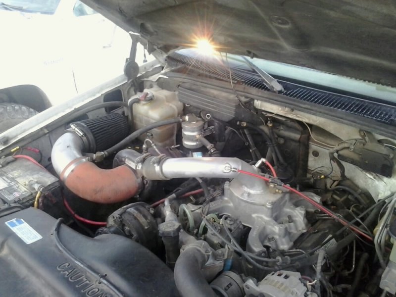

I put this together a while back. Loaded up with some steel wool. Filtered. Not a direct picture of my CRD setup but you can see everything but the CDR. I just used a 90* rubber elbow from a stock setup, and some hoses, and two aluminum quick clamps I had laying around the shop that I welded together. It works. Keeps oil down.
