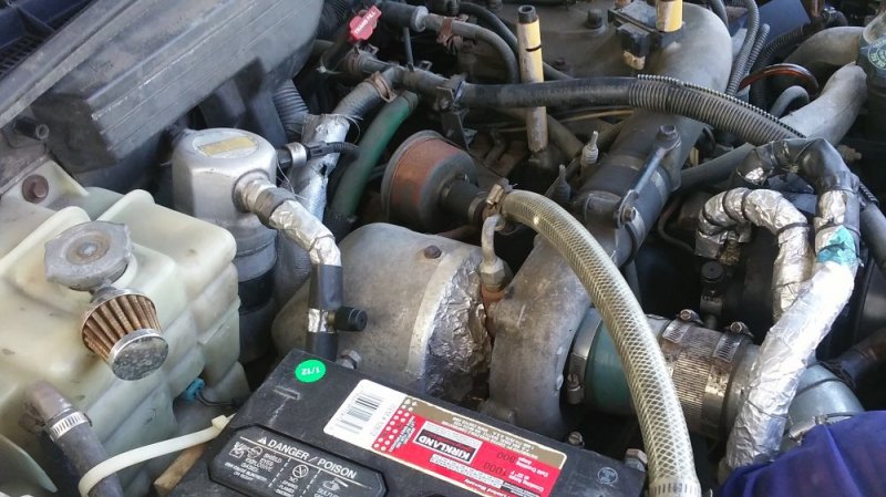

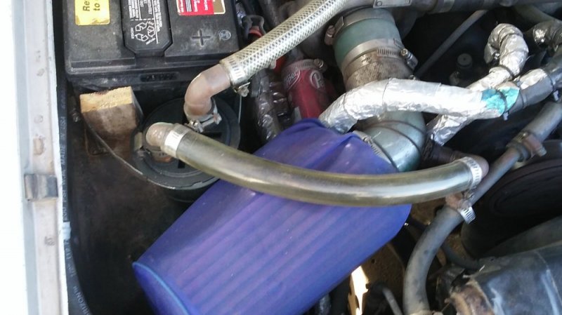

Back on track; Did I mention the oil catch system I made reduces coil consumption, can hold 1 liter, and I empty it when I change oil. Emptied out the CDR, copper fittings, ABS plastic catch can elbows under the air filter in the cold air flow from modified bulkhead and drilled grille.
Off track; The (3) bamboo pieces cover longer bolts and rubber hose to form a level stand for my tool box. The cooling system is Evans Waterless zero PSI, so there's that air filter on the expansion tank. The Dr. Pepper can is open ended and heat shields the TM spring. The Turbo and AC lines are insulated, and so many more tweaks and details...
