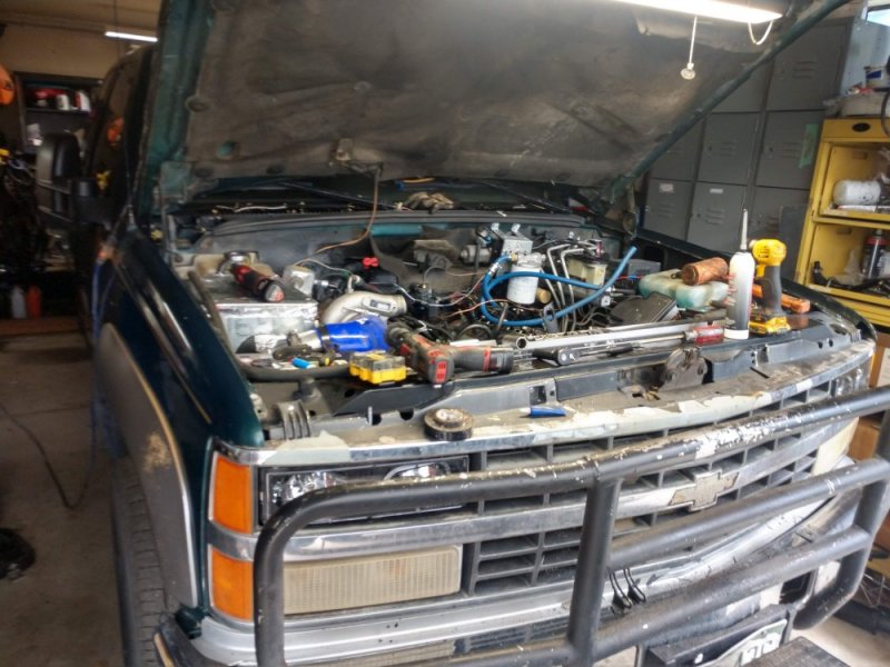

Well i got the pumps switched out. Took a little bit more time than i wanted , so i still havent installed the tci controller. It looks like a nice unit, hopefully it works well. The truck didnt start right away, with the air and having the fuel solenoid wired to a fuse the wpuld drop voltage will cranking.Right now i put it on a switch , but will find some thing that will operate with the key and stay powered up while cranking. Its running rough, with what I hope is just a shit ton of air in the system, and not my screwing up the install of pump/gears. i guess my question would be can you install ip and gears incorrectly ? Like a gasser with the distributor 180 out? Ill run it again tomorrow nite and see if I find any leaks, Put the clear tube on the return when it was first running and it was almost nothing but air. Ill get some pictures posted tomorrow nite.

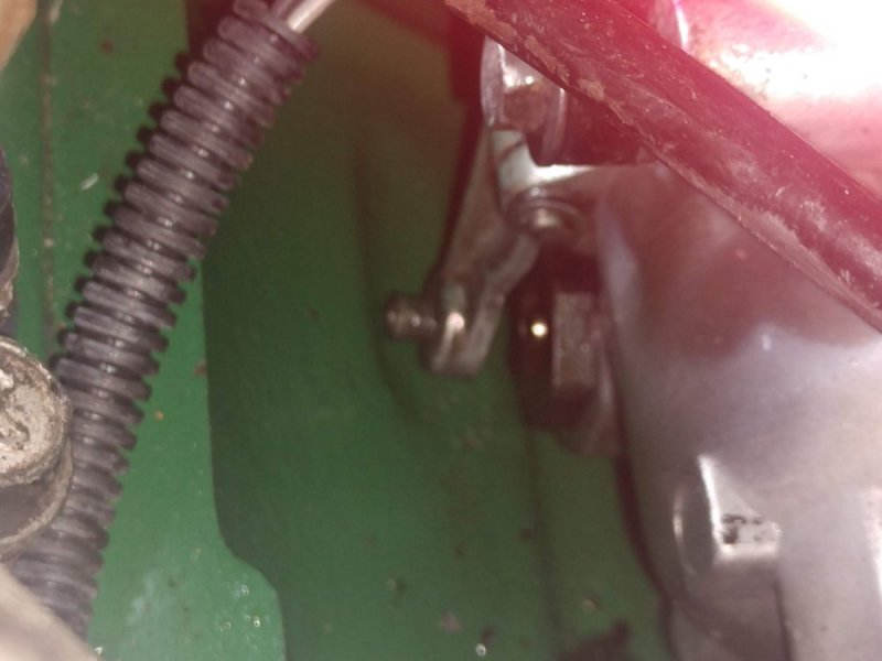

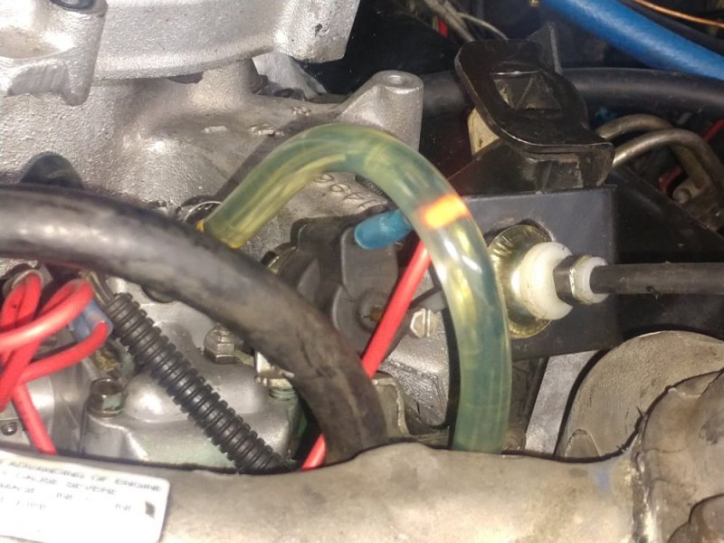

Finally got everything put back together and couldnt get the smoke to clear up. Nice diesel smelling smoke, the air is all gone but still grey smoke at idle. I have double checked the timing gears and they seem good. The one thing i have noticed is that the advance piston plunger appears to be stuck, fully depressed. I havent looked up the fix for this , but with my luck it probably needs rebuilt. The pump sat for awhile and i imagine that old fuel gummed it up. The reason to put the db2 on the truck was that i had it on a shelf, but if the pump needs work it may make more sense to return the trans controller and order a new DS4.
Update. The plunger on the pump was stuck. i pulled it off and replaced the plunger and whohaa and it now works . truck runs great . Except the EZ-TCU is proving to be a pain. i had the tach signal to the alt and at idle it shows 3600 rpms . I have a ESS off my old 93 that may work? But im confused on the wiring . One wire to ground and other to tach signal?It may be that easy, I dont know. Electrical is not my thing. I am a plumber by trade, and even at work we set the boilers and pipe them in and sparky and the control nerds make them work . If we dont turn the building pink we are done. its their problem if it dosent work. So no electrical . trying not to get little puffs of smoke and that awesome smell of cooking something. Is the ess a powered sensor? or will the tach wire just read it spinning? or do you ground it and put some power to it and land the tach wire to the powered wire for signal .
