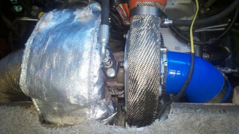

In the 700 miles I've driven it, there hasn't been a problem with heat on the cold side. But, because of that thought myself and in case of other issues, I haven't securely fastened the doghouse cover down yet.
Yes, that thin strip will be so cool you could put your hand on it w/o burns even if it was on the exhaust side.
:facepalm: Maybe it's because of all the door handles I burn myself on all the time in our heat... But seriously I work around the wrapped turbo and wrapped down pipe of mine with the engine running. The AC low side service connection between the air filter and down pipe is the worst. Wrapped it's like a hot blanket rather than a searing hot grille.
Yeah, i can relate...
As long as the floor carpeting stays on the outside of the doghouse when it's bolted down you should be fine, Jody. A layer of reflectix or such on the compartment side of the doghouse would definitely help, too. My concern is/was strands of the floor carpeting hanging out from, or trapped, under the edge of the doghouse and into the compartment anywhere near the turbo/exhaust. Many of those synthetics have fairly low melting points as you well know.

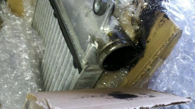

When I get it back, I want to install the intercooler that I have. I got one from a GM van with a Duramax. It should fit nicely. The next upgrade from there will be the water/meth kit that's sitting in the box waiting (for a couple years now).
