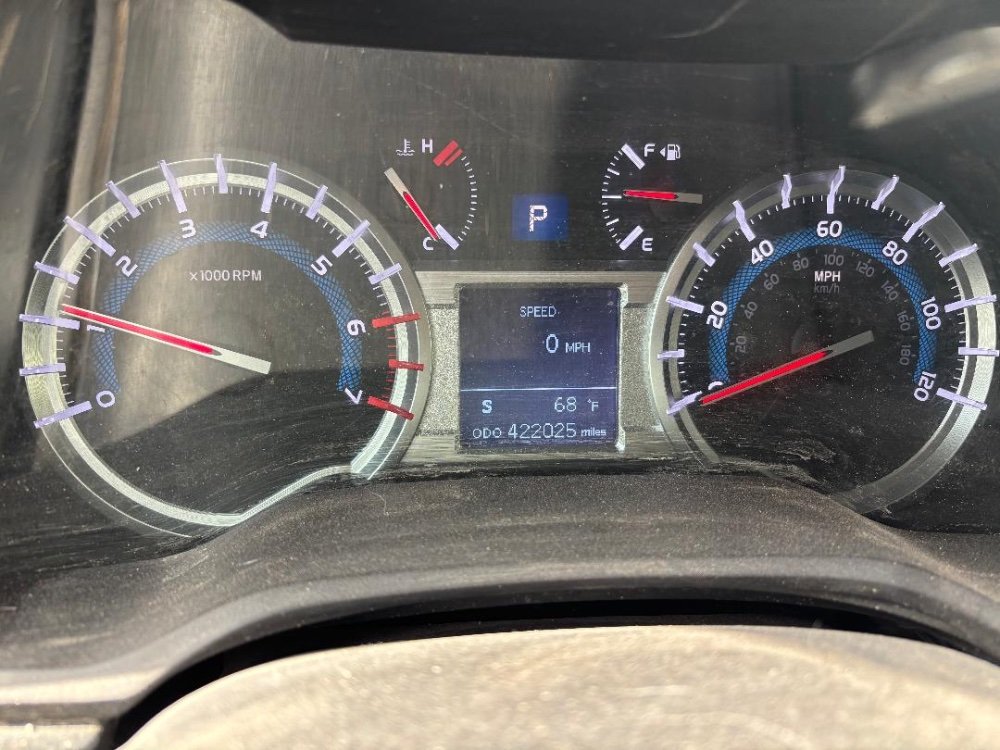

My wife is down here in Fullerton for a follow-up medical appointment with her retina surgeon (all is good, eye is doing well after cataract surgery). She drove her 2014 4Runner “Priscilla” and I rolled it past 422K miles yesterday. Engine runs like new, same mpg, no oil consumption or leaks. Couldn’t ask for a better car.
