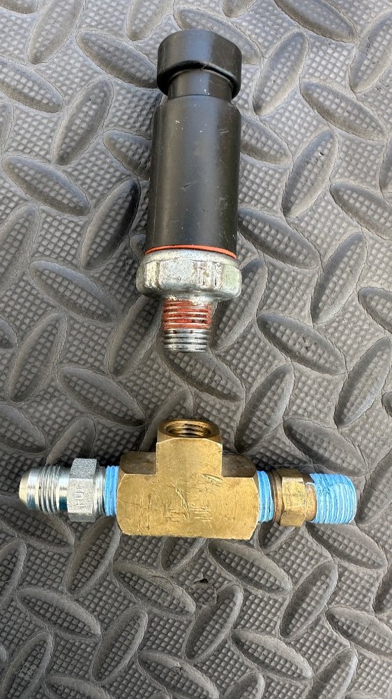

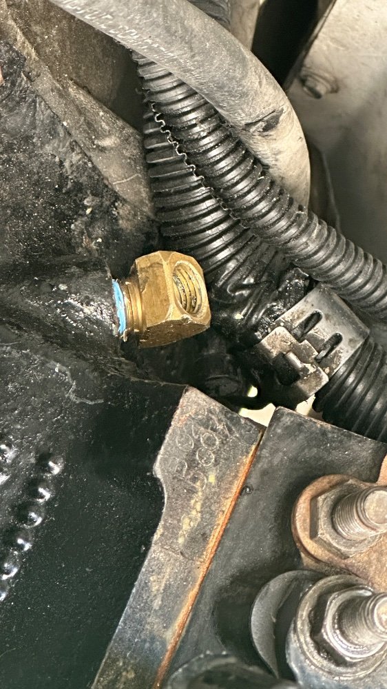

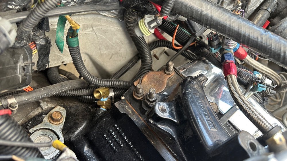

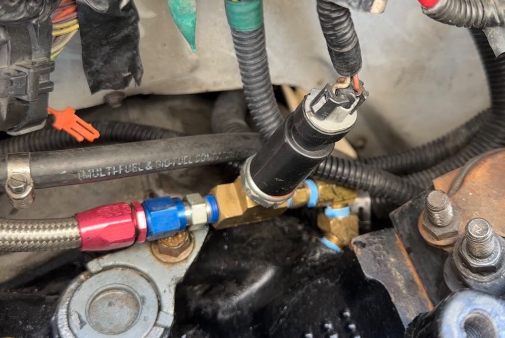

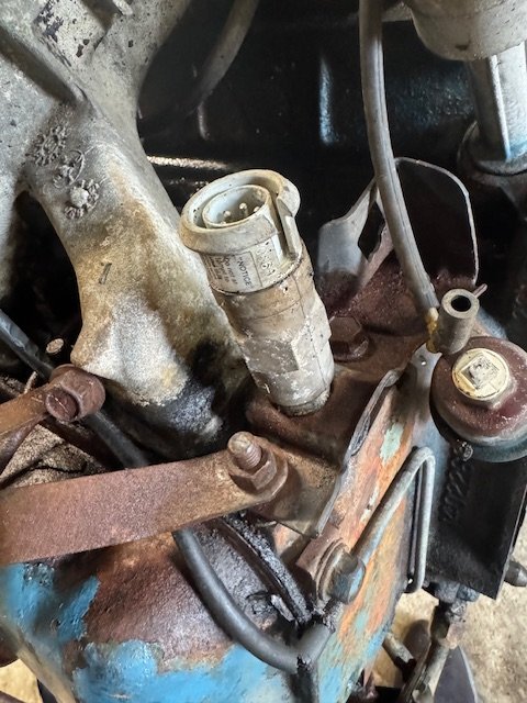

My engine is a 6.2 N/A 599 block bored 30 over. 6.5 heads. Mine didn’t have ports for either the OPS in the valley or front of the block for turbo oil feed. If the one you’re looking at is the same, you’ll need to make a T-Block fitting for the OPS and Turbo Oil Feed line using the oil port at the back of the block. I used brass to ensure proper ground for the OPS.
