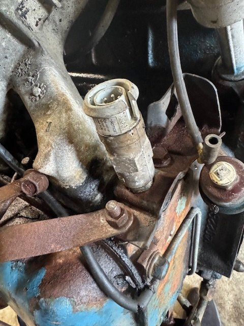

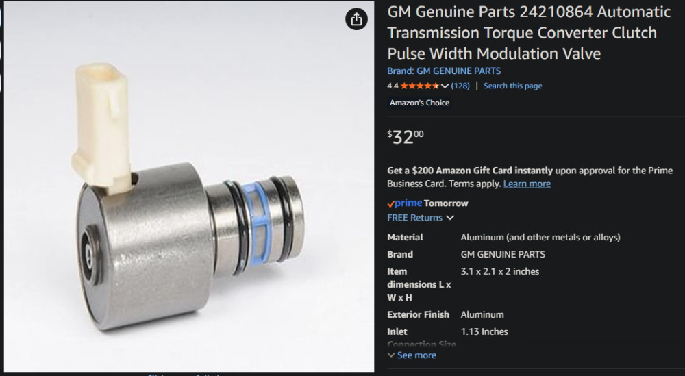

I found out this doodabber is a glow plug controller! never seen one like this animal before. part number on the sticker is 15575722. looking online it's a GM part. wonder how this thingamig works.

That is what gm used for sensor connectivity before the weatherpack.

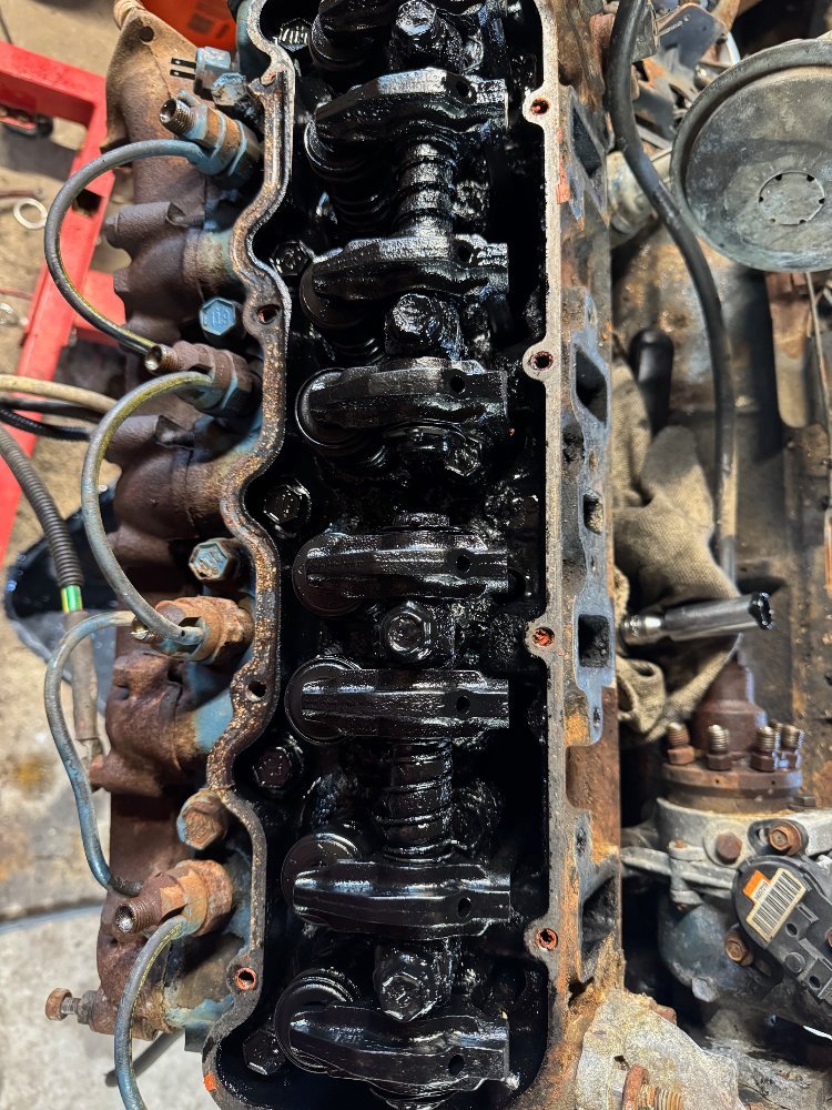

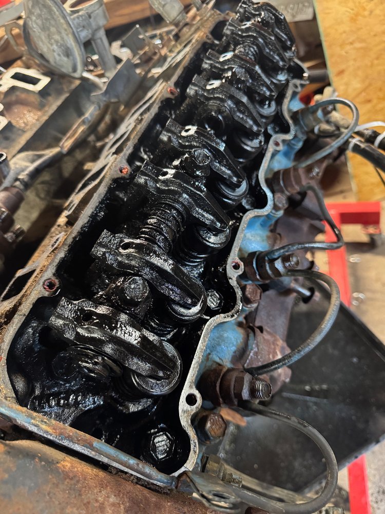

If you didn’t already- spray a little oil into each cylinder with wd40 can and straw to go through the precup via glowplug hole. This will help those rings that sat so long.
Then on your engine stand rig up the starter and let her rip through several revolutions. Once you know all the oil is out - compression test time.
