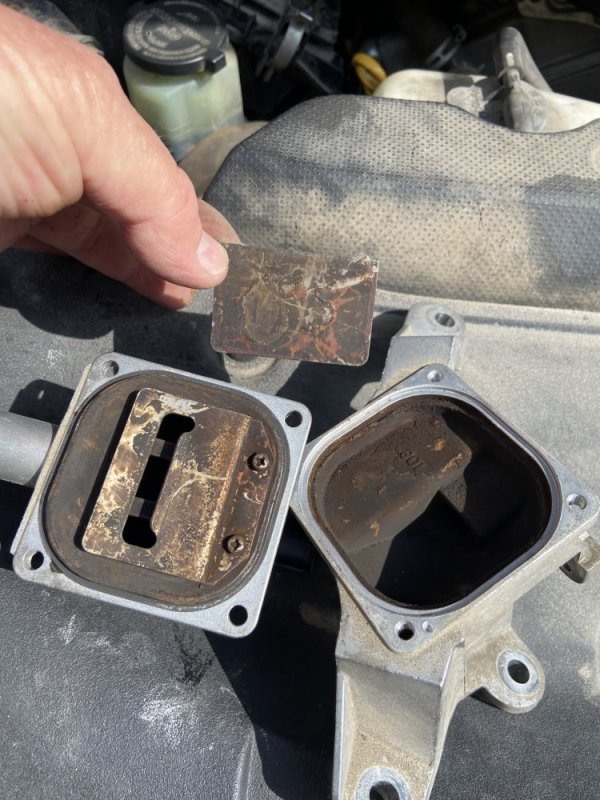

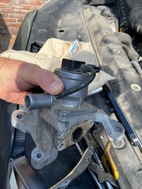

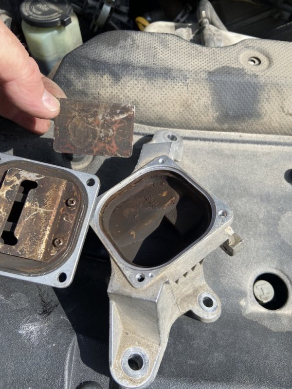

Not my GMT-400 K2500 Suburban, but my wife’s 2014 Toyota 4Runner SR5. Trouble shooting DTC P2443 Secondary Air injection Valve Bank 2 Stuck Closed. This part allows fresh air to be pumped in on cold start ups to clean up the exhaust. There’s a valve on each bank of the V6 engine. Intermittent code throwing after changing the spark plugs at 260K miles. During that procedure had to remove the air valve from its mounting points and lay it on top of the intake manifold. Trouble shooting says to first inspect the plug terminal on the valve for bent pins. They were fine, but while flipping it over I heard a piece rattling inside. So I split it open and a piece of spring steel fell out and it clearly had broken off. Think I found my problem. $341 worth of parts on order and arriving Tuesday.

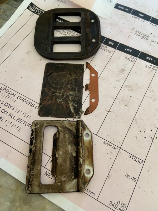

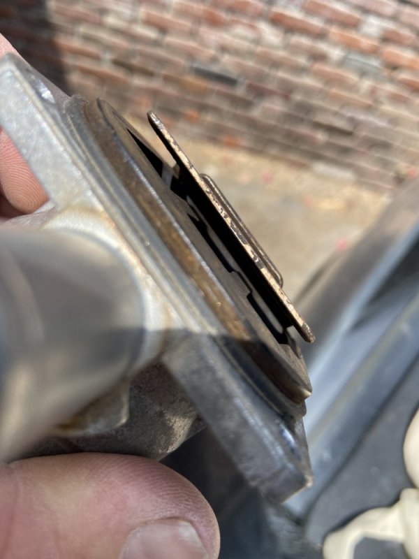

I took further disassembled that Toyota air valve. The two screws sheared off as the ends were mushroomed to prevent removal. Found exactly where that plate broke off. Although we have a paid for valve on order from Toyota, I bet I could rework this by scavenging parts from a used one.
