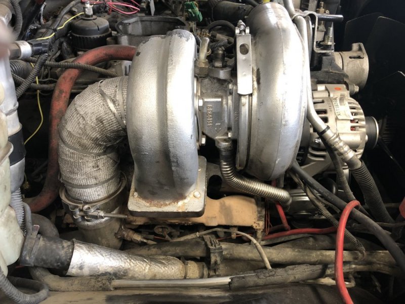

if in the valley area, could it be the OPS or maybe valve covers? I deleted my FFM and went with a firewall mounted fuel filter. with that out of the way it's easy to see in the valley. mine is a 95 but I'm not sure if the 93 has the OPS in the same position, but it's much easier replacing that vs a rear main seal!been awhile since i’ve posted but I still own the 93CCLB. the 96 was parted out but I saved the engine.
