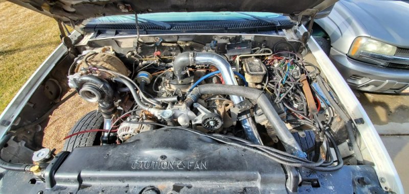

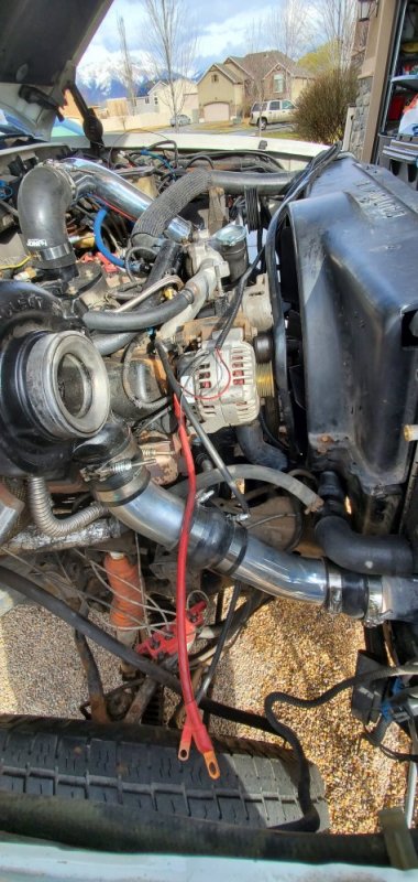

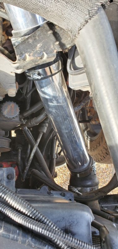

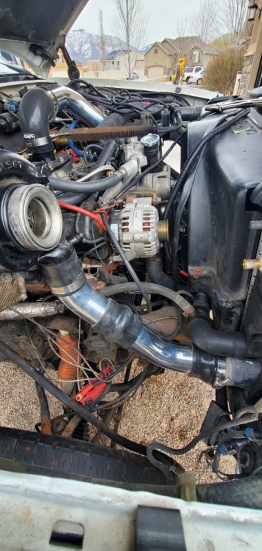

You couldn't clock the compressor outlet housing from 3 o'clock to 6 o'clock so it was pointing down, and then mandrel bend the angle to match to the outlet and a couple of silicone flex connectors from the IC inlet to the bend and the turbo outlet to the bend? That's the way the ones I've seen have been.
No, the way it sits that oil drain tube is in the way. I just ordered a longer flex tube, so I'll cut the hard tube down and route the new hose around so I can clock the compressor outlet down. I'm kicking myself for getting rid of the front exit compressor cover I had.
