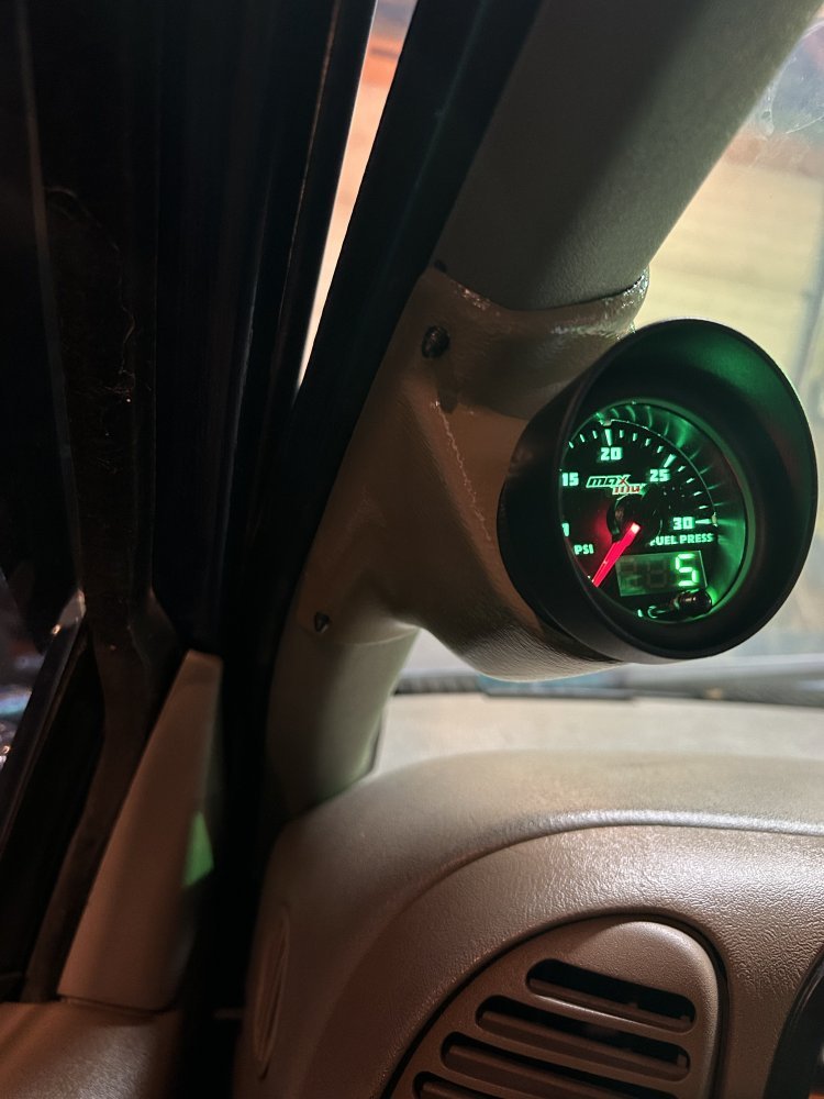

I’m also using two fuel filters which perhaps is causing a lower output with the primary being 14 micron and the secondary a racor 2 micron.With that said I still need a much better lift pump anyway.I hear good things about the carter P4601 but what do you guys recommend these days?Also in my last post it’s supposed to read 9psi with key on/engine off.Many thanks in advance.

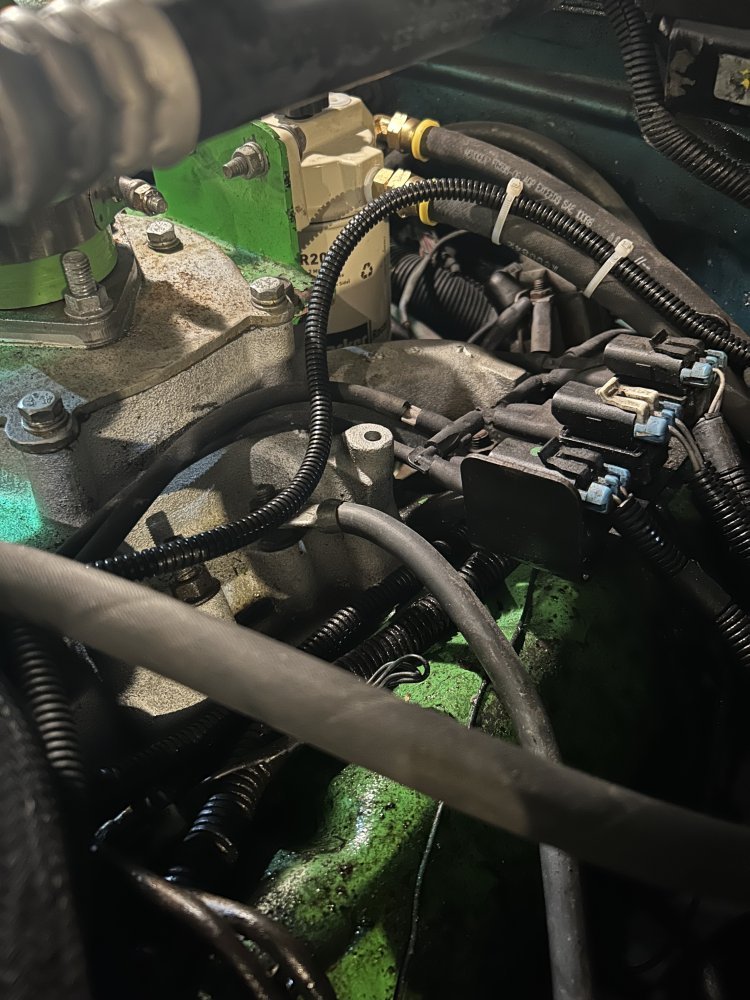

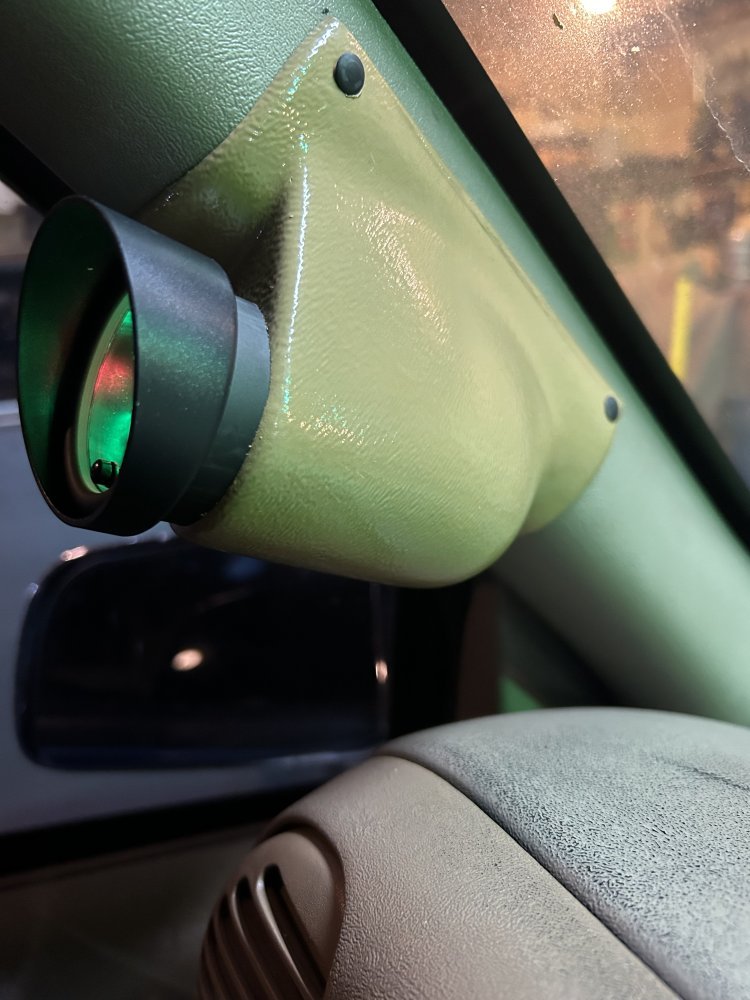

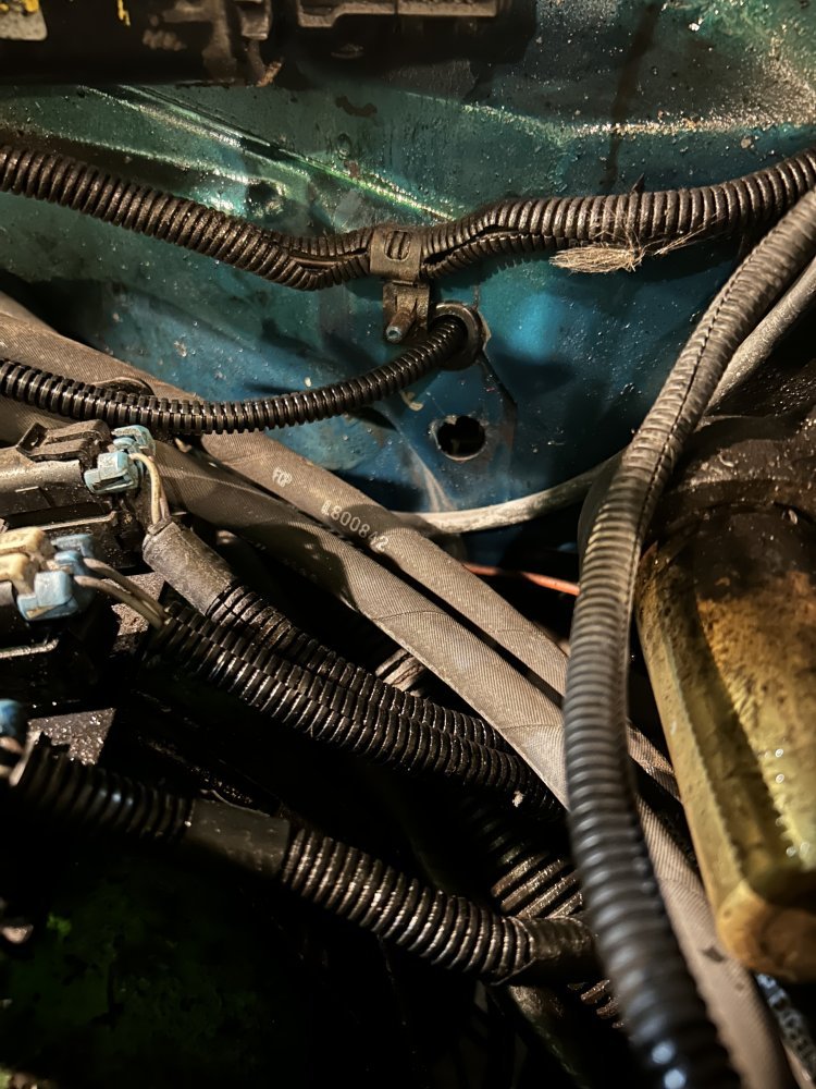

Here’s the finished product from earlier.All painted up and good to go.There was a couple holes in the firewall to begin with so I used one of those with a grommet to prevent chaffing.Just a matter now of upgrading to a better lift pump.I was told the raptor is really good so I’ll definitely look into that.

Sure that’s not a problem.Basically the lower intake is from a F code engine so no EGR passage to worry about.This truck used to have EGR but I wanted the F code intake instead.I kept the solenoids plugged in and capped off the vacuum line that used to go to the EGR valve.
I bought a 3 bolt stainless steel flange from eBay and traced out the top part of the plenum and cut the steel plate with a plasma cutter.
I’ll take a few pictures of it tomorrow and let you have a better look at it.
