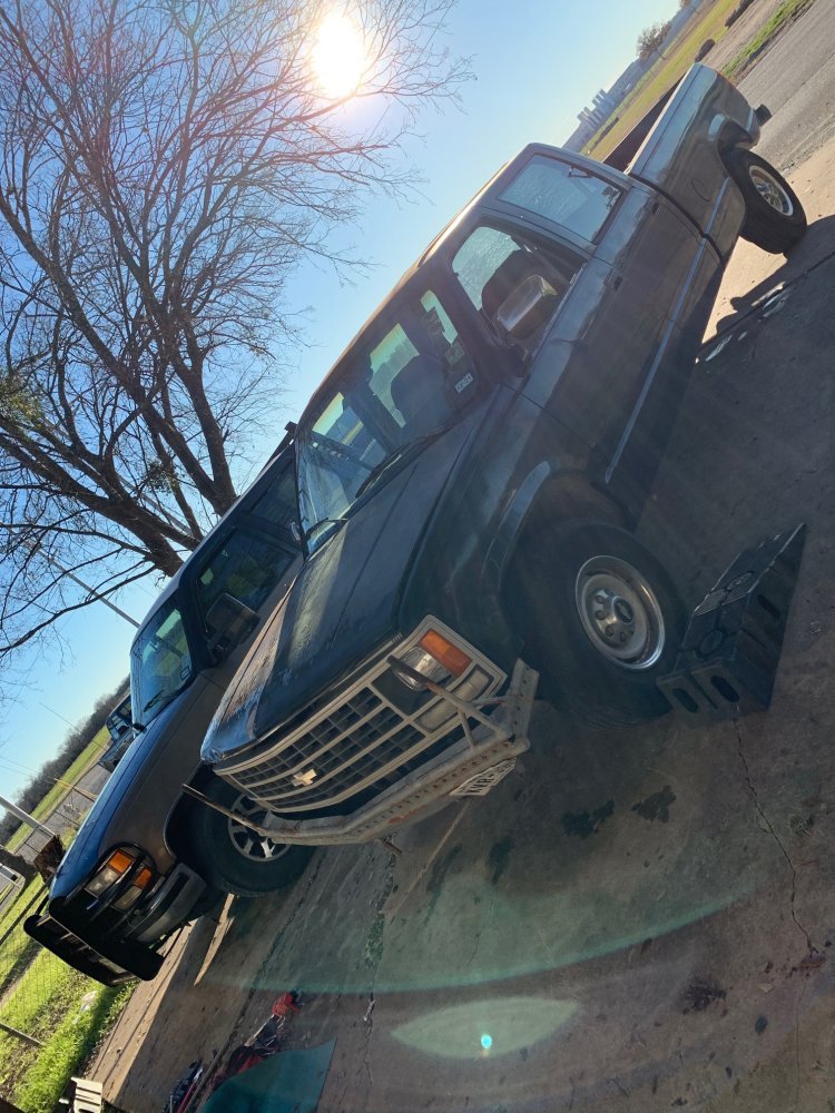

Well I think I'm on to something. I did some toying with the 93 today and discovered something...
I noticed that when the trans is in park or neutral the speedo goes up to about 10-20 mph and when you put it into drive or reverse the speedo goes to zero. this got me to thinking.... I bet the speed sensors are connected backwards. I slid under the truck and just disconnected to front speed sensor, put the truck on stands and tried it. Speedo no workie but it still shifts hard. disconnected the rear sensor and connected the connector from the front to the rear sensor, now with it on the stands, the speedo works but no shifts.
I think the speed sensor connectors were plugged in backwards from the get go and then he tied into the wrong sensor wires for the trans controller. I need to talk to him more and see where in the harness he tied into the speed sensors for the trans controller. This way I can switch to the correct one.
