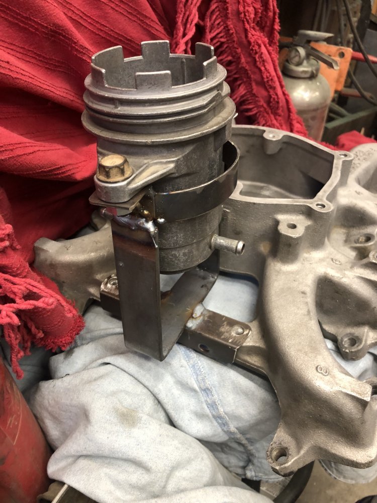

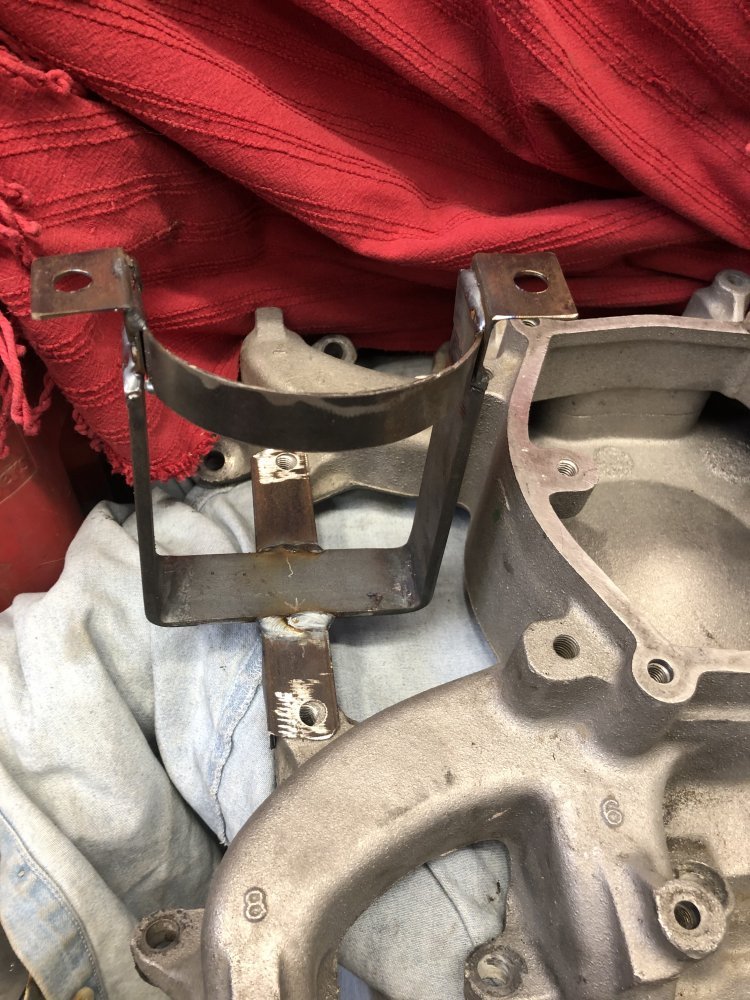

Started building a bracket to lift the FFM so that the fuel hoses will be over the intake manifold.
I seen how another person did it in another forum but Incant rememer that forums name.

I just used metric all thread
I thought about using metric all thread, called NAPA and they had none, Oriellys has it in stock, even headed to the parts store and got almost there and then the thought about all the scrap metal setting in buckets in the garage I’ll complicate things and build something. 😹😹😹
Setting the FFM in a raised up position above the mounting bolt holes of the intake manifold, I kind of like it turned 90* and the bleed and IP feed hoses coming off towards the left side of the engine.
I’m also planning a T fitting feeding the FFM. Barb fitting two of the T in/outlets and then a sender unit for a fuel pressure gauge in whichever one is left.
The heater rod in My FFM is swollen and has a split. Shopped around for a heater. About $175.00 was about as cheap as I could find for a A/C Delco unit. Got on Leroys site and got the entire FFM with heater, WIF sensor and the feed the beast kit for right at $200.00.
And so I’ll be looking for a heater for the old FFM and maybe have a spare or, set it up for the feed the beast and pay it forward to someone thats in a worser financial crisis than I am. 😹😹😹

Got a mounting, for the FFM, sort of rigged up.

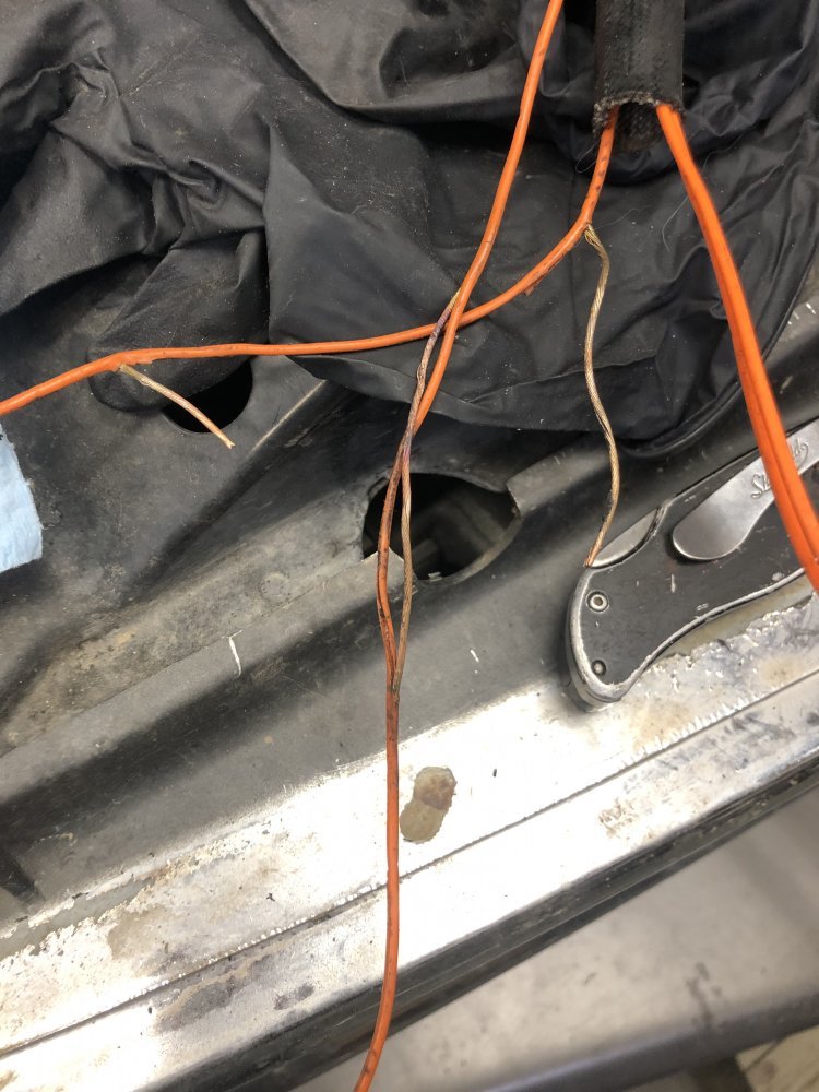

And then there is this mess. Thought about building a new kne but then got into Leroys store and just got His new and improved unit on the way.
I will check continuity through to the eyelet on all the wires. Makes me wonder if at least one of the fusible links is burned out.
Your bracket looks good. you might concider adding an extra brace to bolt onto that extra threaded hole behind where the intake horn mounts just to prevent the whole apparatus from vibrating.
Thought about making another tab that could go from the forward bracket bolt to the upper intake manifold rear center bolt.
