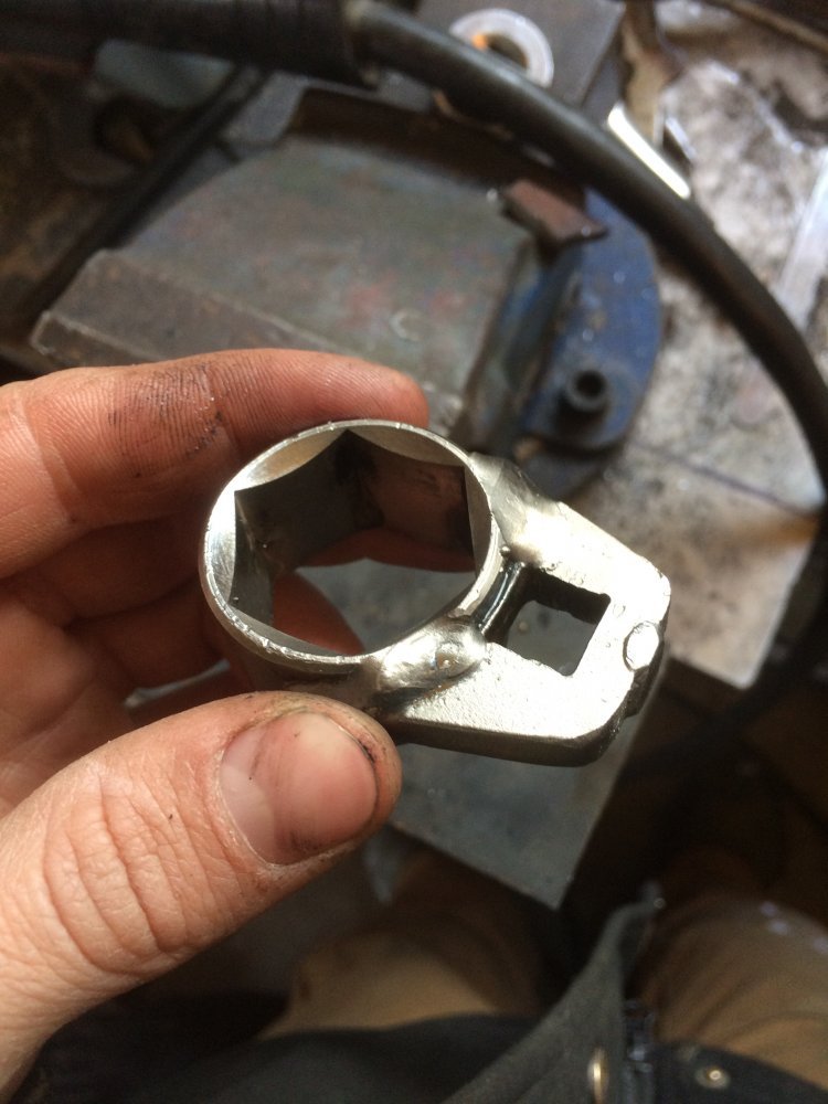

I read those will destroy the sensor upon removal, not sure I could install an new one with that tool. What say you?
I would say installation with that tool would be tough.
I'm guessing that installation would involve installing a T in the mix.
I believe there's 2 ports by the oil filter location.
When I did my first engine oil bypass filters, I used a port near the engine oil cooler lines.
I believe it was a 5/16 square female plug. 5/16 square male on the socket to get it out. I remember making a socket with a piece of key stock.
Still have it in my tool box
Yeah I’ll check if I have a spare 1 1/16” 6 point socket I can cut up and modify instead, just gotta get the wood stove fired up in the shop. Took the day off to try and get this sorted out.
If it all goes well I’ll just borrow the fuel pressure gauge setup I put on the Ram; grease gun hose, gauge, and snubber valve (though the valve is unnecessary in this application) and T the pressure sensor off of the grease gun hose in a better, more accessible location. Will probably have to ground the sensor somewhere too...
You'll need a 12 point socket. if there is an auto parts store nearby you'd be better and faster to run down there and snag up on the special socket. their price isn't too bad. even if there is a harbor freight or one of those cheap Chinese tool stores .

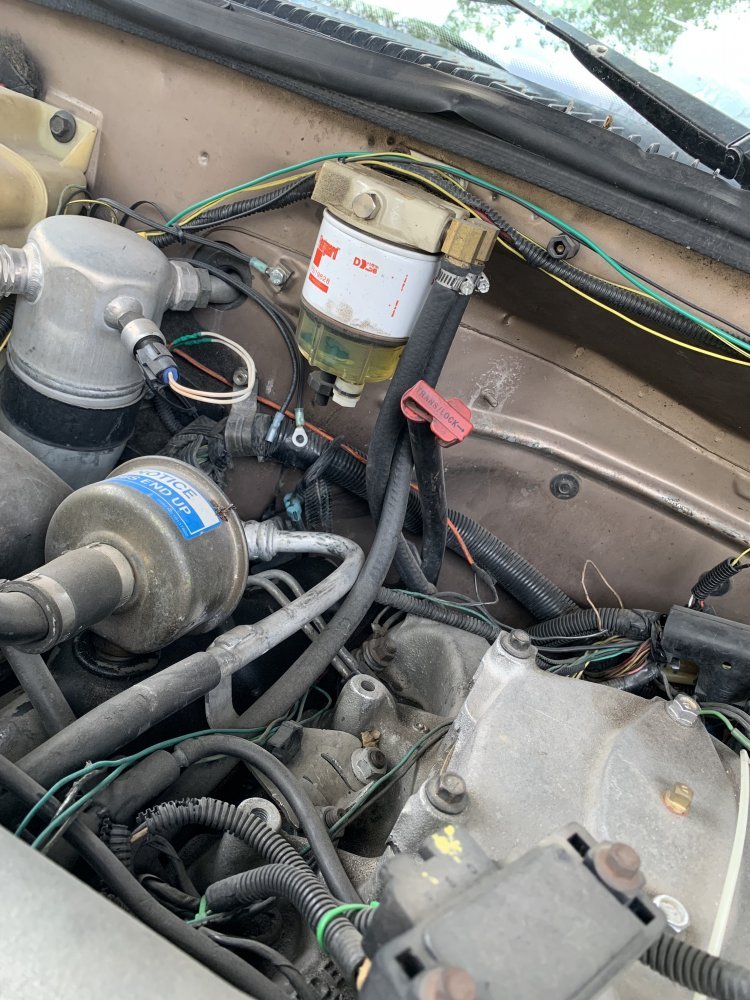

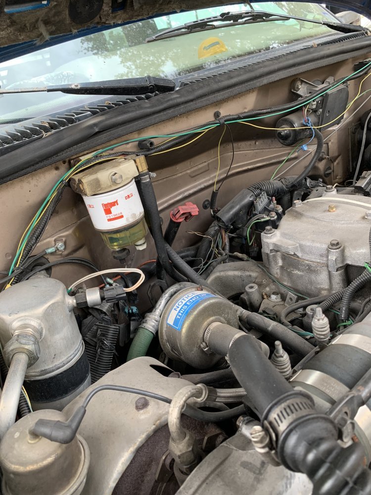

@J_dude if your climate allows (doesn't get cold enough to need a fuel heater) you can do the remote mount fuel filter on the firewall and eliminate the FFM completely. when I pulled my intake to address the old fuel lines and do my valve cover gaskets, I installed this fuel filter on the firewall up by the trans dipstick tube. ran my fuel hoses over the top of the intake so they weren't down under there in the heat of the engine valley and are easy to get to in the event a leak happens. Plus the added benefit of easy access to the OPS too!
I will try to post up a pic of how I have mine mounted. the down side is I don't have the sensor anymore that lights up the WIF light. (water in fuel) but it's easy to open the power barn to have a looksee every once in a while :happy:
the clear bowl does have a threaded provision to install a universal WIF sensor if you would like to keep the dash warning light.
Everything I read says 12 point will just round it off anyway.

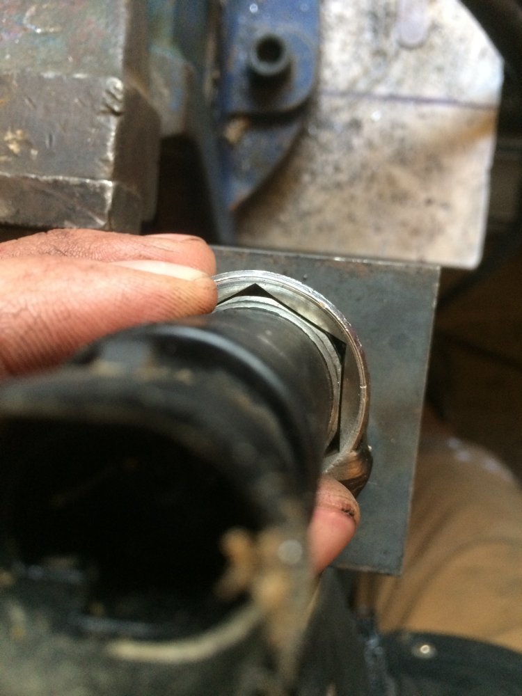

Too late! Already built my “special tool”. Don’t look at my welds! 🙈
Just waiting for the thread sealer to cure and then the hose and gauge setup is going in, had to run to town and grab a couple fittings though.

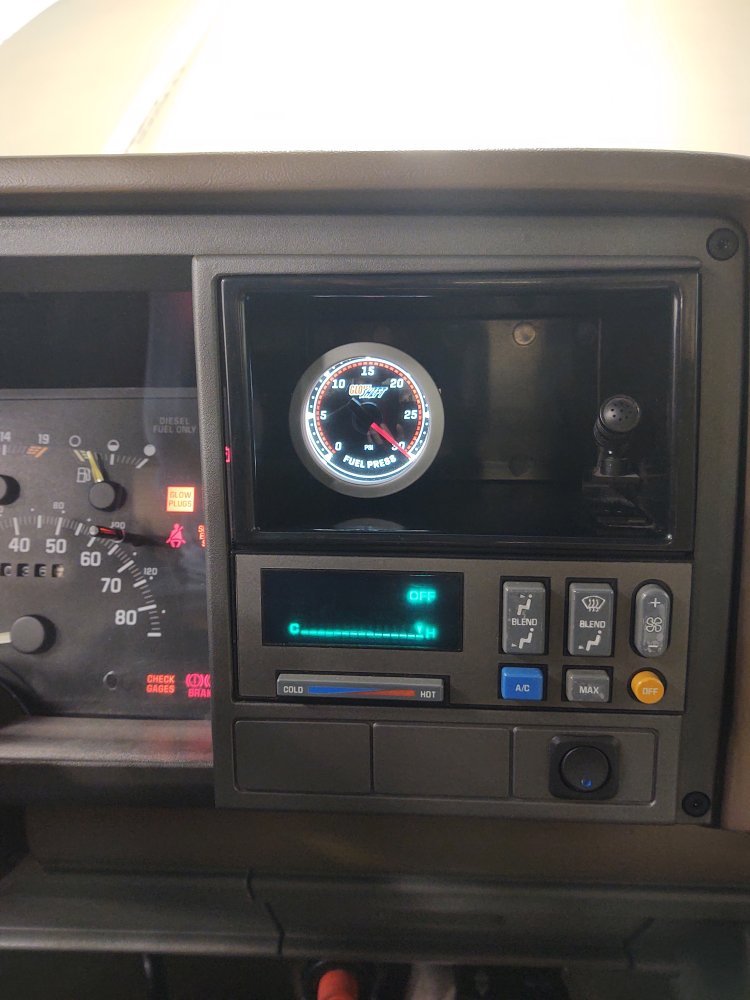

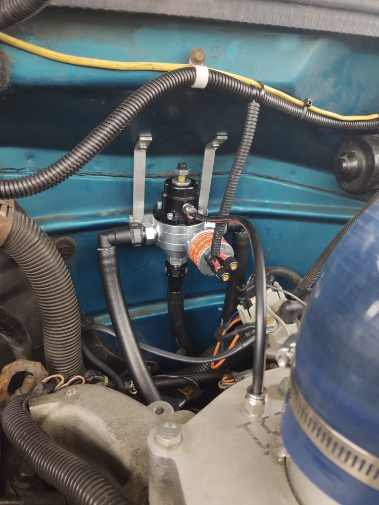

I just eliminated everything the factory put on the truck for a fuel system. Pressure gauge is pegged because I didn't have it hooked the the regulator yet. It idles at 7psi.
