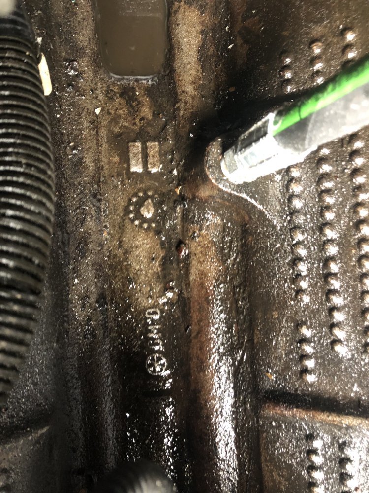

FWIW, I looked on another site’s thread and the OP had a picture of the same markings. Neither the OP or Contributors referenced it.
And here I was hoping for some kind of an IH symbol, besides the two triangle looking things.
