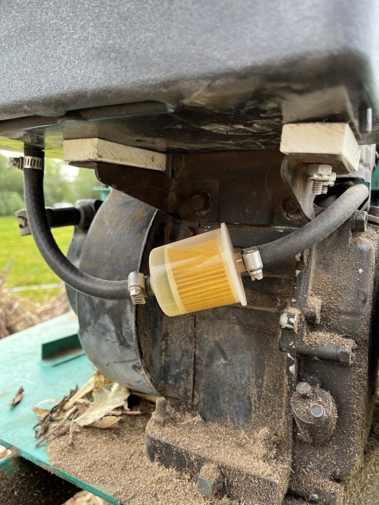

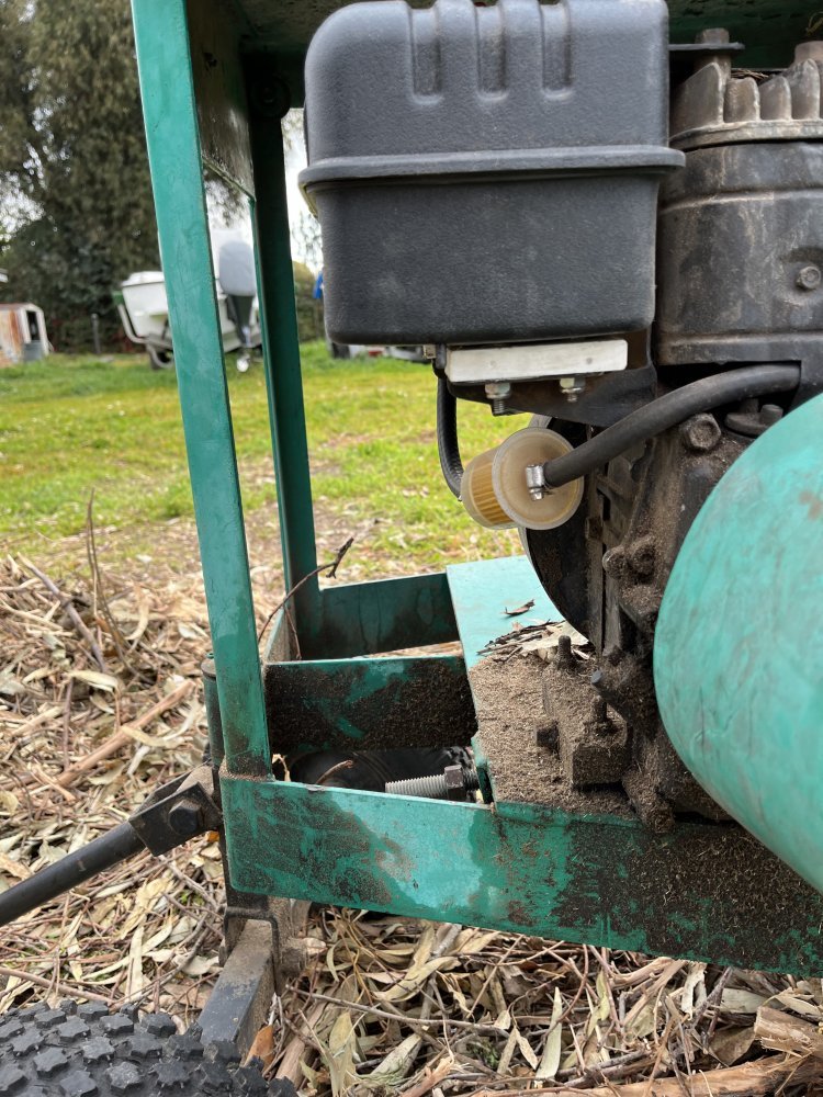

I used the supports from the original bracket under the tank, adding marine poly board as spacers, which worked. Pics tomorrow.
It looks like that bolt hole through the bracket might be bout a 1/2 a bolt hole off.
If it was Me, I would not be fearful of die grinding the bracket enough to get a bolt through that hole.

Been using my neighbor’s chipper which quite easily could be 50 years old. It had a steel fuel tank which he had zip tied to a bracket on the engine. Of course those broke, so I used large screw clamps for HVAC ducting and those broke too and knocked off the glass bowl on the fuel filter attached to the tank. It had been glued in place with a grey sealant. The tank does not have bracket mounts attached to it and I did not want to weld some on.
So it was time to go a different route. I ordered a Polyethylene tank and bracket for an 8 hp Tecumseh engine (chipper has an 8 hp Briggs & Stratton). Engine side of the bracket was a close fit, I had to egg out one hole to make it work. I cut the original bracket and use that as a pedestal for the bottom of the tank. I used the chipper most of the day to finish up on the slash from the Eucalyptus tree. Tank did come off once. Engine imparts quite a bit of vibration. Just need to check the screws on the tank side of the bracket every couple hours.View attachment 79917View attachment 79918View attachment 79919View attachment 79920View attachment 79921View attachment 79922View attachment 79923View attachment 79924View attachment 79925
Looks like the same setup as the Briggs on my log splitter, you’ve probably got it under control already but if you want I could get you pics of the original tank mount bracket/clamp system. I’ve never had mine come loose.
