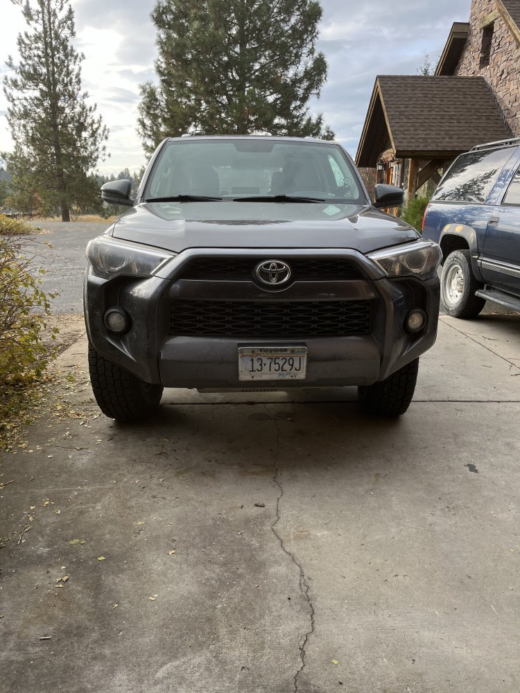

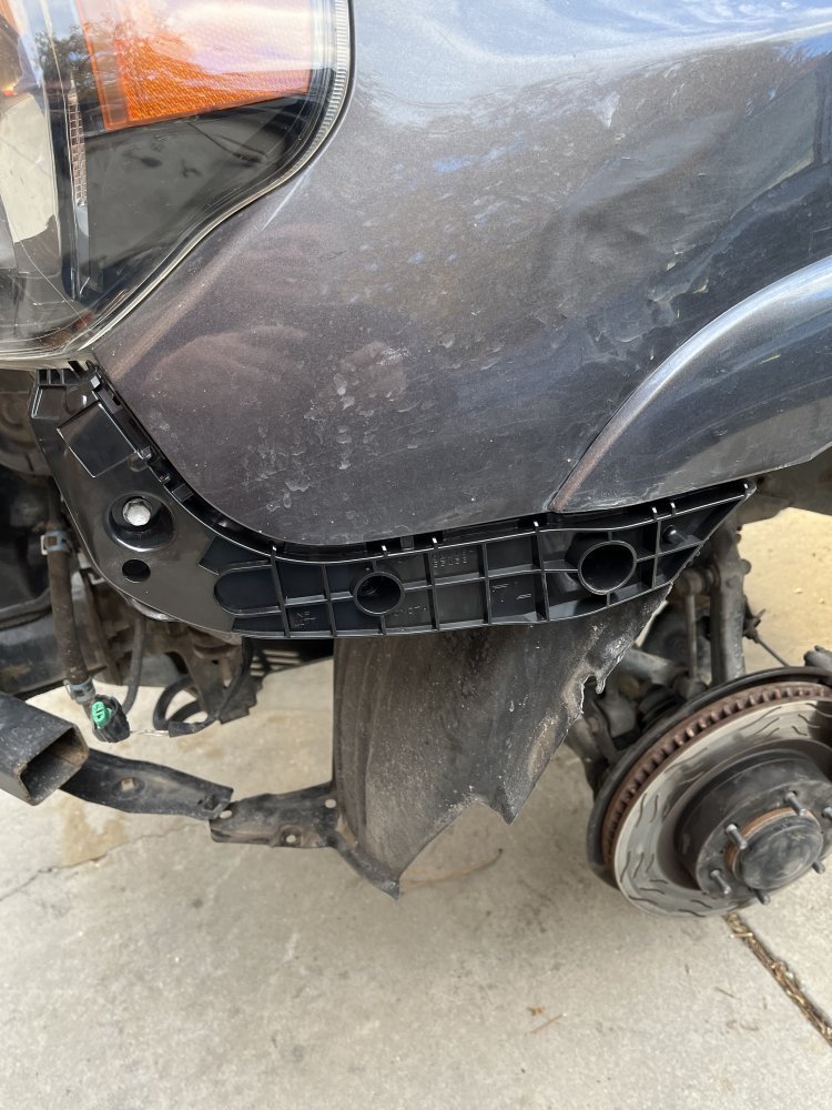

Not my '99 Suburban, but it's smaller cousin the 4Runner. Something rattling/rolling in the rear hatch when lifting it. Handle was loose. Figured nut had fallen off. Pulled the interior cover (becoming expert at this stuff) and found a flange nut in the bottom on the driver's side. The other nut on the handle was barely on the stud. Got everything tightened up and put back together. Took about 20 minutes.

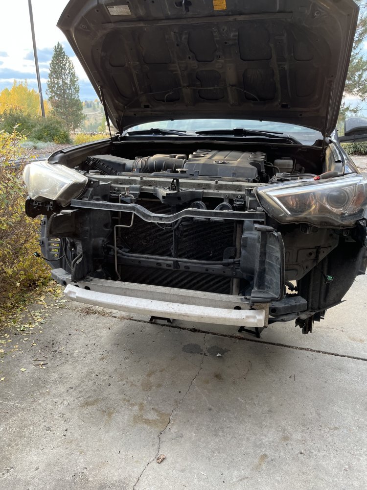

Next up, pull the front bumper cover and replace the brackets with upgraded brackets per Toyota TSB. Then head down to SoCal with a stop in SLC to get some sutures pulled.

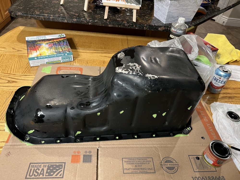

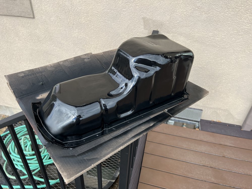

Identified a cracked ear on lower intake so, cleaned up an older, non-extrude honed, lower intake manifold and an oil pan for engine reassembly. Intake was powdercoated so need to do anything. Old pan...long story. replacement unit had some rust on the outside and bare metal so it got sanded down, POR-15 applied, primed then top coated. Packed up and shipped off to WA where the work is being done by an adult.IMG_6343.JPGIMG_6348.JPG

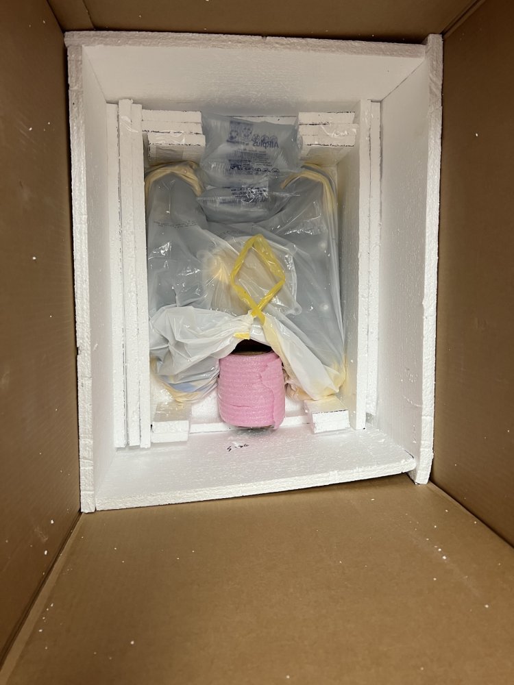

Lower intake packed in securely.
A foam board was placed overtop.
Oil pan was secured to cardboard, placed on top of the intake's foam then bubble wrapped.
More foamboard and box was cut down to fit, folded, taped up and UPS'd outa here.
