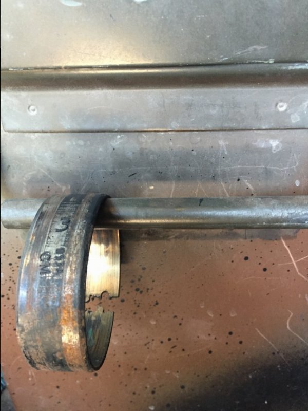

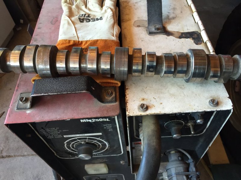

Cam bearings in an optimizer are GM bearings and suck. No idea who makes them for GM. This is 70,000 miles ish with proper oil changes.

Yes that was an optimizer can. The rust is from sitting, note center (#3) position.

Will, did any antifreeze get in the oil? Mine had 250k miles and were like new.
None. The main and rod bearings had wear, so I swapped them also but could have reused them if I had to.
Do you know what cam bearingsyou had?
My oil pressure had fallen only by 5 psi when hot only. I really only knew about it because I was drilling it the block for the oil passages for the center mount Gm6 turbo- the cam has to come out for that.
Anyways, put in all new bearings while your there.cam, main and rods. I wish I knew which brand to recommend, but idk.
Head bolt cost vs arp studs is a gamble of if you have to pull the heads 1 time then arp is cheaper. Definitely felpro head gaskets. Gapless rings is your budget. I would do new timing chain, old gears. New rocker buttons.
I have no idea on bearing brand, they are originals from a 95, 141 block.
I was going to replace them but no one in town had a cam bearing installation tool, then a heavy duty mech. friend of mine said he never replaces them? The bad block made it a mute choice in the end.
