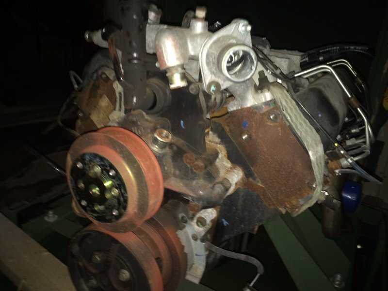

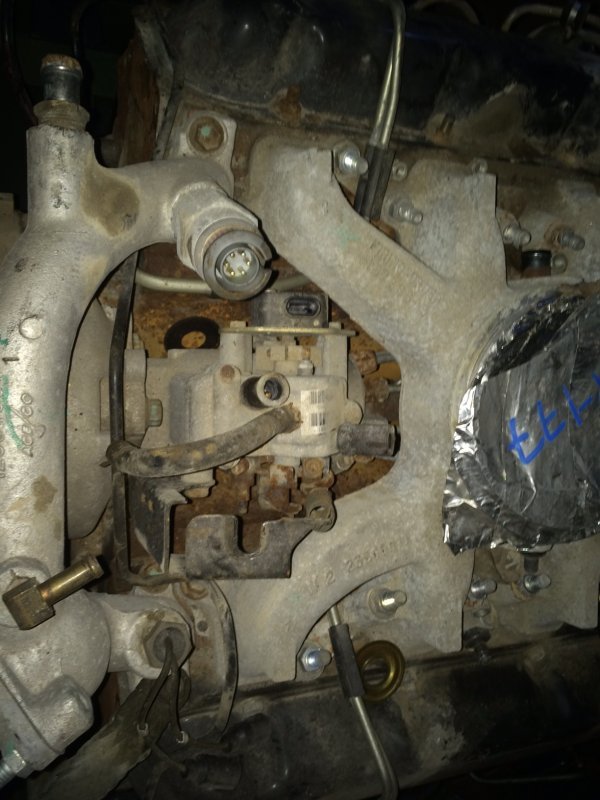

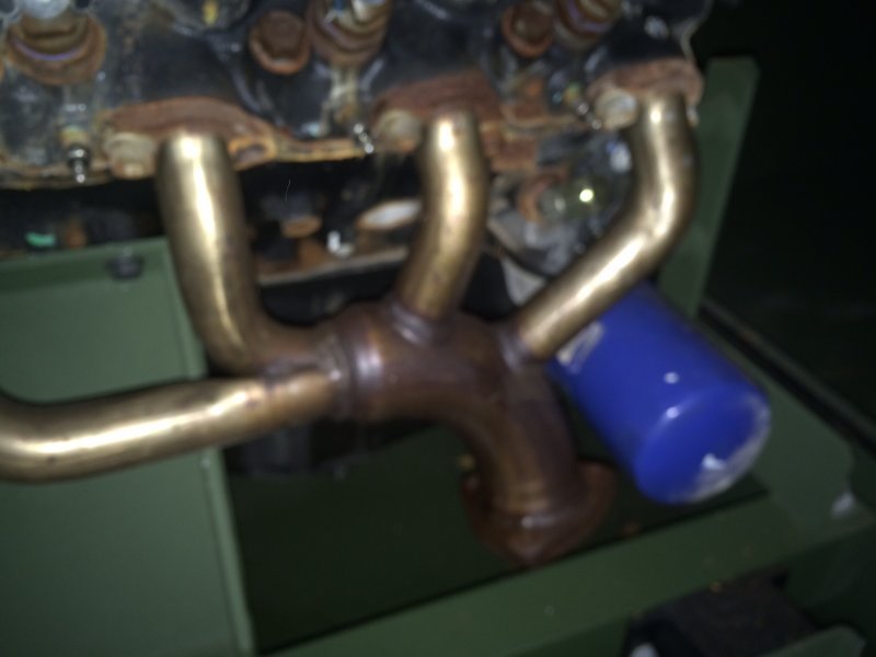

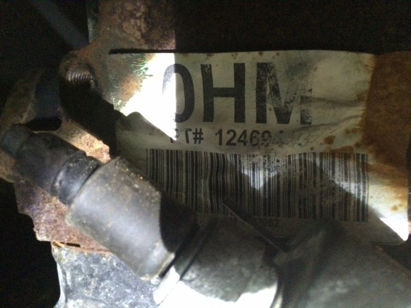

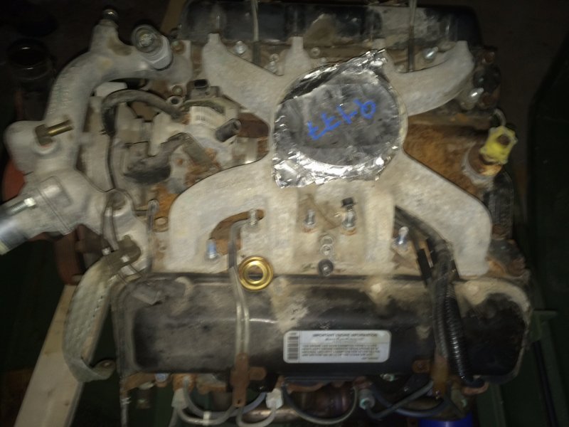

I finally got to check the engine out last night.....there's a diamond in the valley!!! I'm picking it up tomorrow for $900 :D. I'm cautiously very excited. I wasn't too excited when I first saw it because it wasn't very pretty - I was expecting something that looked like what Ted's sells, but I suppose this is pretty much what his engines look like before he does his cleanup job on them. Come to find out, the owner of this engine was a partial owner in a military surplus business that used to be in Kalamazoo (I used to drool every time I went by there because they had a parking lot full of deuce-and-a-halves). He said at one time they had about 50 6.2s and 6.5s and this is the last one. It's still sitting in the steel crate, but the lid was removed. He said it's always been inside and periodically he has turned it over to keep it free. He said many people bought these engines and reported they were pretty inside when opened up. All his word, I know, just reporting what he said. It does turn over by hand, so I know it's not seized. It looks like the heads are new on it because they have stickers on the ends of them and they didn't have paint on them, while the block has paint on it, so I'm guessing it was either inspected or rebuilt before new heads being put on. Obviously it has suffered a little from condensation, but hopefully the insides were still sealed up well enough. After I pick it up tomorrow I'm going to tear it down to see what I have for sure. I know it's worth the money one way or another, so I'm not worried about that, I just don't know if it will get used now or not - it could run the gamut of a block that needs to be bored and everything needs to be reconditioned to a short block that has all new bearings with proper clearances and all it needs is Leroy's gapless rings and new gaskets. I'm guessing it's somewhere in between...and only one way to find out. Here are some pics I took, sorry about the poor quality...it was dark in the garage and then once I found the diamond I was just taking pictures, not really paying too much attention to what I was taking them of because I was actually in the presence of an Optimizer! I will post more pictures once I tear it down. Opti1.jpg Opti2.jpg Opti3.jpg Opti4.jpg Opti5.jpg

I know!! I feel like I went from zero to hero in a week! We'll see how lucky I was once I tear it down. Oh yes.....there will be pics :)

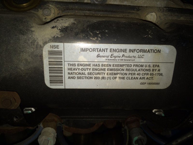

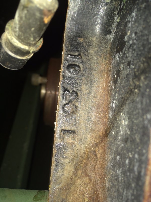

10 20 L. Is date of manufacture, but I can't remember the code. I think Missy had it listed, but I can't find the thread.
Yeah good news rules!! I was thinking that the "10" was 2010, but did they make NA engines in 2010? Not too worried about that. I'm mostly hoping it's an ugly duckling that's real purdy inside. We'll find out tomorrow!
