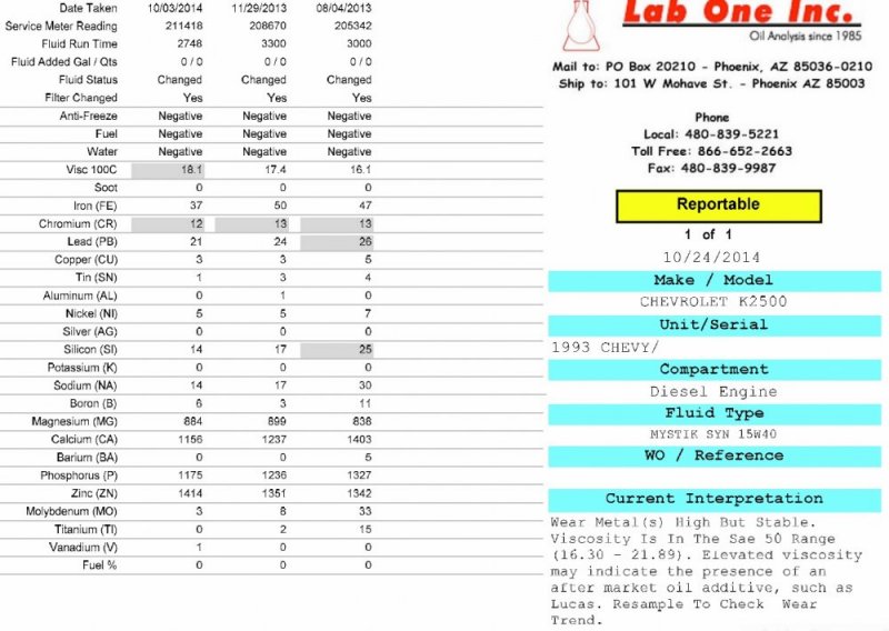

4 years later: UOA for Gapless rings.
Note I started running 15w-50 in the engine so the lab was confused. Stepping up a grade is normally oil wearout/failure.
Silicon is from the make a gasket in a tube I used on the engine. When that trend spikes I know there is a air filter or intake issue.
Using many different oil brands (bad idea) so this makes seeing a trend harder.
