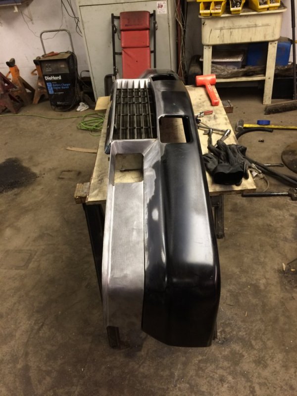

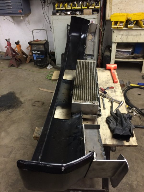

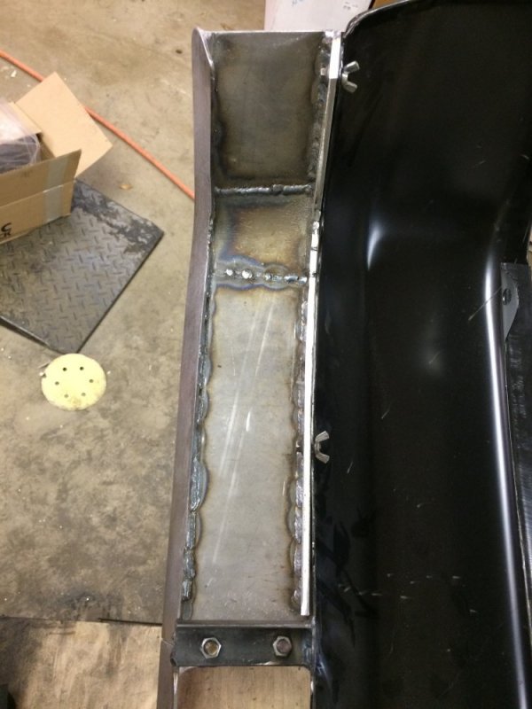

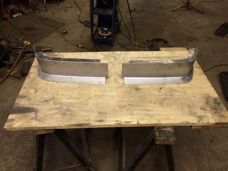

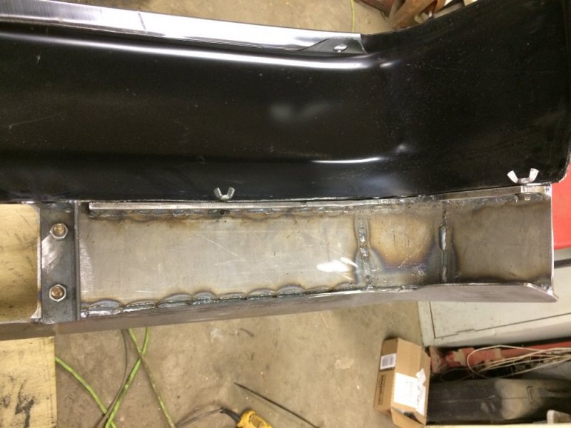

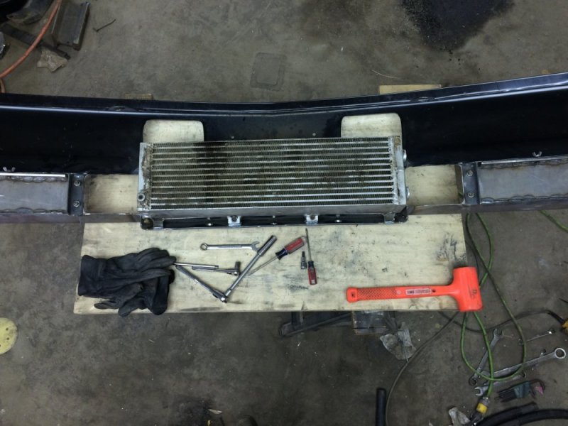

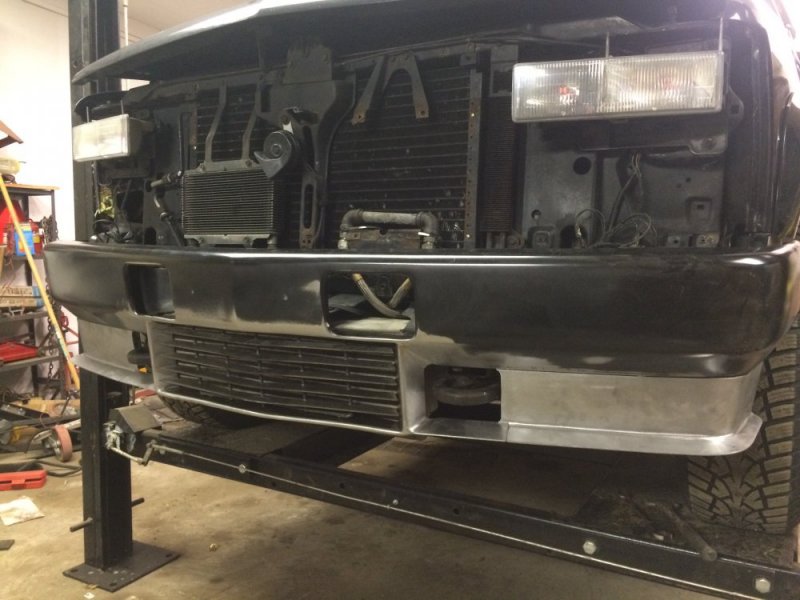

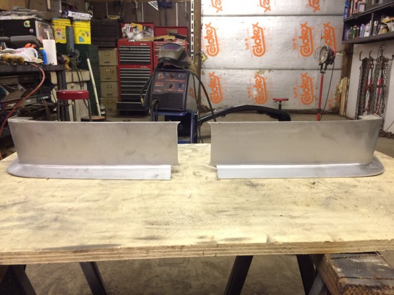

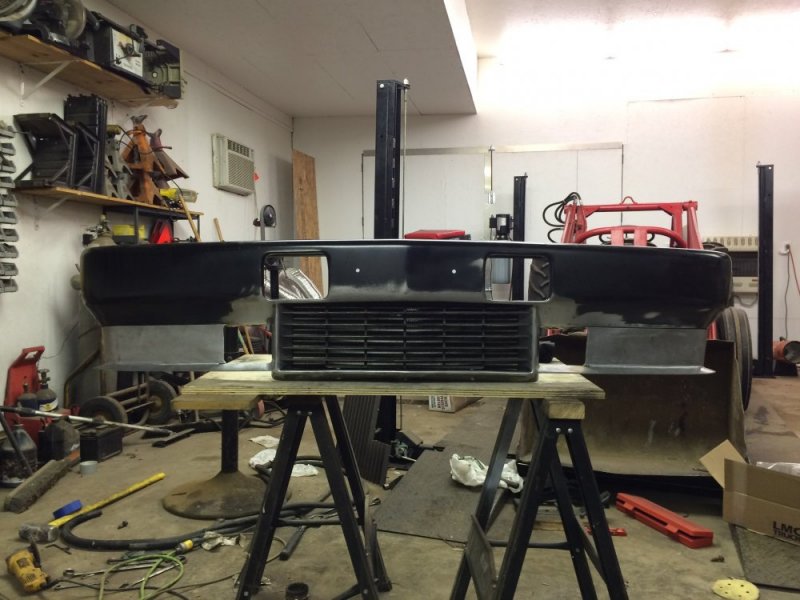

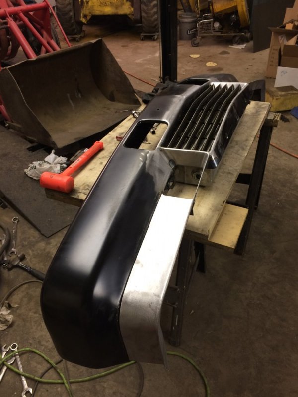

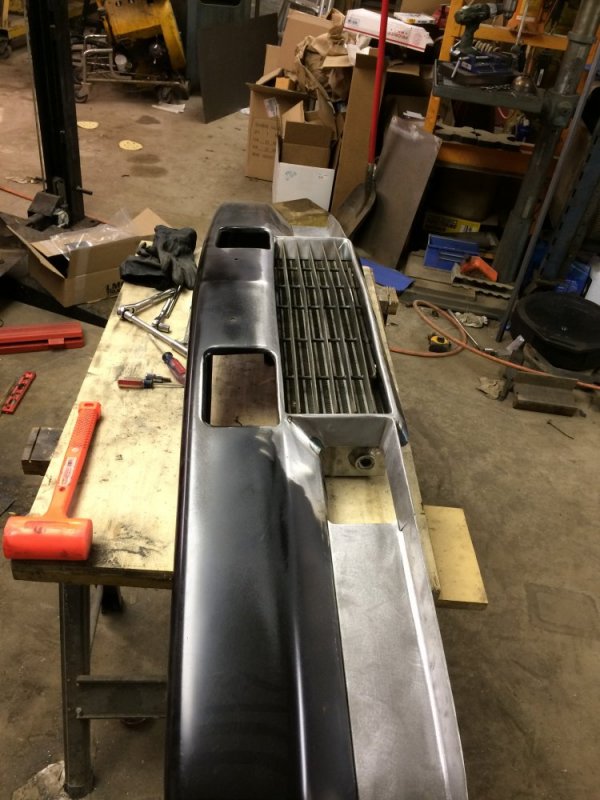

I got the hook openings trimmed out today. I also added the fasteners for attaching them to the hook opening supports. I cut some all-thread to make 3/4" long studs. Then I drilled through both pieces. Finally I plug welded them and ground them smooth again. Totally hidden. Now everything is DAd smooth. I have put everything back together so tomorrow I can reinstall the bumper and work on the braces at the bottom. I have decided to also make some connectors at the bottom of the hook opening to better tie everything together - for both strength and to make sure everything stays aligned. My hope is to have all the fab work done this weekend so I can take everything to the blaster on Monday. Oh by the way, the wing nuts are just for mockup purposes. IMG_7990.JPGIMG_7991.JPGIMG_7992.JPGIMG_7993.JPGIMG_7994.JPGIMG_7995.JPGIMG_7996.JPGIMG_7997.JPGIMG_7998.JPGIMG_7999.JPG
I've wanted to do something similar but with air to air. whats always held me back (besides time and money :) ) is the pipe routing.
Yeah, that was one of the factors that steered me to water/air. If I could just shove an air to air out through the hood, that would be the best of all worlds. :D;)

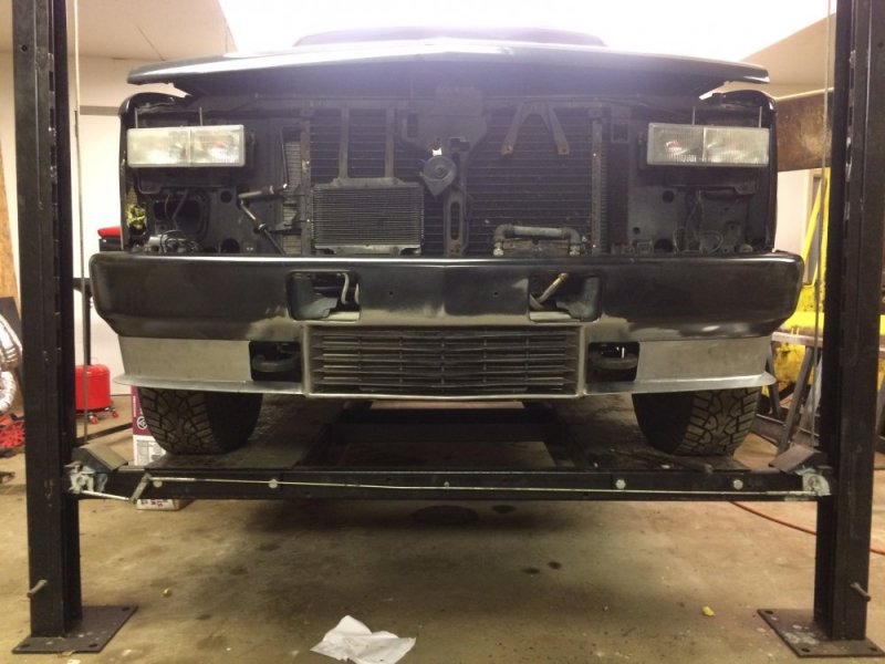

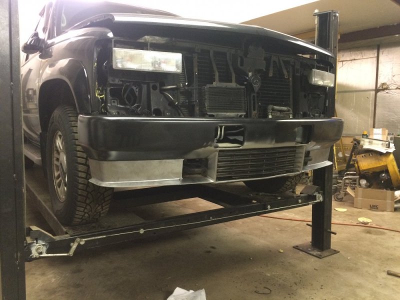

I just got the bumper reinstalled and I love how it looks so much that I just couldn't help posting a couple more pics. :D:snaphappy::snaphappy: I like the black and silver together - kinda makes me think of Dale Earnhardt's old paint schemes. IMG_8004.JPGIMG_8005.JPGIMG_8006.JPG
