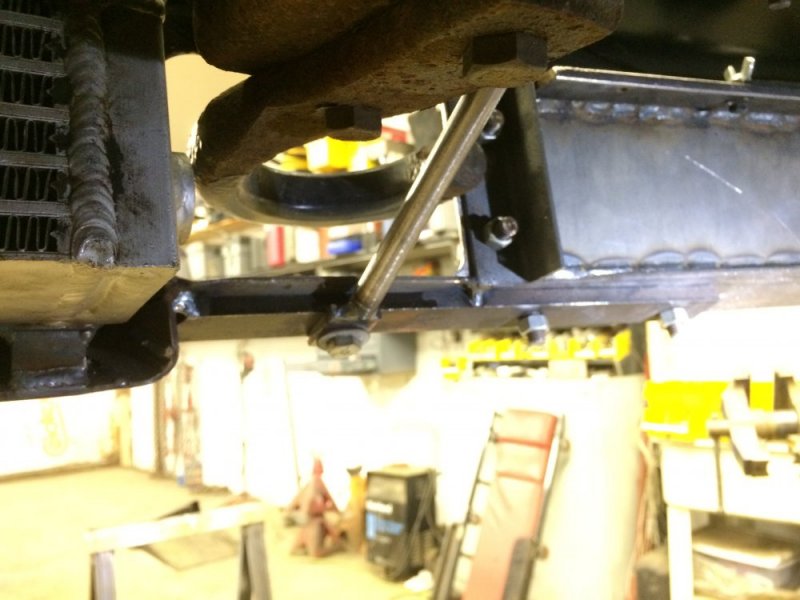

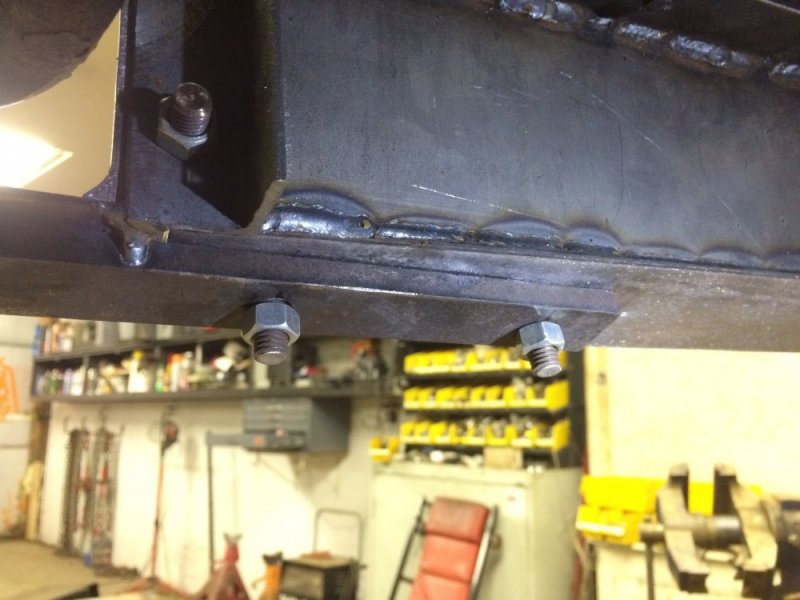

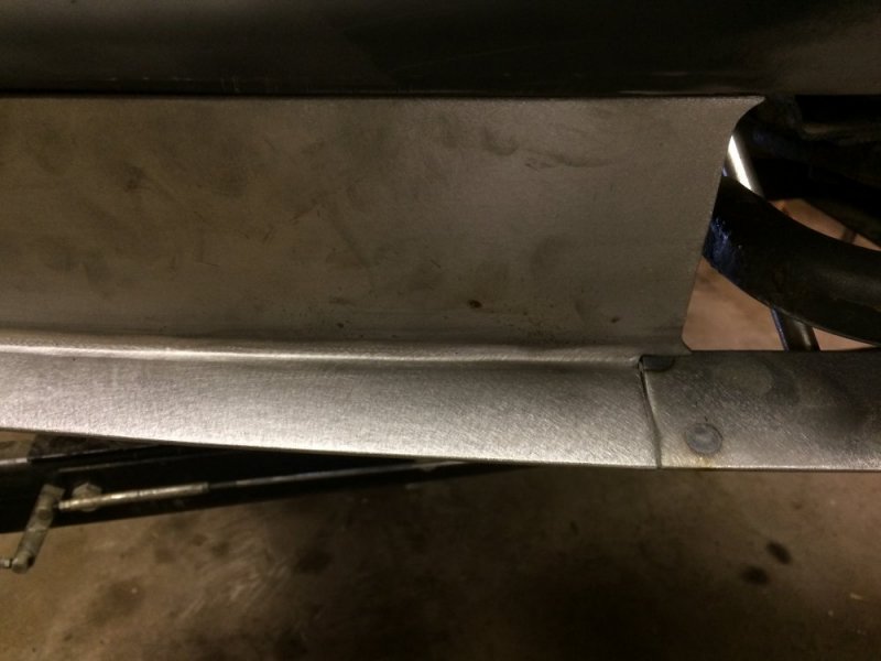

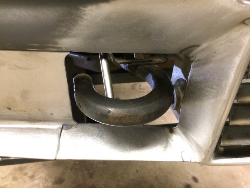

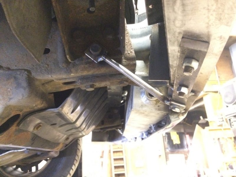

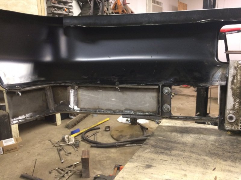

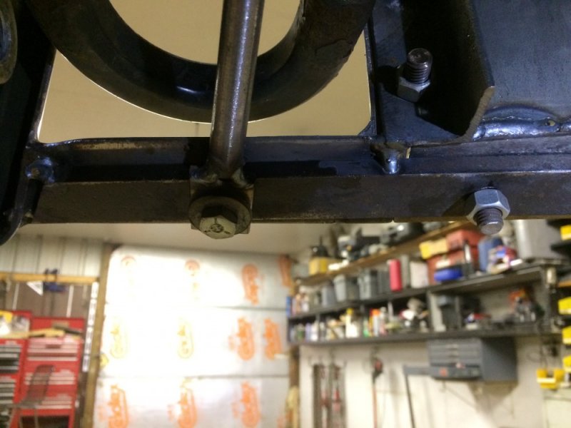

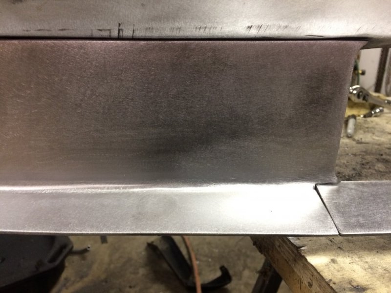

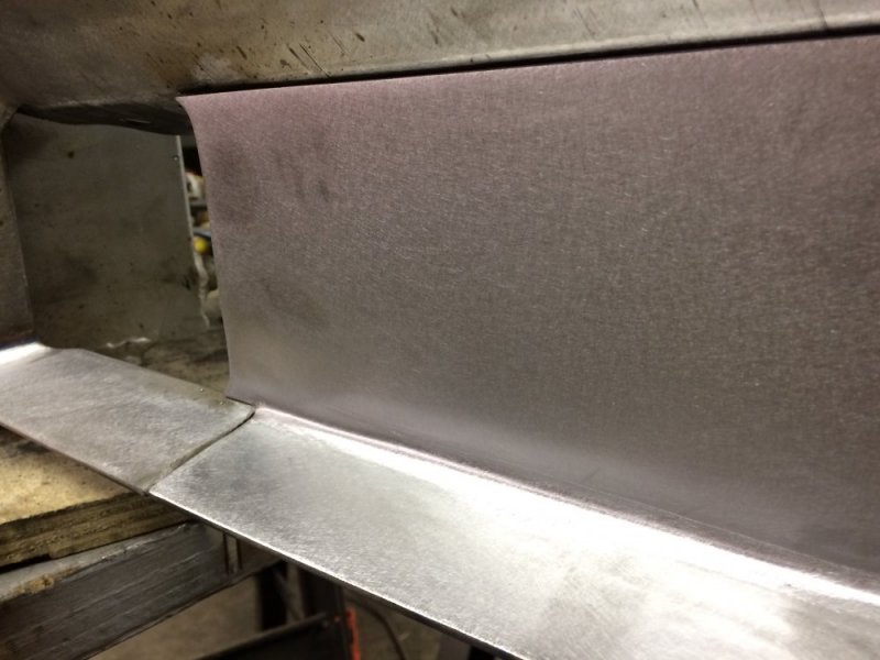

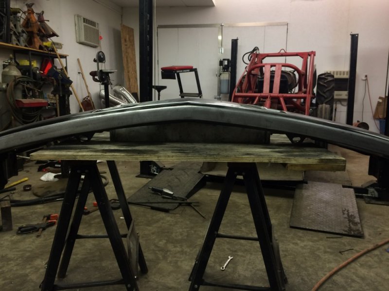

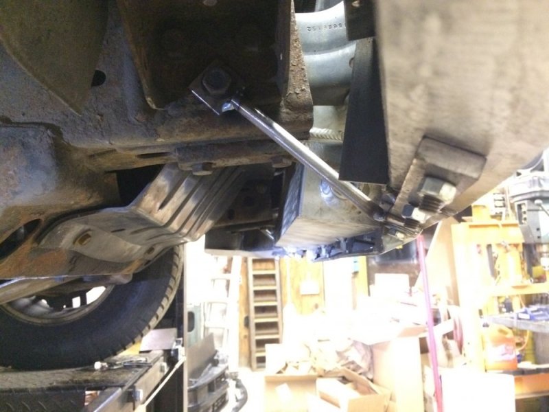

Braces are made. I made the studs a little long on purpose so there will be enough thread for a washer and a nylock nut. Now it's time to remove the bumper and weld the pieces out. I think that is finally it for fab work. Time to finish things. IMG_8007.JPGIMG_8008.JPGIMG_8009.JPGIMG_8010.JPGIMG_8011.JPGIMG_8012.JPGIMG_8013.JPG

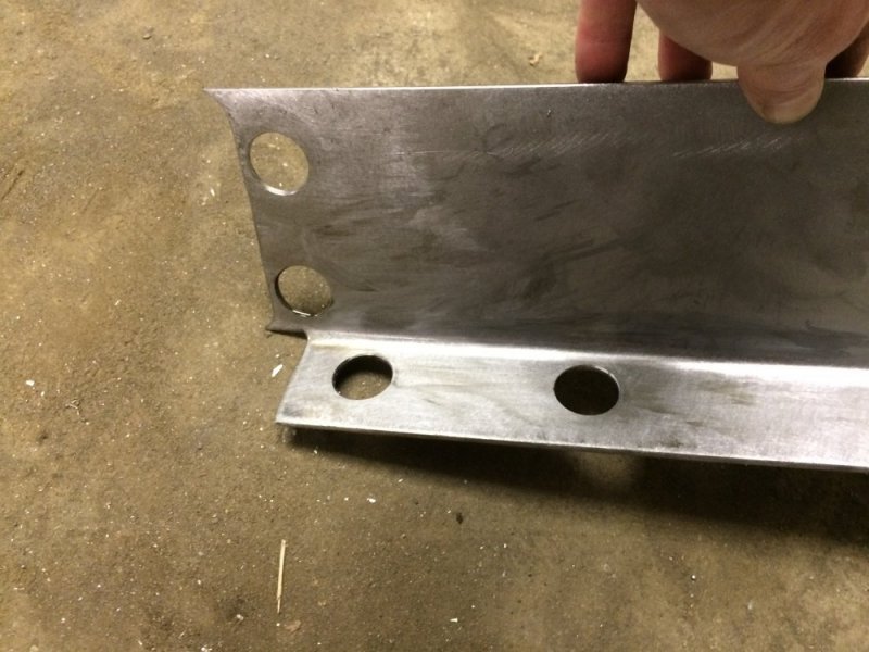

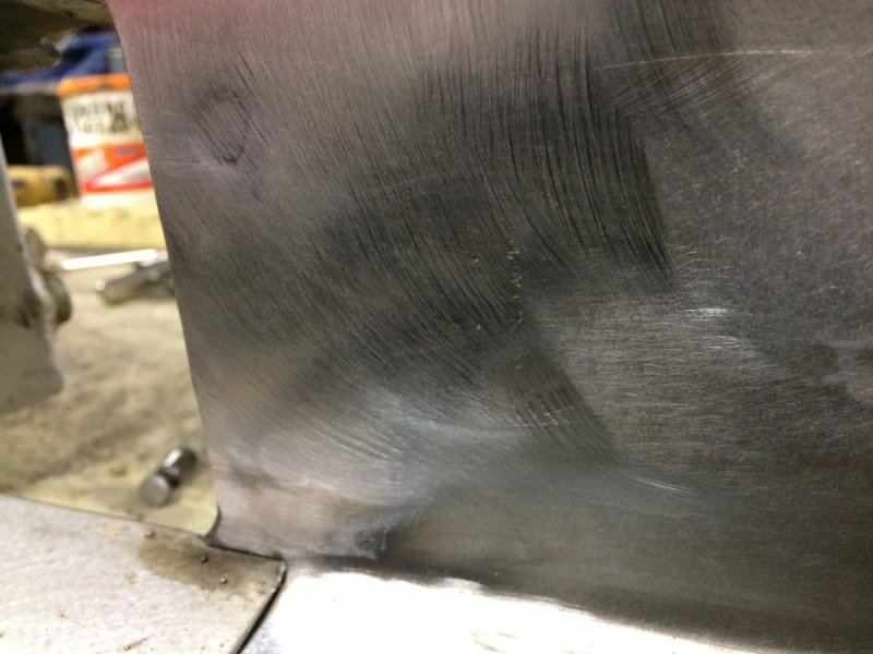

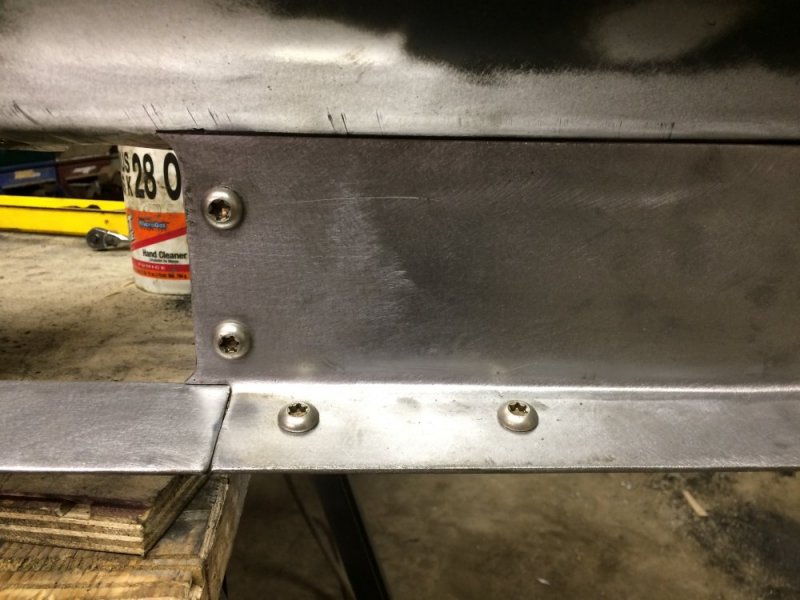

Well I thought I was done. Took pictures and everything. Then I noticed a little dimple in one of the deflector pieces where the welded stud is. So I looked closer and saw a couple more dimples. So I cranked on the nuts and sure enough I was able to get them to pull through. GRRRR. So I pulled them all out. I tried chamfering the holes and grinding the studs to a point. Nope, that's failing too. So now I'm unsure what I'll do....just do some nice stainless button head bolts? Not sure, but it's hard to think after working on it for 6 hours and now being frustrated. So I'll have to let it sink in overnight......IMG_8017.JPG

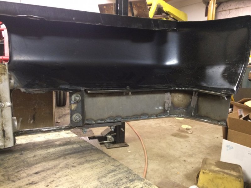

Ok I found a solution. If I had executed it properly it would have been a fantastic solution, but I struggled a little and had to do some rework.....but in the end it turned out ok.

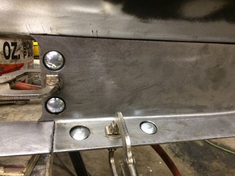

First thing I did was drill out the holes to 15/16". And no....that didn't freak me out one bit :wideyed:.
Then I installed carriage bolts in the bumper braces. After that I installed the deflector over the bolts.

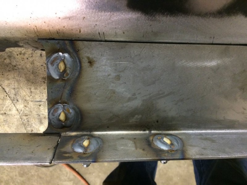

Next was welding. I was able to lay some nice beads since I had so much real estate to work with.
Then I ground the welds and bolt heads down.

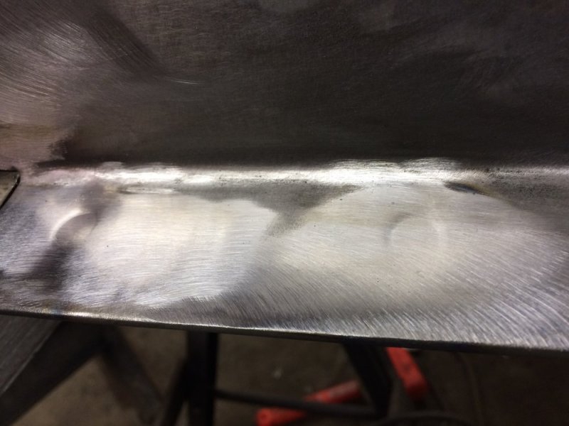

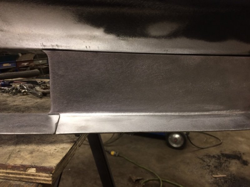

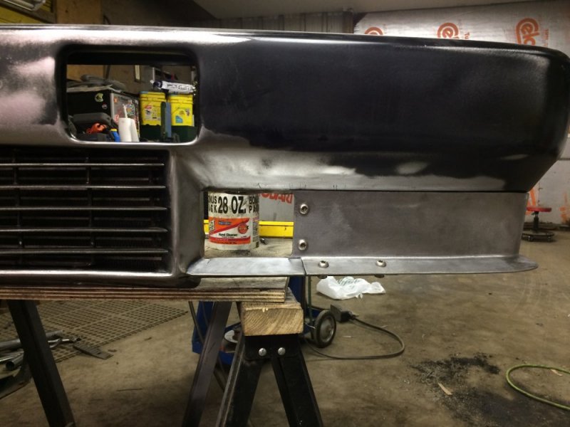

After that I reinstalled the deflector. This is when I found out that I had screwed up earlier. I got dimples again!!! But I couldn't pull the bolts through like before...which made sense. What I did wrong is I had only finger tightened the nuts before, not wrench tightened. So when I reinstalled the deflector and tightened the nuts with a wrench it drew the bolts in a smidge and voila....dimples!

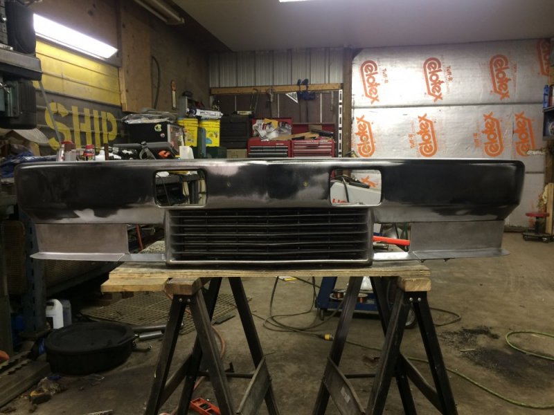

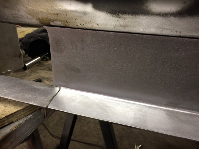

So I ground the deflector down to the height of the dimples and DAd it and now all is well. It can use a little more sanding, but I wanted to get it reinstalled to make sure it was ok before I took it to the nth degree.
So now I just have to do the same thing to te other deflector, sans screw-up of course. :eggface:

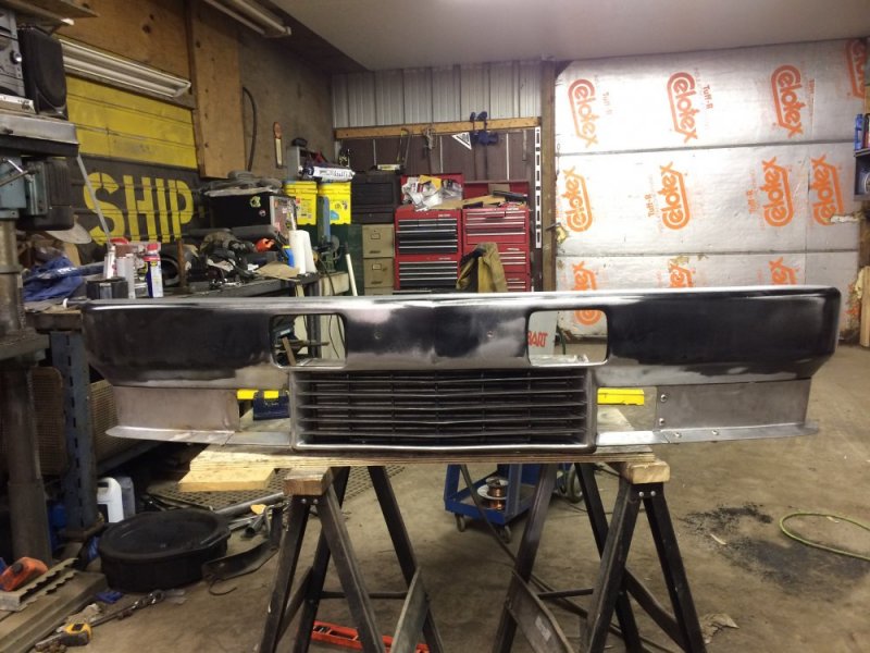

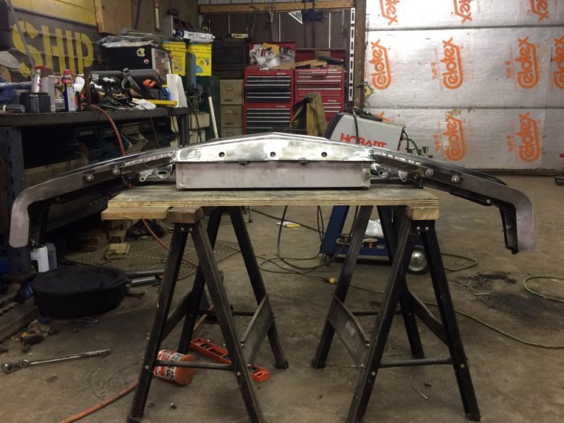

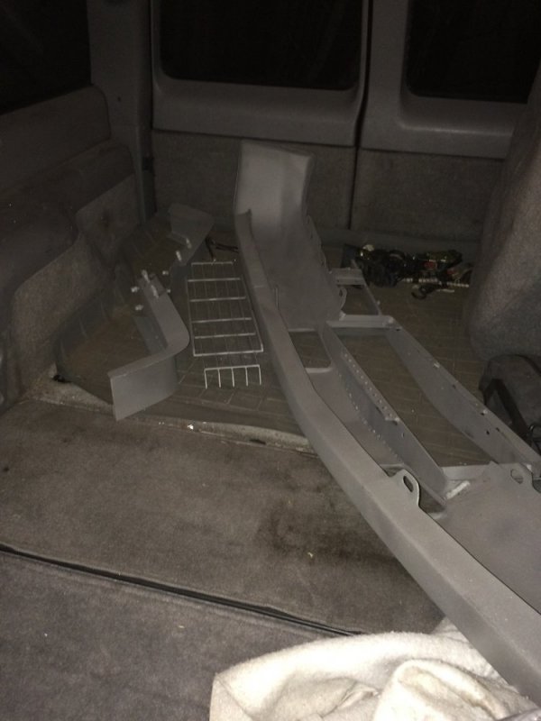

As I had hoped, fully tightening the bolts before welding worked - no dimples! So I ground and sanded the deflectors and then gave everything a once-over. Now it's disassembled and off to the sandblaster tomorrow. IMG_8034.JPGIMG_8035.JPGIMG_8036.JPGIMG_8037.JPGIMG_8038.JPGIMG_8039.JPGIMG_8040.JPGIMG_8041.JPGIMG_8042.JPG

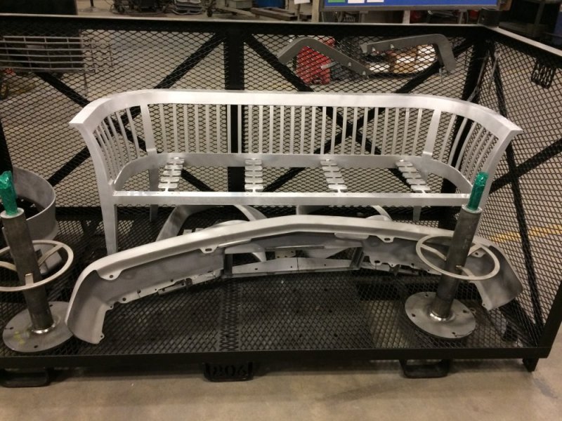

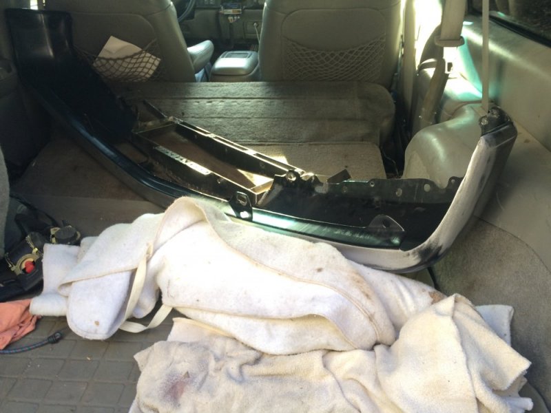

Got the parts back from te blaster today. Tomorrow they will be put in a basket at work to be sent out for e-coat. IMG_8103.JPG
