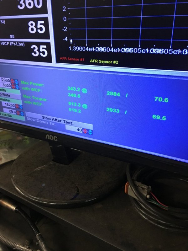

I really want to put a larger turbine housing on this because my suspicion (without any proof yet) is that it is becoming a restriction. So I would like to have more air with less pressure. To make that work realistically though I would want to run a QSV or something else so it wouldn't be a laggy, smoky pig around town. So I know I'd have to change a few things to make 1 thing work....which is fine, I'm just not ready for that at this moment. Sounds like future dyno trips though! Hopefully soon I can put some additional pressure gauges in the system (in the manifold pre-turbine, beginning of the downpipe, end of the downpipe) so I can start finding my restrictions and address them systematically. I just need more time and money, no big deal.
