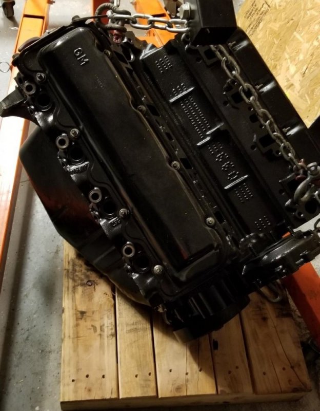

So finally "took" time to work on Patch. I got my hands full with other things...
Anyway after talking with some people and plastigauge of the main bearings: I am comfortable with where they are at.

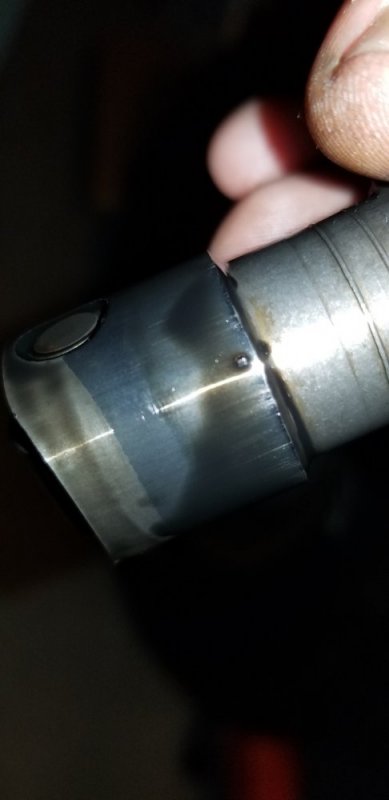

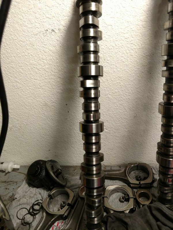

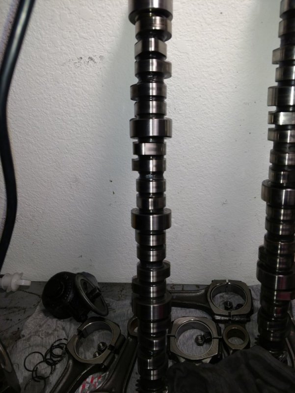

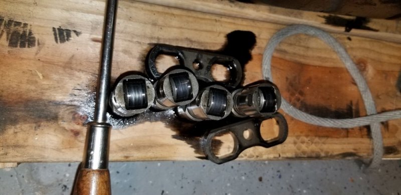

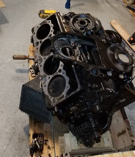

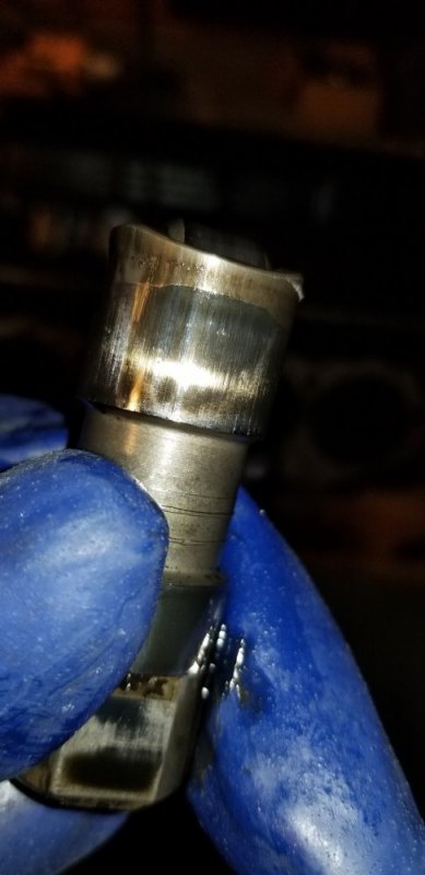

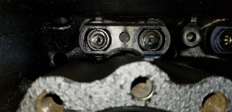

So I went ahead and pulled the lifters in order and labeled in a box. I also pulled the fuel pump rod. The I pulled the cam. I hate pulling 6.2 cams. I need to make sure the dirt seen in the main and rod bearings didn't hurt the cam or cam bearings. Honestly I'd rather just not know that:

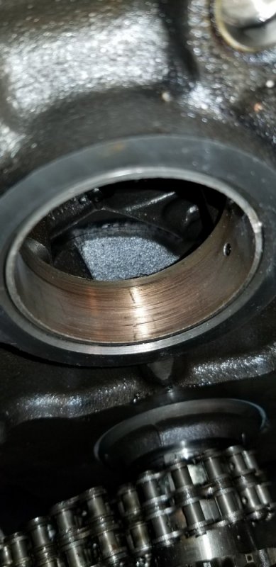

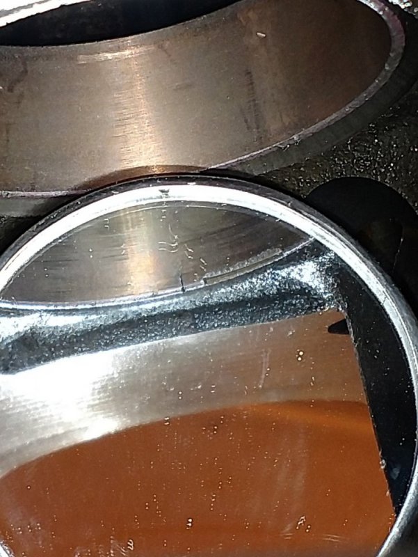

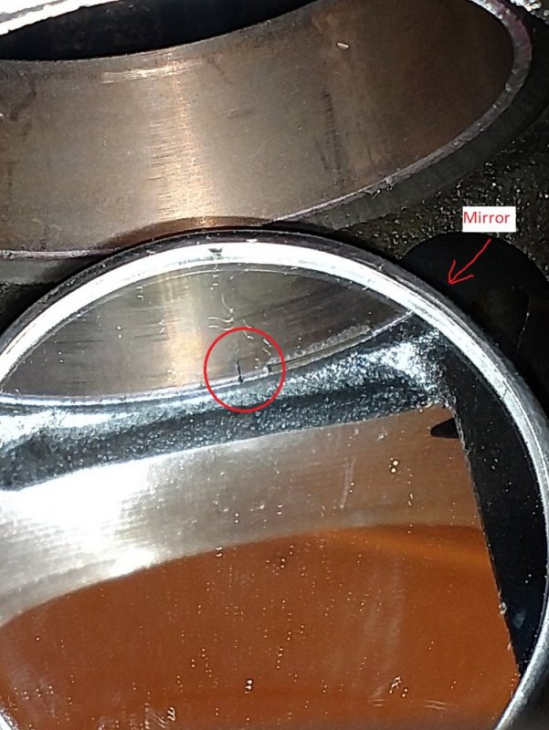

It. Needs. Cam. Bearings. At least one anyway. #2 cracked bearing shown in a mirror.
It's clear the dirt didn't enter the cam bearings. From crank maybe. Or luck and still from oil pump.

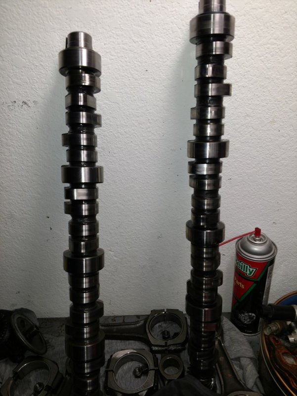

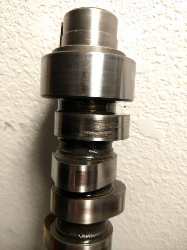

The cam itself isn't in that bad of shape. The fuel pump lobe is trash, but, not a show stopper.
@Will L. HAHAHA Yes, I am already running an electric fuel pump. I likely have to upgrade the Walbro for the Moose Jr.
Old trashed lobes cam on the right and only there to show camera differences that may show wear or overheating of the wear surfaces.
Flash on:
See the bearing wear on the right? Aka trashed cam from the blown up engine.
Might as well take the block and have the shop hot tank it and replace the plugs and clean all the oil galleys..
Yeah, Cam bearings are beyond my limitations for tools and know-how. So to the machine shop for clean out and cam bearings.
