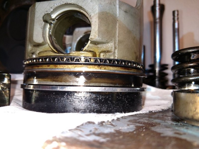

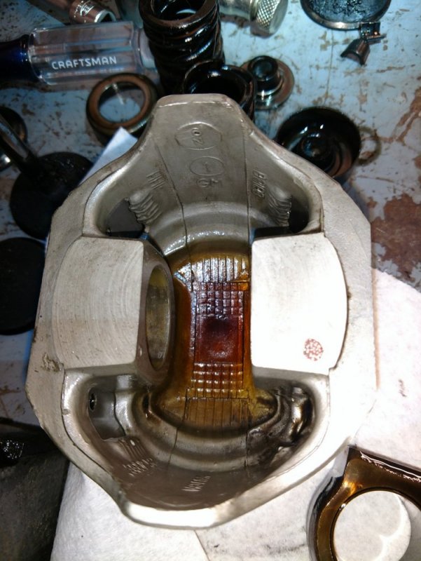

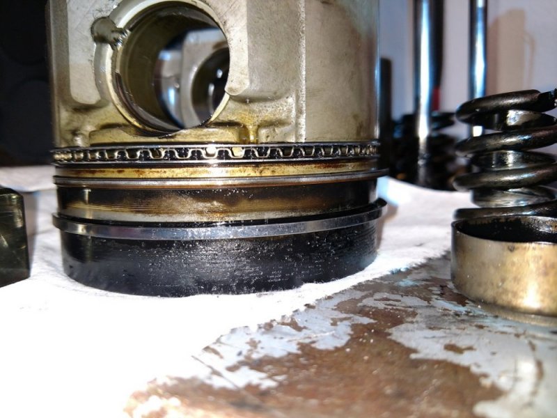

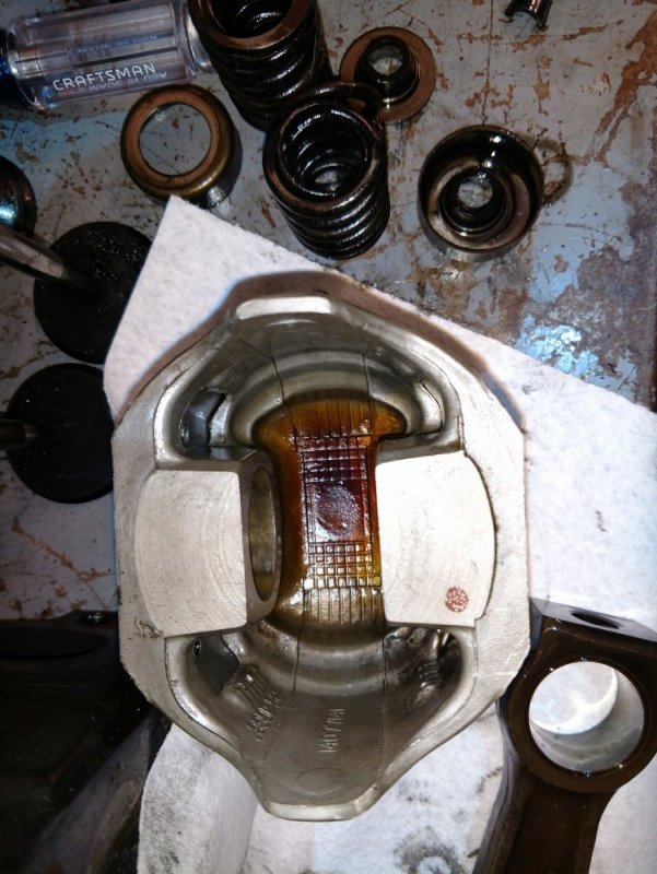

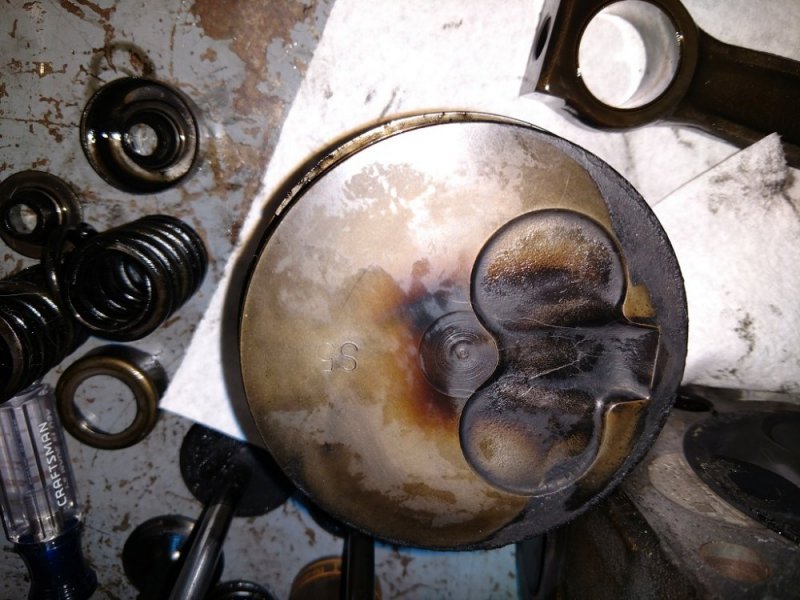

Shots of the piston. Rings were free on the piston and gaps were still 180 degrees off like I set them.
Note the wear on the inner spring from the broken valve spring on the side of the pic.

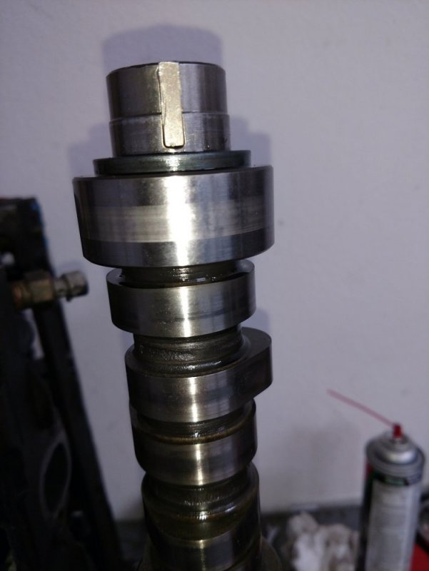

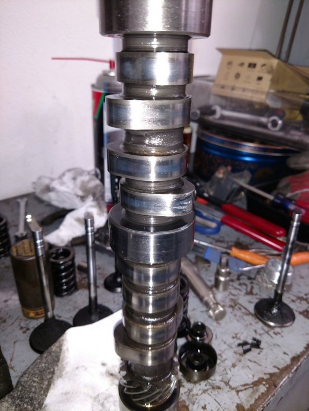

The 6.2 came out of a military rig, was rebuilt, and continued to be used in the military. The rig it was in got sent to the range as target practice. The rig I put this 6.2 in got more Elk than most hunter's guns that same month. 2 trucks made 1 and this engine wound up in it after a uh... a time out. It ate a worm clamp, piston set, and a set of heads. Out and back in. Now this: just…won’t…die. Seriously the all-out effort shown above is conclusive evidence. We have tried everything and can say over-advancing the timing is the closest we have come along with over-speed. (It needed the over-advance to run on low compression.)
So I had a long chat with @Twisted Steel Performance . Literally got a dose of my own medicine about rings. I tell people to do rings all the time due to overheating and blowby. Because *No Budget* here and having zero blowby I was figuring on reusing them. We have overlooked how hot the rings must have been on the "well done" pistons, OOPS! Chris was like 'use the coating money for rings and run uncoated pistons.' In context of a retired rig and worn engine. This is a in town runabout and towing on "The Real Highway IN Hell" is no longer in it's future like it was in the past. Chris pointed out the luck I had: Camshaft failures are worse than crankshaft failures. I am lucky the engine didn't simply go "BOOM!" at high RPM during the said snap test. With the ATT and Moose Jr. the top coating can do some good. Lower compression is said to be better.
Bottom line is pistons are on the way to get coated.
(I will also be running thicker head gaskets to cheaply lower compression.)
My next call was to Total Seal Piston Rings. I told them what was going on with this engine and the results of how clean the Gapless were keeping the engine oil. Total Seal agreed that I should use new rings.

Looking at the valves I see where they are contacting 3/4 of the face and then have carbon spots on the rest indicating slight bend. Just enough to loose compression. I am not going to bother the *experts* head shop with these valves but will be using new valves and springs.

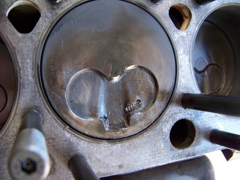

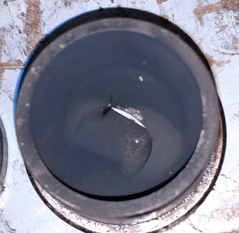

Not only do I have the standard precup cracks: one is burning through. Didn't see this till I knocked them out to prep the heads to be rebuilt. This is a 6.5 NA precup.
To those that are following this, this is what happens when a bigger turbo, more fuel, small cups, high compression etc is done without the supporting mods.

I wanted to expand on an observation as to the limits of these engines: EGT related to timing. Looking through the carnage here one could question me saying high EGT alone won't kill a 6.2 6.5 engine even with uncoated pistons. Yet I have torn this engine down three times and the first two times there wasn't this kind of damage. High EGT means you have a rich mixture and may not have enough air for the fuel. In context of this engine it isn't something you need to get heartburn over and drive with one eye on the EGT gauge like other engines. No, that eye had better be on the ECT gauge!

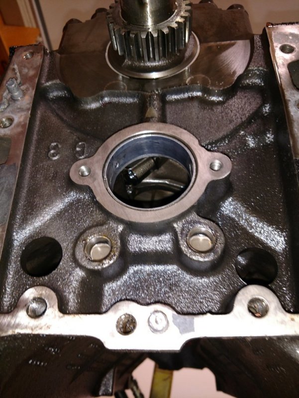

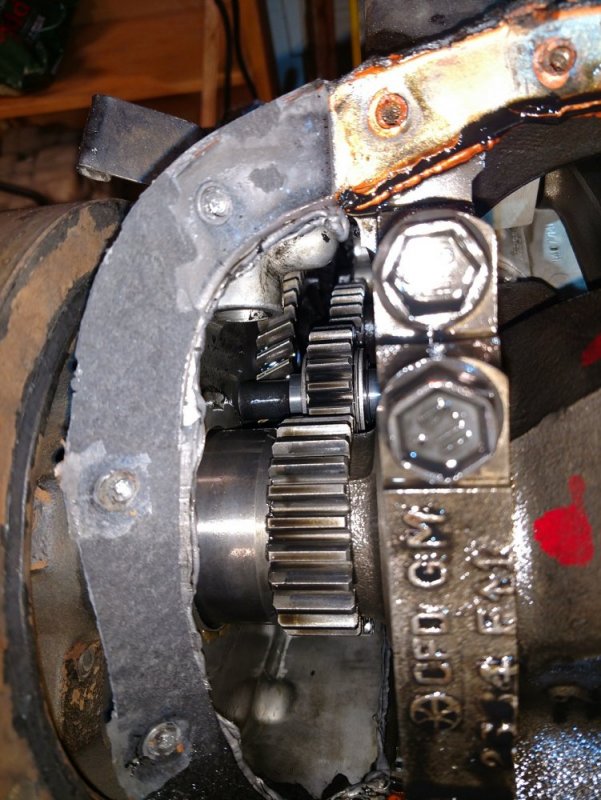

You see with Gapless rings the old trick of turning the engine over and letting the soot show the mains cracks doesn't work very well, because, Um... just not enough black in the oil to make the cracks show up. Yes, having a very hard time seeing the old cracks.
So looking at the mains, last time, 2 of the 5 main webs had cracks. This time on final inspection I found a "new" crack on the #2 main. So this is #2, #3, #4 mains all have cracks with the #4 being the worst cracked on both sides on the outer main bolt clear to the relief cut in for the cylinder. :eek: These are the ones I can see without any crack detection tools.

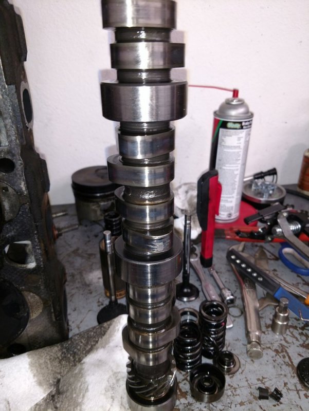

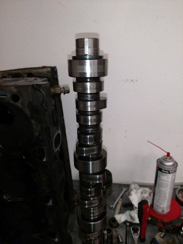

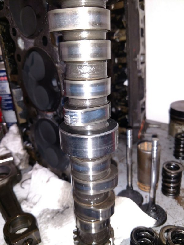

IF and only IF I was rerunning the old rings etc. it would still be a very bad gamble to find out when it's going to let go. Further with the new parts coming it wouldn't do the said vendors any justice to run this. Combined with needing a different cam and, oh yeah, that bad cam scratched each and every bearing on the way out due to having a sharp raised ridge on the side. No Thanks on the "Procedure to remove 6.2 crankshaft": Remove mains bolts from #1 and # 5 mains and then lift out crankshaft in (x) number of pieces.

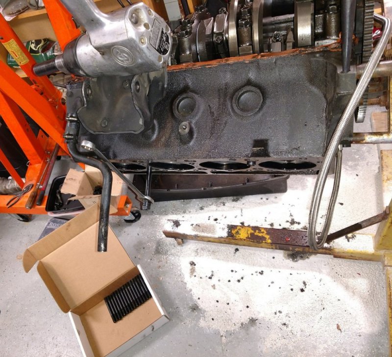

Are the Red threadlocker head studs going to come out of the block peacefully or are we going to war? Snap the studs off, break the block, or come on out? Directions are like heat the red threadlocker area up to 550F degrees Blah, Blah, Blah. For the $200 in studs I am not going to work around something that hot. So double up the nuts and see if the will come out with hand tools, an impact, or a big impact.
I have worried about this very day for years by saying this block is going to the scrap yard with the red threadlocker studs in it. I have enjoyed zero leaks from the studs with the heads off 3 times. I don't have so much as a rusty thread on the studs.
They waved the white flag and although stiff all the way out: came out with a long ratchet. This side anyway.
