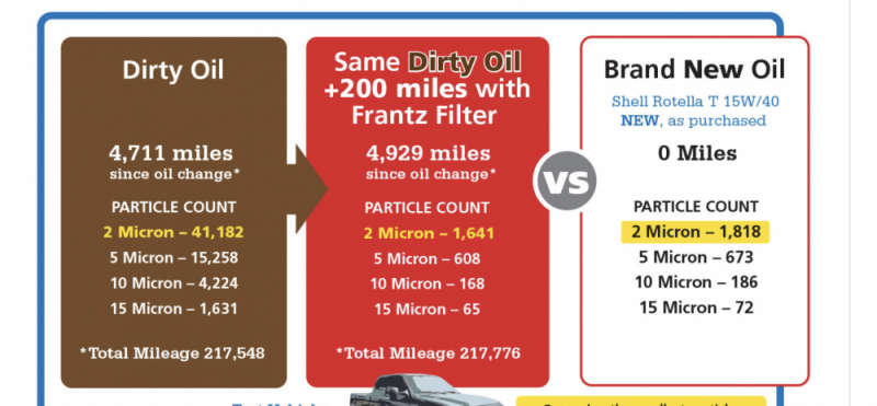

The frantz outfit came out with their own media- so you don’t have to wonder how good is chramin vs angel soft; also so you don’t worry if it will break off and contaminate.
frantz goes to 2 micron with their media tested third party by blackstone labs. This is cleaner than new oil (see pic from their website).
the fs2500 goes to 3 micron.
On carbon- carbon can be counted dry at 0.1 micron. But wet (like in oil) 0.25 is the smallest it gets too really. When dealing with 1 micron and under the structure of the carbon becomes more critical than the size as far a ls lab folks care. The claim for absolute 3 micron - I would REAAALLY have to see the sheets on that to believe it because it isn’t like this is gasoline or diesel fuel. Being able to filter 100% of 3 microns means it should pull a ridiculous amount of the 2 and 1 microns out also. So if it doing it- you hey really need to show documentation on their site.
At those levels- look for the lower price- that extra drop from 3 to 2 helps but isn’t all carbon, so don’t panic on the difference. Idk about the 2500 but the Frantz in made in USA. I always prefer USA made, but am quite happy with Canada or Mexico made.
