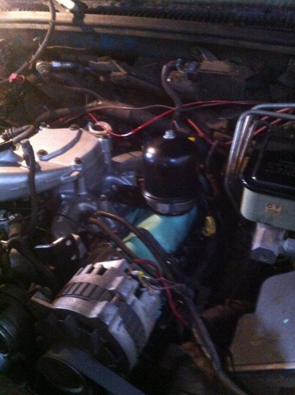

@Will L. I just found this on youtube that Leroy posted years ago. I like how it's designed, but this would require a person to install a right side valve cover on the left side. would you know of other options out there where the valve cover swap wouldn't be needed?
to use it like that, it just dumps back into the valve cover and runs while you drive it. You could get it and diy a drain back to the engine however you want- Leroy just had a good set up for using it that way.
I did that a several years ago, it works well. There is a fair bit of sludge in the centrifuge

All I know Will is I get a lot of sludge in the centrifuge, so it does help.
This truck gets about an hr. of run time each day, 30 mph max feeding cows. The centrifuge would likely work a lot better on a long run.
